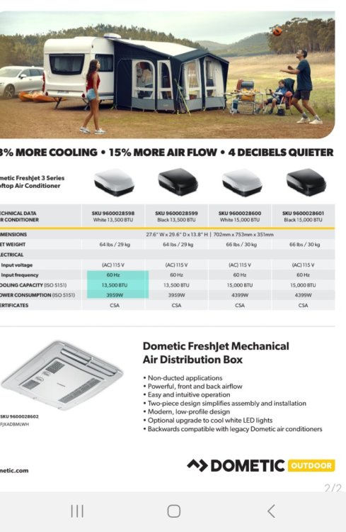

Is it really almost 4000 watts to run it? Or is there some iso formula I don't know?
They claim an eer of 8.2, so that would be more like 1650 watts running at 95 degrees? Which would be awesome.
That must be the max inrush current.  Key questions I would require answers for if I were interested are:
  • What 120V breaker does it require?
  • What size electrical service wire does it require?
  • Will a 2,000 watt Honda EU 2000i generator reliably start and run the unit with or without EZ Start?
If the answers are:
  • Greater than 20 amp
  • #12 AWG
  • No
It would for sure be a deal breaker.
GJ
