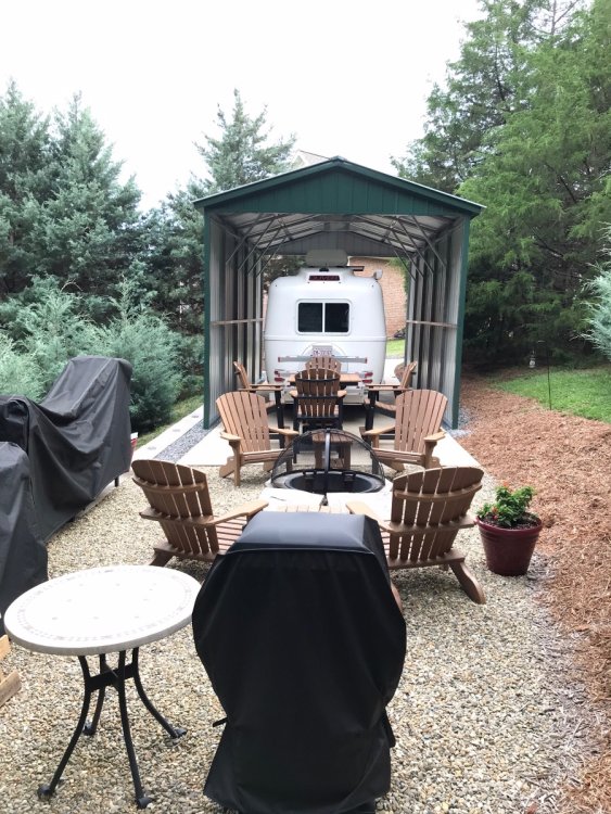

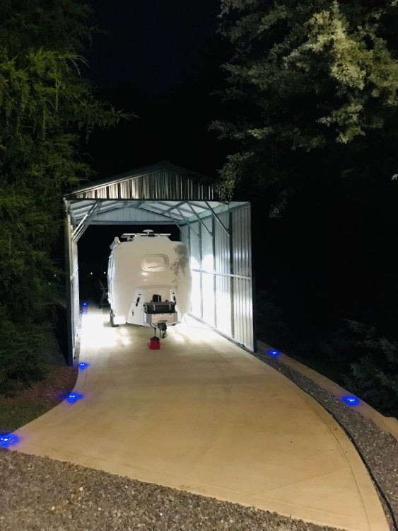

Welcome to the forum! We park our Ollie here at our home. I had a 13X55’ slab poured and then had a metal building constructed to keep our Ollie out of the weather especially the sun. We also keep our Ollie plugged in to a 30amp outlet. I also bird proofed our “Ollie Hangar” to keep the birds from nesting and/or perching and crapping all over the roof of the Oliver. We are a year in and no birds nesting, perching or crapping on our Ollie. I blocked off every area or ledge  they could perch or nest on with 2” thick hard insulation foam.
My suggestion: add a 4-5” nice level gravel base or crusher run where you plan on parking under that pole barn. Figure out a way to bird proof it as much as possible. Birds will make a real mess on your gelcoat over time. Run a 30 amp power cord and a water line or hose if you can. Figure out how to keep the sun off of it while parked. The suns UV can be pretty rough on gel coat.
We got a little creative and made a place where we can enjoy a campfire, tell a few tales,
and even a few true camping stories. 😎
This works well for us and our Ollie is well protected from the elements.
It’s especially nice when I wash the Ollie as it’s always in the shade.
Welcome and I hope this helps!

Looks like a nice set-up you have there, @Patriot...
Nice place for telling "Fairy Tales" and "Sea Stories"  (You know what the difference between the two are, right?)

Yes VERY impressive set-up you have there @Patriot Wow, my 2 month old Ollie will be parked out in the elements when stored and camping, from the above suggestions sounds like I'll have to sell it! 😜

Thanks we really like parking our Ollie under cover at home vs paying for a storage lot. It’s  been a work in progress for sure.
Since you don’t keep your Ollie under cover just be ready to address or stay ahead of the slow creep of your gel coat beginning to oxidize a chaulky white on the roof top and corners.  Then there is the degradation of all your caulking from UV.  Fun times!

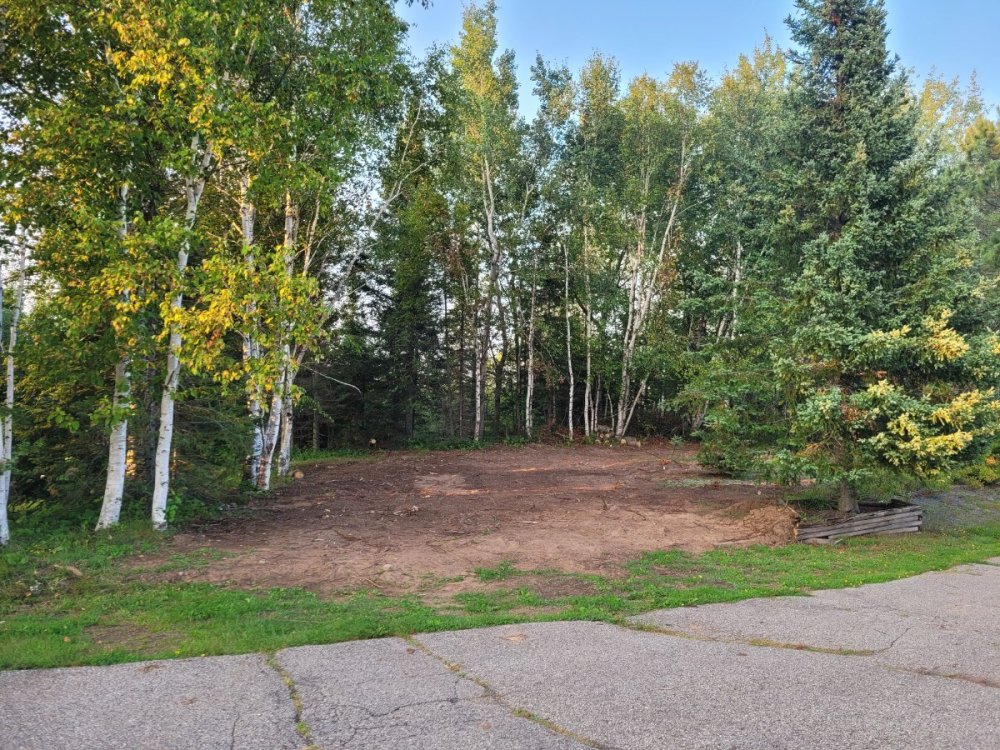

Welcome @SYoung.  We poured a 12x24 concrete pad for our Ollie prior to bringing her home and our plan was to do the same as @SeaDawg and keep her in the elements and apply marine grade wax on a regular basis.  But the pollen and tree debris/sap proved too much this past Spring, so we now use a Calmark cover.  We had also planned to run an electrical line, but decided instead to take advantage of the Ollie's Zamp port and keep her batteries topped off using an inexpensive 100W solar panel.  It's a suitecase style, so we could bring it along for extra capacity when boondocking.  Adapt and overcome 🙂
@Patriot, very nice setup.  Are you accepting reservations 🙂
