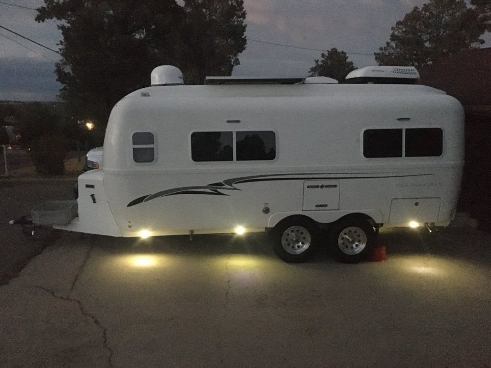

Here's our #113, parked level in our driveway. The front jack must be lowered, and lowered again, until it's less than 4" off the ground! Exterior Courtesy Lights running 24x7 to fend of the Arizona Pack Rats! We love living in the mountains. Was brought up as flatlanders, you can keep suburbia, worth the effort to escape, for us never again living flat and humid!
BTW, don't jack up the rear, behind the rear stabilizer jack, for maintenance of the wheel bearings, brakes or ANYTHING else, without first having your OTT level! Working maintenance, I will always be careful as wrtned.
However, it totally s@cks that we have to level like this to merely fill a FRESH WATER TANK!!! (or run the fridge, OMG!) Hello OTT, you can install a flat FWT designed with interior baffles, so that it can be filled to 90% capacity at ANY level! Yes, can be done! Ty
