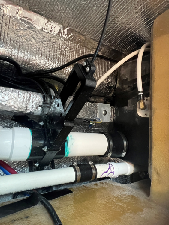

My simple question is what does this valve do. It was closed, and i opened it tonight as i'm draining all the water from the system. Tomorrow i'm going to blow out the lines w/ gentle pressure (10 to 15 PSI) and then put in the pink stuff.  Apologies if this is the wrong place to put this, i've been off the forum for a couple years.   All info is appreciated.

That's your black tank flush port valve that you now have in the open position. Here's the Winterization & Storage Tips from Oliver, just curious why would you want to blow out the lines if you're going to use the pink stuff anyway?

just blowing out the lines to catch any little plastic shards that have been clogging my filter on my old Shurflo water pump, and probably stressing it a bit.  That's all. I've never used the black tank flush port..is that on the outside of the tank?  i'll have to look. I always flush my black tank out w/ a ton of water everytime i camp, but i'll have to check that out. Thank you rich.dev.
The black tank flush port "should' be on the curb side behind the axles. Check this video on how to winterize it, and this video explains your black tank flush port.

The outside Black Tank fill connection is down low on the street side, between the bathroom and dinette window on my 2017 LE2.  Which puts it in front of the axles.

Oh yes @mossemi you are right. Also @Vector - Lanham, it’s on the street side not curb side like I said! Damn I had to really think about that now!😜

Does your 2023 have the black tank flush valve as our older Ollies have?

I do not have the black tank valve in my 2020, I believe it was discontinued by Oliver it in in 2020.

Nope not on mine
Like @Patriot said, on the newer models we need 4-5 pumps to sufficiently protect the new flush port system. I remember reading somewhere this change was put in place to meet new codes for the black tank system, something to do with ensuring no backflow of waste water can get inside the water supply line. Here's a pic of the new layout with longer flush system.
