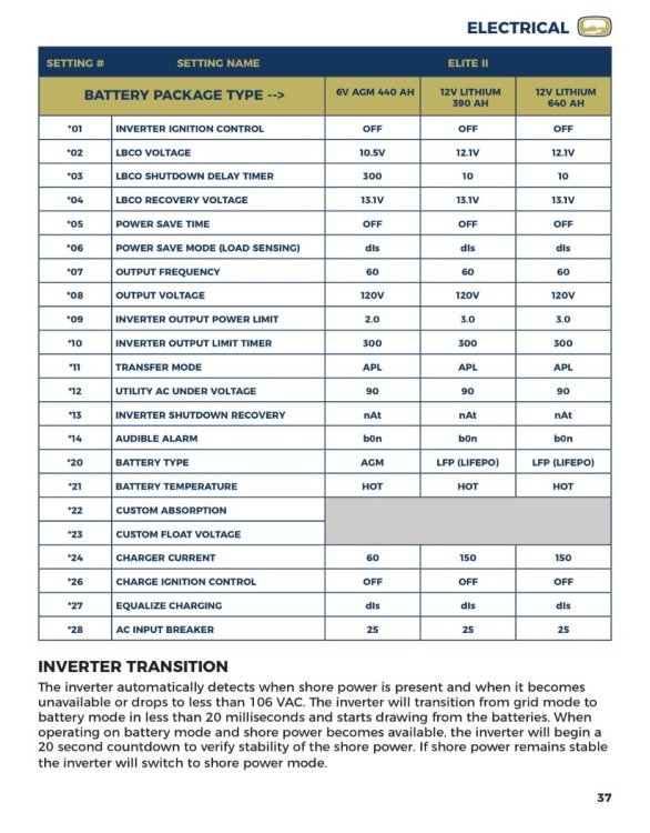

@rich.dev, thanks for the suggestion.  I was aware of the need to change parameter 28 to match the circuit capacity.  I have set it to 15 amps, after having used it successfully set to 20 amps, using the same extension cord and outlet.  The surge suppressor display in the attic reports 120V, ~1amp, 60 Hz.

One other thing you might try is to charge the batteries slower. Setting 24 allows you to change the charger current. By default it is set to 150A. When I had poor 30A shore power at a campsite (low voltage), I changed this value to 25A, and it allowed the AC to operate for a while before the input voltage level fell to the point where the EMS rejected the input power source. Ultimately we wound up changing campsites.
The setting can be adjusted in 5A increments between 5A and 150A.
@MobileJoy, I had overlooked setting 24, assuming that reducing the value for setting 28 (input breaker size) would result in lower charging current.  Now that you have pointed this out, I will reduce the charging current to 15 or 20 amps.  The symptoms I have observed lead me to suspect the inverter is trying to charge the depleted batteries at 150 amps, which is obviously not sustainable.  Thanks very much pointing this out.

There appears to be some confusion around setting number 28 which is a dedicated internal circuit breaker for the 3000 watt inverter.  The factory setting must stay at 25 amps because it requires at least 20 amps of 120 volt input current to charge the batteries at the factory default 150 amp charging rate.  Stated differently and ignoring losses, the inverter requires a minimum of 2,100 watts of 120 volt shore power to achieve the 150 amp charging rates (150 amps x 14 volts = 2,100 watts).  2,100 watts of 120 volt power results in a shore power draw of 17.5 amps (2100 watts / 120 volts = 17.5 amps).  If setting #28 is set to only 15 amps, I believe that it is guaranteed the inverter will shut down and not charge the batteries.  Once the battery charging stops, the inverter will after awhile reset, restore shore power and start charging the batteries again.  The inverter starts charging the batteries at a low rate initially and slowly ramps up the charging voltage until it reaches a steady state 150 amp charging rates.  If setting #28 remains at 15 amps, then it will never reach 150 amps charge rate because shore power will shut down again and the cycle will repeat itself over and over. OTT should verify the above, but I don't believe there is ever a reason to reduce the AC input limit in the inverter/charger to below 25 amps.
Rivernerd's advice to use an extension cord with a higher amperage rating is excellent advice in all situations.  The reason is to reduce voltage drop.  The footnote to the table above that rich.dev posted states that the inverter will trip shore power and switch to battery power if the shore power voltage drops below 106 volts.  An undersized extension cord can cause significant voltage drop.  For example, assume the voltage into the house from the utility is 118 volts.  Further assume that there is an unusually long 75 foot run of 12 AWG romex from the breaker box in the house to the wall outlet feeding the extension cord to the trailer.  In this example, the voltage at the wall outlet has already dropped by 6 volts to only 111.96 volts, merely due to the 75 foot run from the breaker box to the wall outlet, assuming a 20 amp current draw at the outlet.

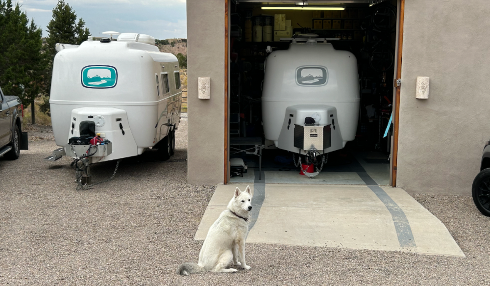

Same here!  30A all WX outlet installed outside the Man Cave for travel prep, maintenance, and the occasional visitor (eh, @Geronimo John?)
I don't think this is correct. Setting #28 limits the maximum draw of the converter section to X amps, with preference going to any internal 120v loads before the balance goes to the converter for battery charging. For instance, if it's set to 15A, and you have 5A of internal loads (TV, cell chargers, etc.), 10A will be used to charge the batteries. They'll still charge, but slower. I've done this many times when connected to a small generator or to a 15A circuit.
I see two OTTs, but only one dog, so ruling out double vision. Nice setup!
2020 OLEll, Twin, 579:
I  have been dying to ask:  "Why two Olivers?"

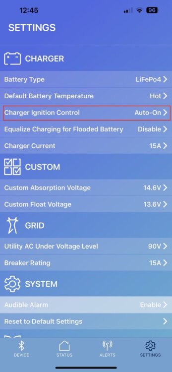

@Rivernerd, @Chukarhunter, @Steph and Dud B, @MobileJoy, @aaronorange, @John Dorrer
My issue has been resolved.  The Xantrex Inverter/Charger is now charging my Lithionics batteries.  As promised, following are the details leading to resolution of the problem.
After logging a service ticket (including thorough details) with Oliver on Sunday, 11/12/23, I continued to read the Xantrex owner's manual and search the internet for clues to resolve the "AC bypass" preventing charging of the batteries.  This effort was largely unsuccessful.
On Monday morning, 11/13/23, I phoned Oracle Service to inquire if they could provide guidance to resolve the problem.  In short, they could not.  I was told since this was an AC problem, Oliver could not help resolve the problem.  They recommended taking the trailer to a service center.  In the course of the discussion, I was also provided erroneous information, such as the as the state of the ON/OFF switches on the Lithionic batteries.  I was told the batteries are fully charged if the switch button is lighted a steady blue color.  This is incorrect.  The owner's manual from Lithionics clearly states a steady blue light indicates only that the battery is ON.  I knew from using the Lithionics app on my phone exactly what the charge state was- between 10% and 12%.
Oliver Service did forward my service request to Xantrex and I received an email from Xantrex which included a case number in their service request tracking system.  In the automated email were instructions for submitting additional information.  Using the Xantrex FXC Control app on my phone I made three screenshots of the current settings on the Xantrex inverter/charger, plus serial number, purchase date, etc. Below is one of the screenshots.
Oliver Service also provided a phone number to Xantrex customer/technical support, ‭(800) 670-0707‬.  I placed a call to Xantrex, only to receive a recorded message stating they were closed for a Canadian holiday.  Today, I finally reached Shawn, a Xantrex tech support agent, after about a 25 minute wait in a phone queue.  I provided the case number and Shawn spotted the screenshots and quickly reviewed the settings.  Shawn told me he was almost certain my issue was caused by the setting of Charger Ignition Control being Auto-ON.
While still on the phone with Shawn, I went to the trailer, opened the Xantrex FXC Control app and changed the setting of Charger Ignition Control to OFF.  The Xantrex Inverter/Charger immediately came on and began to charge the batteries.  Neither Shawn nor I can explain how this setting got changed from the default Oliver setting of OFF.  In the two hours since changing this setting the batteries SOC has increased from about 10% to >40%, while connected to a 20 amp circuit.  In another hour, the batteries are all near 80% SOC.
Lessons learned- I had not checked all of the inverter/charger settings using the Xantrex FXC Control app against the Oliver default settings listed at https://support.olivertraveltrailers.com/portal/en/kb/articles/xantrex-inverter-settings.  Had I done this, I may have resolved the problem sooner.  In my opinion, Oliver Service should have recommended verifying the current settings against the Oliver default setting for the Xantrex Inverter/Charger and our model year trailer.

While I had Shawn on the phone, I asked him why the Xantrex Inverter/Charger would occasionally come ON for brief periods (2-3 minutes)  while attached to shore power. I have noticed this occurring at night, such as when the furnace cycled on.  Shawn said this was not unusual, if a large DC load is activated, such as a bilge pump, or a furnace blower.
I hope this information is useful to other Oliver owners whose trailers are equipped with Xantrex Inverter/Chargers.  My thanks to all who offered suggestions to resolve the problem.
