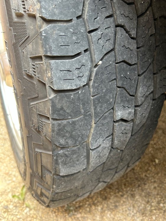

Tire experts….. I was doing some maintenance today before we head to Arizona next week.  I noticed one of my tires had a significant amount of wear while the other three still look new.  It’s the curbside back tire, it looks like it has flat spots all around and the tread is worn down to the wear bars.  The other three show no wear.  Is this a wheel problem, axle problem, or something else?  I’m going to call Discount Tire to order a new one.  Mike
Worn tire, rear curbside.
Street side rear tire.  The two fronts look the same.
Now that I see that the wear appears to be all around the tire, it would likely be alignment.

They were balanced and mounted at Discount Tire in January 2021.  I have 42,044 miles on them (not counting miles in the local area for maintenance and to/from storage).  No rotations or balancing since.  This is not something I’ve noticed before and I do check the tires before/after trips.  Like I said, the other three look new still.  All four old tires these replaced looked new after 5 years.  Maybe I hit a pothole or something recently….
I would carefully measure the axles and wheels to see if the axle has moved or been bent.  If not finding anything, have it aligned.

This would have been my thought - or, possible you took a right turn a bit too tight and hit that tire on a curb.
I'd take a very close look at the sidewall and then take a very close look at the street side tire.  If the street side tire looks good then the issue is - probably - not with the entire axle.  But , it could be just the spindle on that side.  And, this is where GJ's measuring would come into play.
Finally, from your pics it is a bit hard to tell, but, is that abnormal wear actually "cupping" or simply having the tire riding too much on the outside?  If you can't tell then hopefully your guy at Discount tire can make the call.  The reason this is important is that your bearings and/or spindle on that tire could need adjusting or replacement.

The street side tire is fine.  Looks new.  The wear on the tire in question is not even, there are flat spots evenly spaced all around.  I checked with Discount Tire and will have a new one put on next week.  I’m going to get it off the ground tomorrow and check free play and do some measuring.  Monday I’ll give my local repair guy a call to see if he can look at it sometime next week.

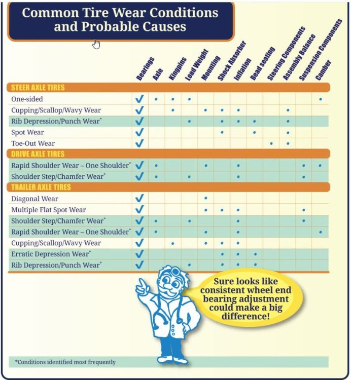

One can fine lots of images for different tire wear patterns online.  I found the attached from a commercial fleet site and while there are no images, the descriptions are good.
Additionally, just to stir the pot 😀I really trust this guy (see video below) who suggests that IF you are not seeing strange wear patterns, rotations are not really needed.   I have been rotating tires for 50 years....but now questioning it a bit.
Edited by Jim and Frances
Source of wear pattern is https://www.doctorpreload.com/2017/01/bearing-adjustment-real-cause-irregular-tire-wear/

An unbalanced tire causes vibration. It would have to be extreme to create this kind of cupping, and less likely than other causes. Checking the balance doesn't matter anymore, since after this cupping it is certainly out of balance.
You must determine cause, though bottom-line Mike, before a major trip you need to but a pair of new tires for that axle. Save the good one in case you do not find cause and have another single tire worn upon your return.
I read some comments here suggesting alignment, but there are no alignment mechanisms in trailers like in an automobile or truck. You cannot adjust camber, caster or toe-in on trailer wheels. Looking at the picture, you can see that the axles are attached and float on the leaf springs, which bolted to the frame at 3 fixed points. The leaf springs generally have a centering hole that would not shift and again, not adjustable. Also, it is highly unlikely that a damaged axle would affect one side and NOT the other!
Likely possibilities: a 1) damaged rim, 2) the bearings or spindle, or perhaps 3) the leaf spring for that wheel. When your trailer is sitting level, before you jack it up, inspect the leaf spring thoroughly and compare its height and shape to the good side. When you get the affected wheel up in the air, check for free play by pushing it in the 3 to 9 o'clock and 6 to 12 positions. Remove the wheel and check the backside of the rim for any cracks or bends. Now look again at the leaf spring thoroughly and check for bangs, bends or cracks.
Lastly, it is most likely the bearings or a worn spindle on which they sit. It appears the cupping is more so on the outer edges of the tire, which again looks like bearings. See what the grease looks like. Clean inner and outer bearings with old fuel or kerosene, blow dry and see if they spin freely and quickly when sitting on a workbench. Check the axle to see if it is out-of-round, has any discoloration, bad spots or anything that does not look like clean hardened factory steel.
Of course, correct anything found to be damaged. If you cannot find anything, just repack your bearings, mount those new tires and try to enjoy your trip!

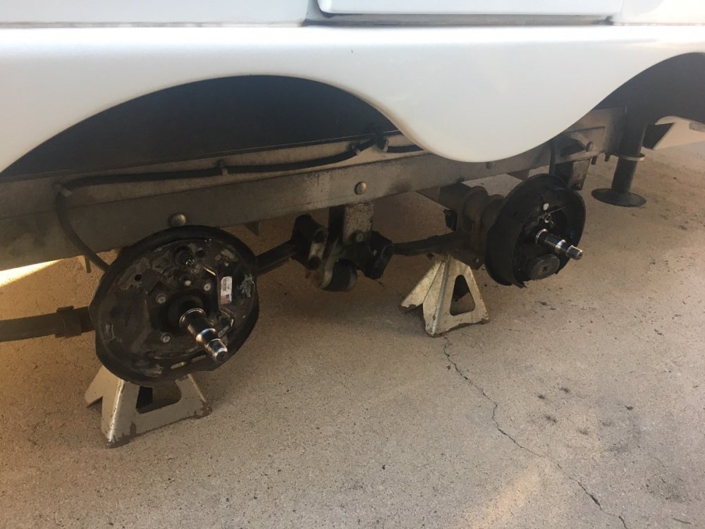

Thanks for all the good suggestions, everyone.  Lots of good information here.  I’ll venture out to the driveway this afternoon and do some checking.  Mike

If you run the palm of your hand over the tread area can you feel somewhat regularly spaced areas that seem to be lower (cupped) than areas adjacent?
If so then I would suspect a worn or defective shock absorber (damper) or an extremely unbalanced tire/wheel assembly. This does not address the somewhat uniform tread wear around the outside edge of the tire.
If you can, grab a level that is at least as long as the tire is tall and place it vertically against the tire aligned along an axis that travels through the centerline of the wheel hub.
Does the 'level' check indicate if the top of the tire is leaning out or in?  If, to achieve a level (plumb) reading, you have to bring the bottom of the level out away from the trailer then that likely signifies that the axle or spindle is bent along the vertical axis for what ever reason. This would concentrate wear around the outer edge of the tire.  A worn or loose bearing assembly would typically show wear aong the inner edge of the tire.
Another possibility is that the axle or spindle is bent along the horizontal axis and that could show as increased or abnormal tread wear at either the inner or outer tread area around the circumference however this type of wear will likely add another measure of wear to the tread that usually presents itself by exhibiting a feathering of the tread blocks.
Now that said; as other have mentioned, check your wheel bearings and have the rig aligned by a professional.

OK, so I’ve been around town trying to get a definitive issue to blame this on, the weather presented some challenges since most folks around here aren’t used to temps in the teens.  I got the tires off the ground, checked freeplay, spinning, looked at shock, etc.  Checked with a level.  Took to to an RV tech, he said shock is worn but still functional, recommended replacing soon.  Bearings were okay.  He thought tire balance may be an issue, also recommended a higher TP since these are LT tires and not trailer tires.  I have them set at 50psi, so I will up that on this next trip.  The Discount Tire guys said it could have been a missing weight causing a balance issue and they also recommended raising TP to at least 60psi.  They did find a nail in the tire, right in the middle between treads that wasn’t very visible until the wheel was removed.
So the bad tire is gone.  We’re going to Arizona Monday.  When we return I’m going to replace all the shocks and bearings.  After 100K miles I think it would be prudent, probably should have done it earlier.  I’ll be watching that tire, I do have a IR heat sensor which I haven’t used much, but will as we travel next week.  Mike
