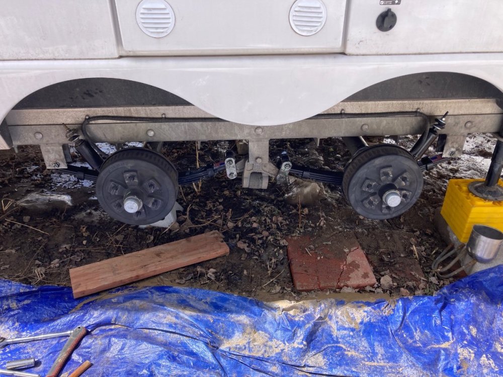

First side is swapped. Old Chinese Dexters will go to the recycler and bring scrap value…maybe enough for a soda pop.  A few observations:

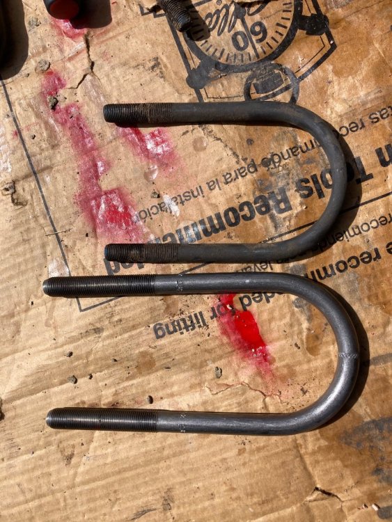

1) I put a set of calipers to my 3500# Dexter axles and they are 3” dia. Ubolts provided by Alcan are for 3” dia axles  fit perfect
2) Alcan ubolts are 9/16” rod vs. the smaller (1/2”?) that were stock on my trailer. No worries installing as the holes in the spring retainer plate are large enough to accommodate the larger bolt diameter
3) Alcan ubolts are longer to accommodate increased spring pack height (5 vs. 4 leafs). About 1-1.5” of thread extend below nuts. I plan to leave but you could cut the excess off if it bothers you

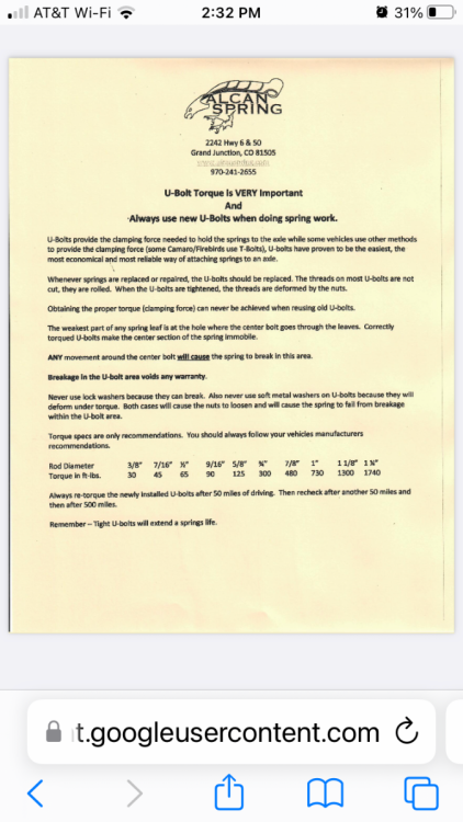

4) Torque specs from Alcan for 9/16 ubolts is 90 foot lbs. See attachment
5) Two of my shocks were blown so I am replacing them  A Irwin squeeze clamp works wonders for compressing and installing the shocks after the springs have been bolted in
6)reversed the wet bolts so that the zerks point inward  even with a 90 degree lock-n-lube fitting it was a PITA before  hoping this will be easier
7) the front springs were still in “ok” shape but starting to flatten.   one rear spring had snapped and the other was bent
8)the parts for my trailer were sourced during COVID and at the height of demand for RVs. I cannot help but ponder if the RV frenzy and skilled labor shortage during this time played some role in my broken spring and the quality of the other one that was bending.  Oh well, just glad to be safe and be replacing the stock springs  before heading out in a month for another Season of seeing this great Country
Very straight forward swap. Heck, I did it on a tarp in melting CO permafrost. Cannot imagine doing the swap inside on concrete. 🤪 That would be Lux.
