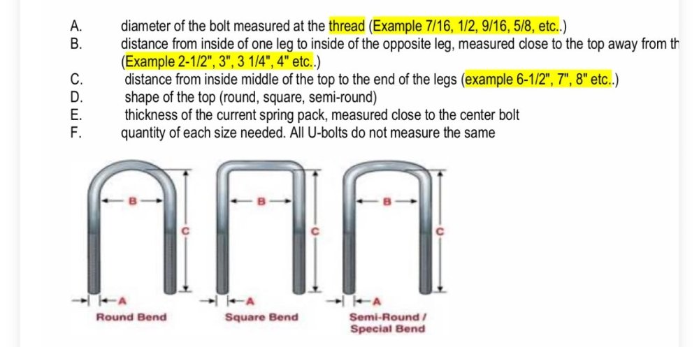

I also just ordered springs from ALCAN for my 2022 LE2. My existing U-bolts measured 1/2” diameter (thread) by 3” wide (axle diameter), but Lou mentioned that other Oliver’s U-bolts have been 9/16” diameter by 3” wide, or 1/2” diameter by 2 1/2” wide. Anyone else have the 1/2” by 3” U-bolts?
The original U-Bolts on my 2014 EII were 1/2" in diameter with a round top bend for a 3" axle. These were for my original Dexter five-leaf spring packs and 5200 pound axles. The U-Bolts you will receive will be 9/16". They would not fit through my mounting plate as it was originally drilled. I drilled out the holes to 19/32" and they fit perfectly.

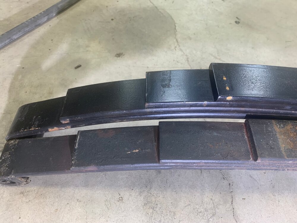

Every spring that I have seen broken has been the fifth leaf at the point where the fourth leaf ends. The best design feature of the Alcan's is that the fourth leaf extends out to where the spring eye starts to form at the end of the fifth leaf. This dramatically increases the strength of the fifth leaf and virtually negates the possibility of a break occurring at the tradition failure point. This one attribute convinced me that these are the best designed springs available. I was not interested in a lighter duty 2000 or 2400 pound spring pack, so the 2750 rating was perfect.
The spring pictured here has the same potential for breakage as the OEMs and would not be my choice.
Absolutely correct, Steve.
We did the same procedure by drilling-out our spring plates for the 9/16" U-bolts.  Not only are the U-bolts beefier, but the Alcan-provided nuts are 50% longer than those on the standard Dexter axle made with sub-standard Chinese spring steel leafs.  More thread contact between bolt and nut = mo betta.
This was one of the main decision points in going with Alcan versus Dexter spring packs for our application.  Dexter's 5-pack springs are designed in the same fashion as the 1750# 4-packs - with the 4th longest leaf extending to only about 3.5" from either eyelet.  This is the traditional break failure point that Steve's referring to in his description above.
With the Alcan design, that 4th spring fills the gap by extending to the point where the 5th leaf starts curving for the eyelet.  Another feature of the Alcans, previously discussed but adding here for clarity, is the larger walled bronze bushing - 3/16" versus 1/16" for the Dexters that had bronze bushings.  This thicker walled bushing creates an even larger diameter eyelet = mo betta.  Please note that the current Dexter 1750# 4-spring packs w/D52 axles are fixed with plastic bushings.  I observed this first-hand last week when replacing our D35s for the D52s.
Serious NOTE:  Owners with the newer Dexters should determine if their axles are equipped with either bronze or plastic/nylon bushings.  Why, you ask?  If a rig's running gear is fixed with an axle kit using spring packs with plastic bushings and using Dexter EZ-flex wet bolts, the bushings will likely not last a season.  The petroleum-based grease used for the wet bolts can decompose plastic bushings.  Not good, IMO.
The pic below shows Alcan's extended 4th leaf right to the curvature point of the 5th spring's eyelet - a robust design feature not found in either the 4- or 5-pack Dexter Chinese-made spring kits (FYI, the traditional breaking point with the Dexter 4-packs is about where the end of the 3rd spring is located, see below pic):

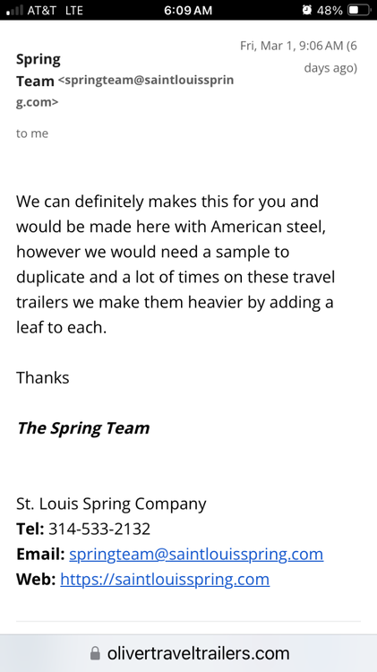

For those looking for alternatives made with US steel, here is the response I received from St. Louis Spring when posing the question  to them about whether they could fabricate a set of 4-leaf, 1,750 lb leaf springs for me. To this date, I am not aware of a Oliver owner who has gone this route. Very interested to hear if anyone has purchased springs from them for their Ollie and how they have worked.

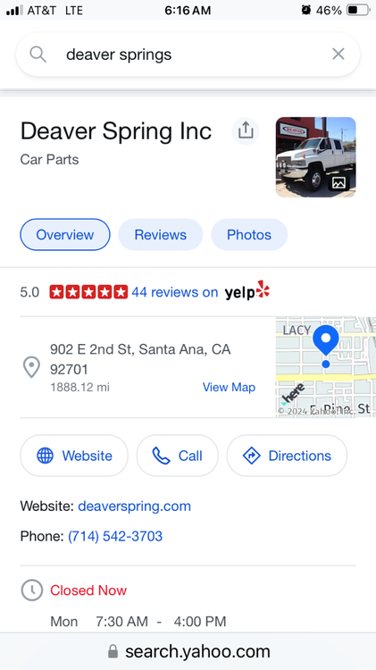

One other source to check may be Deaver Springs in CAIMG_8614.thumb.png.fd77e5063dfd44400936d8ba7a519484.png

Around the year 2000 in took a broken 50 year old boat trl spring to St. Louis spring, with the request of 1 inch additional arch in the design, they made 4 of them to my exact specs, very happy with the results.
