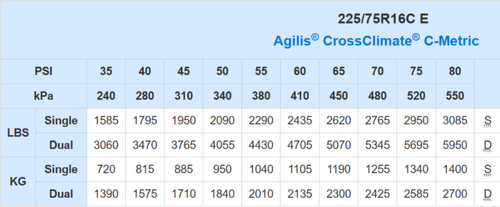

jd1923 Posted March 9, 2024 Posted March 9, 2024 Use the load/pressure chart published for your specific make, model and tire size: 1 Chris & John in Prescott, AZ | 2016 EII #113 | '01 Ram 2500 Cummins!

Geronimo John Posted March 9, 2024 Posted March 9, 2024 (edited) 1 hour ago, jd1923 said: Use the load/pressure chart published for your specific make, model and tire size: So, if we have a 6,000 pound trailer, with four tires and a 10% tongue weight, each of our tires will be supporting 1,350 pounds. The chart shows a minimum recommended load of 1585 pounds. So basically it appears that we are not on the chart.... GJ Edited March 9, 2024 by Geronimo John TV: 2019 F-150 SuperCrew Lariat, 3.5L EcoBoost, 10 Speed Trans, Max Tow, FX-4, Rear Locker OLLIE: 2018 OE2 Hull 342, Twin Bed. OLLIE DIY’s: Timken Bearings, BB LiFePO4's, Victron 712 Smart, 350 Amp Master Switch, Houghton 3400, Victron Orion DC - DC, 3000-Watt Renogy Inverter, P.D. 60-amp Converter, Frig Dual Exhaust Fans, Kitchen Drawer Straps. Front Wardrobe Shelves, Snuggle Shelf. TV DIY’s: 2 5/16" Anderson System, Nitto recon’s, Firestone Rear Air Bags, Bilstein 5100’s, Mud Flaps & Weather Tech all, installed Ham Radio (WH6JPR).
Geronimo John Posted March 9, 2024 Posted March 9, 2024 (edited) On 3/9/2024 at 12:50 PM, Geronimo John said: each of our tires will be supporting 1,350 pounds One needs to ask, why would a spring set rated for 2,000 pounds fail with just a 1,350 pound load? In light of the heat treatment photo, this clearly is a defective product and we have almost a dozen instances where the Dexter provided axles have failed. This is a life safety issue that OTT would be in the best position to pursue with their supplier. Not to mention, as I suggested above, OTT should be warning their customers of this known issue. Keep in mind that not all OTT owners read every thread. We all would feel terrible if one of our beloved trailers went off a cliff and took out a family due to this defect. MODERATORS: I am asking that you: Make OTT aware of this issue and the frequency for which it appears to have occurred. Strongly suggest that they provide all owners with a Safety Bulletin. And to specially ask owners that have had failed springs to notify them for documentation and further actions with their supplier. Once they have the facts from owners with defective axles, to formally advise Dexter of this issue. GJ Edited March 11, 2024 by Geronimo John typo 5 TV: 2019 F-150 SuperCrew Lariat, 3.5L EcoBoost, 10 Speed Trans, Max Tow, FX-4, Rear Locker OLLIE: 2018 OE2 Hull 342, Twin Bed. OLLIE DIY’s: Timken Bearings, BB LiFePO4's, Victron 712 Smart, 350 Amp Master Switch, Houghton 3400, Victron Orion DC - DC, 3000-Watt Renogy Inverter, P.D. 60-amp Converter, Frig Dual Exhaust Fans, Kitchen Drawer Straps. Front Wardrobe Shelves, Snuggle Shelf. TV DIY’s: 2 5/16" Anderson System, Nitto recon’s, Firestone Rear Air Bags, Bilstein 5100’s, Mud Flaps & Weather Tech all, installed Ham Radio (WH6JPR).

jd1923 Posted March 10, 2024 Posted March 10, 2024 (edited) 3 hours ago, Geronimo John said: So, if we have a 6,000 pound trailer, with four tires and a 10% tongue weight, each of our tires will be supporting 1,350 pounds. The chart shows a minimum recommended load of 1585 pounds. So basically it appears that we are not on the chart.... GJ In the fine print, they always state to run at the minimum when under the min, and of course do not exceed the maximum. Given you actually keep your Oliver at 6000 LBS, you can run 35 PSI. I would not suggest subtracting tongue weight, since when running at highway speeds the hitch is bouncing up and down and half the time ALL weight is on the trailer wheels. This is why for years, yes YEARS @John E Davies ran his Oliver at 42 PSI, and suggested we all do the same. I've been at 46 PSI last two outings. Those of you still running 50, 60, even 80 PSI, STOP doing that. According to Michelin, 40 PSI is a good number for the Elite II, and when we leave to Casa Grande next week, I'm going with exactly 42 PSI to honor our good friend John E. I wonder if there is some correlation between spring failure and those running the 80 PSI printed on the tire? Or, have these springs failed mainly on those pushing the GTRW? Perhaps, but again the broken cross-section looked like cr@p and some of these leaf springs were not hardened properly. When not hardened properly, steel will bend. These springs should not bend as in the picture above. They should break if over-stressed (over the GTWR), but not bend. Edited March 10, 2024 by jd1923 Added stuff! 2 3 Chris & John in Prescott, AZ | 2016 EII #113 | '01 Ram 2500 Cummins!

jd1923 Posted March 10, 2024 Posted March 10, 2024 3 hours ago, Geronimo John said: One needs to ask, why would a spring set rated for 2,000 pounds fail with just a 1,350 pound load? OEM springs only need to be rated at 1750 LBS (7000/4). Most lightweight dual-axle trailers (i.e. not HD non-commercial) are rated for 7000 LBS. I have a 12 FT flatbed trailer on our property. We haul dirt bikes & quads or our side-by-side, used to pull it with our Class-C). It has the same Dexter axles (and the leaf springs still look good too, tG). Leaf springs at 2000 LBS are 14% stiffer. This is a very good number! They appear to be correct in their 5-leaf design. I will buy a set next fallor next year. Thank you. Chris & John in Prescott, AZ | 2016 EII #113 | '01 Ram 2500 Cummins!
Geronimo John Posted March 10, 2024 Posted March 10, 2024 1 hour ago, jd1923 said: This is why for years, yes YEARS @John E Davies ran his Oliver at 42 PSI, and suggested we all do the same. I've been at 46 PSI last two outings. Those of you still running 50, 60, even 80 PSI, STOP doing that. According to Michelin, 40 PSI is a good number for the Elite II, and when we leave to Casa Grande next week, I'm going with exactly 42 PSI to honor our good friend John E. thank you for your post. I will follow the lead and reduce my 50 to 42 PSI. Mahalo and Aloha, GJ 1 2 TV: 2019 F-150 SuperCrew Lariat, 3.5L EcoBoost, 10 Speed Trans, Max Tow, FX-4, Rear Locker OLLIE: 2018 OE2 Hull 342, Twin Bed. OLLIE DIY’s: Timken Bearings, BB LiFePO4's, Victron 712 Smart, 350 Amp Master Switch, Houghton 3400, Victron Orion DC - DC, 3000-Watt Renogy Inverter, P.D. 60-amp Converter, Frig Dual Exhaust Fans, Kitchen Drawer Straps. Front Wardrobe Shelves, Snuggle Shelf. TV DIY’s: 2 5/16" Anderson System, Nitto recon’s, Firestone Rear Air Bags, Bilstein 5100’s, Mud Flaps & Weather Tech all, installed Ham Radio (WH6JPR).
