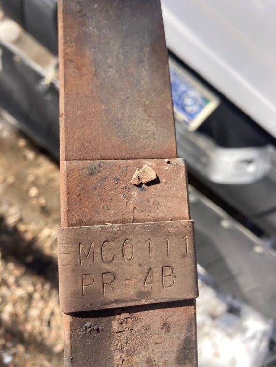

I can confirm that these measurements match the OEM brand/model spring specs for Hull #898 as well as match the published specs for the replacements spring brand/model provided by Oliver Service for my trailer. I encourage owners to confirm the specs of their OEM springs to know what they are replacing before proceeding with replacement of any part as we know certain differences exist between out trailers based in hull# and date produced.
My OEM Spring make/model was conveniently stamped into the retainer band towards the end of each of my leaf springs (see pic). From this info I did a google search and found the specs. The springs installed at the factory on Hull #898 were made by EMCO and are model #PR-4B.  The specs match what Steve provided above.  Added to the specs Steve provided is the bushing spec provided by Oliver.  The bushing is inserted into the spring eye and our wet bolts ride inside of them.  The specs for these bushings (whether plastic or bronze) is 1.75”L, 11/16 O.D.(outside diameter) and 9/16”I.D.(inside diameter).

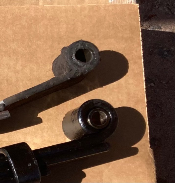

It should be noted that the bronze bushing on the ALCAN springs is thicker walled than standard such that while it still has a 9/16”I.D., the spring eye into which it is pressed is larger than 11/16”.  The 9/16”I.D. Of the bushing is important on these metrics as our wet bolts (which are 9/16” must fit inside the bushing eye)  I hope this makes sense.  I have attached a pic for comparison  OEM spring in top, ALCAN on bottom.863D9518-41D6-4DEB-9EB1-4967357C85D9.thumb.jpeg.4e86eb08a4944a9a4fb886772058c4d2.jpeg
Mountainman198.  Just want to understand what you are "noting".  Are you saying that I need to order the wet bolts from ALCAN or do the bolts I already have work?
The wet bolts from my Oliver are 9/16" O.D. and from my measurement of the ALCAN springs I received I am re-using my existing wet bolts as the I.D of the bronze bushings in the ALCAN springs I received are 9/16".  Let me know if this does not make sense.  I chose NOT to buy new wet bolts from ALCAN.

He also provided that "yes, they use a much thicker brass sleeve in their springs than the industry standard.  This in no way affects the reuse of our existing bolts.  It's just beefier, stronger, and longer lasting than what most use in their products.
