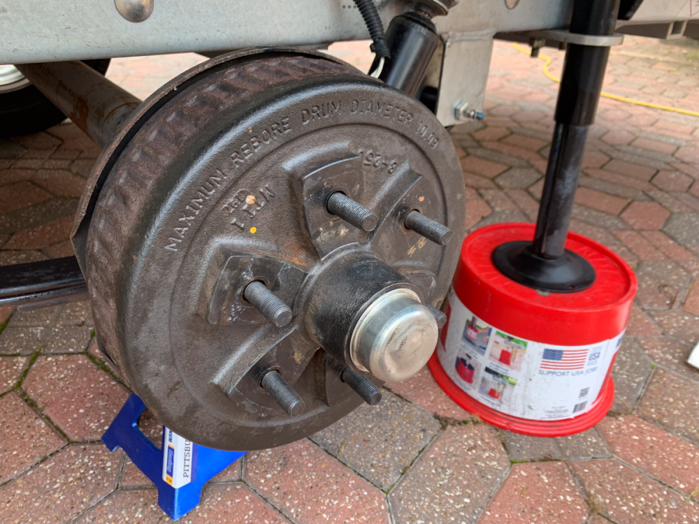

Oliver is most likely installing the 6 on 5.5 hubs on both axle sizes, maybe to keep the wheels universal on all builds. I have the D35 axle with the 6-bolt pattern.
Yes, the D52 axles will have the same 6x5.5 hubs, but you should see 12" brakes and E-Z Lube bearings. See in your pic (ours is the same) where it shows 10" on the drums.
Just sizing things up if there ever comes a time to beef up axles, springs and brakes. Thanks for your input, much appreciated!
