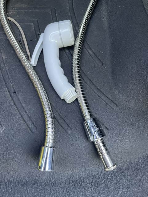

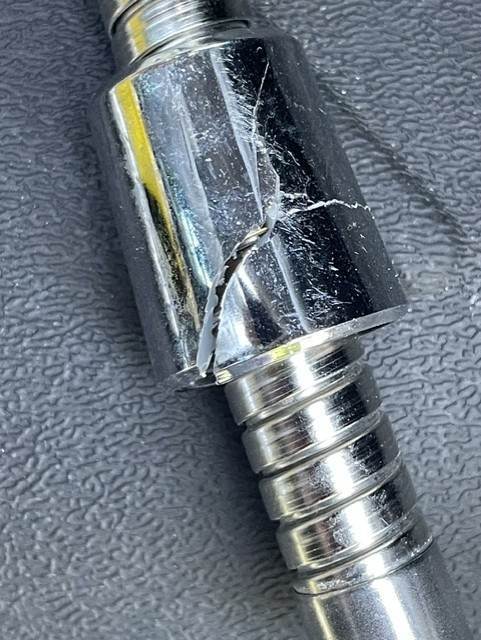

You might check your inside connection of the outside faucet. The inside collar broke. One end is metal and the one that broke is plastic. I think the metal end should be the inside trailer connection. It is under more stress. Oliver might want to revise the build instructions. The plastic end was connected inside the trailer. Honestly, neither end should be made of plastic. Hopefully this is a standard hardware store buy. We are on the road, where these things always happen!
