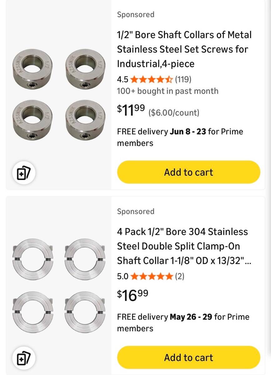

Order a 1/2 shaft collar from Amazon. Try to find a collar that is split and clamps on or one that uses a set screw for attachment. Buy one that is stainless steel. The collar should be clamped on the rod end that had the washer, the other end will still use the washer and cotter pin. These stainless collars are only a few dollars each and will make a good solid end.- 1 reply
