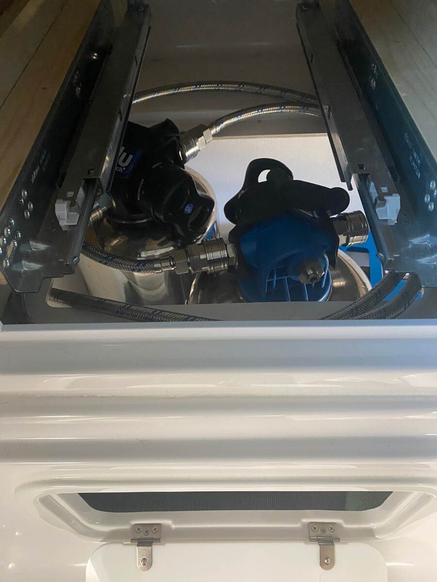

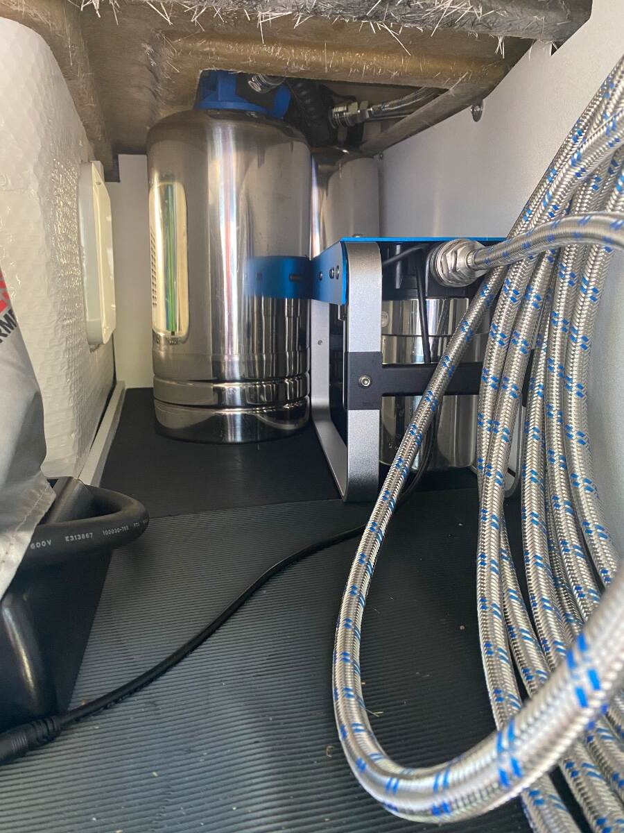

Proof of concept; onboard (inboard?) water conditioning and filtering. The problem has been the water softener and iron filter. So far it’s all be a modular system I move around. A pain but flexible. I gave up on putting the tanks onboard as they’re a bit too tall for any of the storage. But poking around I found that the panel under the bedside drawer is just sitting there so … Pros All contained nicely Puts weight in the back near the wheels (I’ve got plenty in front) Always set up so just takes two hookups, one from the faucet and two to the back water input. For waterpoint boondocking (e.g. national parks) I haven’t used it. Too much to futz with pulled off at some waterpoint and usually blocking the road. Since it’s permanent those hoses won’t kink, they’re a pain as they want to kink up if you use them modular Easy to access the valves for backwashing and regenerating by just taking the drawer out which is easy It just works out nicely with the lines having the right amount of coil Cons Not so great for city water. Unless I jack into the line internally I have to keep the hatch open which isn’t optimal But that’s fine, just use the tank and pump until/if I decide to make it more permanent Takes up the back storage But that’s odd storage anyhow, I finally settled on putting a folding chair and table there, plus dirty laundry shoved through the interior hatch. And now this frees up that storage elsewhere. The tanks have been knocking about, mainly in the truck. The main filter has been in the Sea Biscuit back storage, but now I can put the chairs and whatnot there And … that’s it? I’ll sit with this a few days but I think I like it and will start to make it permanent 👍
