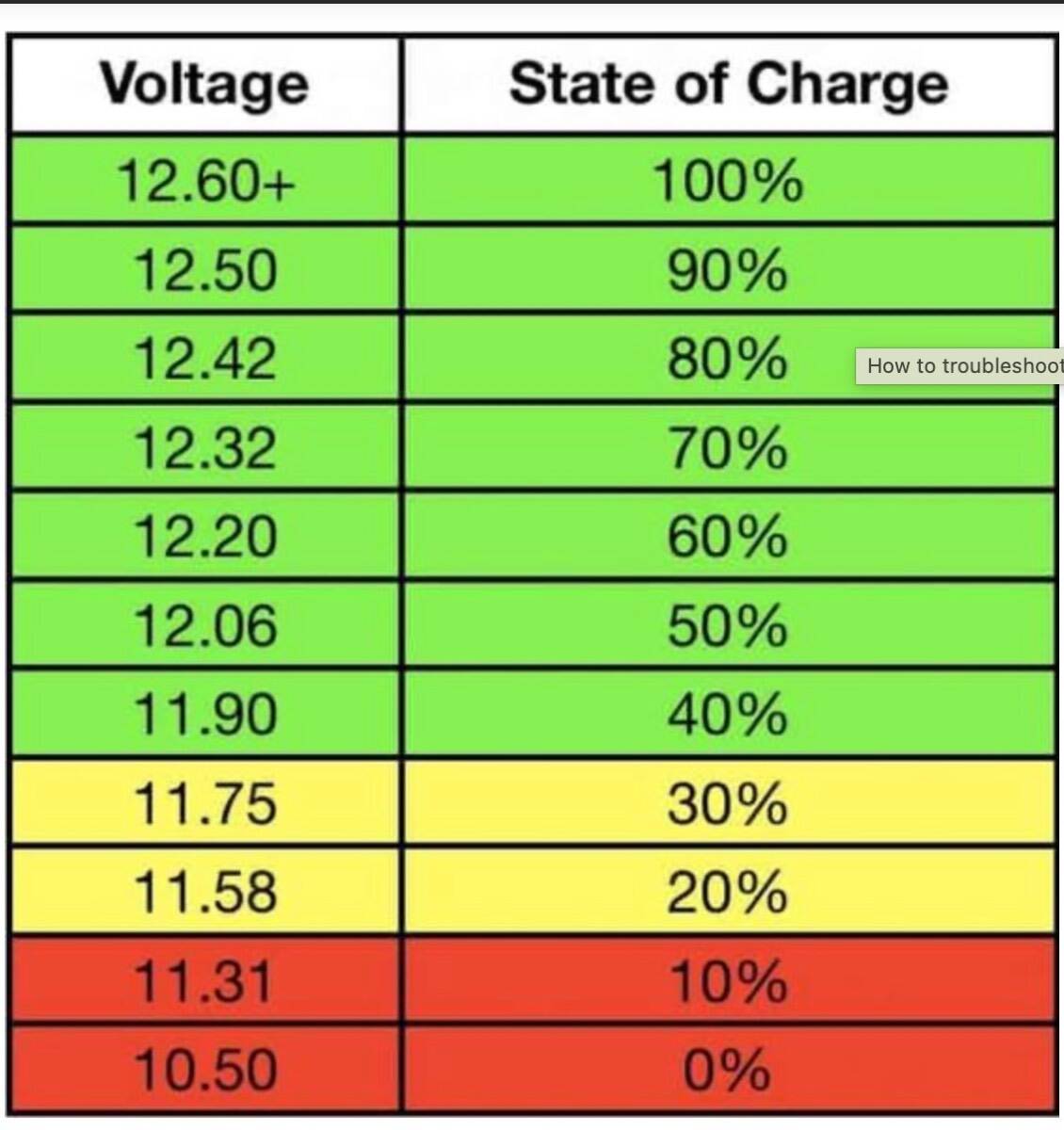

I have AGM batteries that test with my multi tester as having full power. However, the Xantrex indicates “dead batteries”, even though the voltage reading on it says 11.7V. It seems to indicate that the Xantrex is not reading the batteries correctly.
