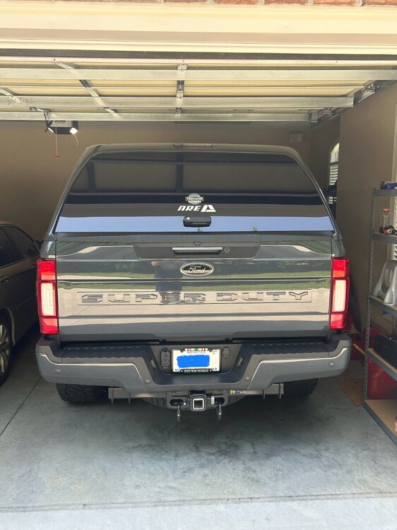

@MAX Burner Excellent taste! 🤩🇺🇸 Ha! I can say we are very happy with our 6.7 liter 1 ton Diesel Tremor. Long haul comfort, safety, up higher cab view, fuel mileage when towing, zero issues with cargo capacity or tongue weight. The diesel engine brake did a fine job all through out our trip to Colorado descending through many of the Rocky Mountain steep passes. No need to heat up our truck or trailer brakes as the diesel engine brake worked flawlessly. On a few of the passes we traveled on they had local law enforcement checking brake temperatures with infrared heat sensor tools on vehicles descending down the mountain. We were never brake check or flagged to pull over with our rig. Several cars and trucks were made to pull over until their brakes cooled. Most 1/2 ton trucks will tow and Oliver, I fall into the club of how well the truck with stop a fully loaded ready to camp Oliver. No white knuckles towing or slowing with our beast. It’s the right tool for the job in my experience.
@George Alexa yes you need a truck imho and are wise to do your due diligence. Whether it is diesel or gas that is all according to your budget and what works for you with regard to payload and camping style. We started out towing our Oliver with a half ton truck and quickly learned that we could be pushing the legal limits with our payload capacity. Naturally this was a concern due to the legal implications if something were to happen operating an overloaded tow vehicle. We sold our 1/2 ton and bumped up to a 1 ton and never looked back.
We like keeping our vehicles garaged and when we built our home I made sure it would accommodate a larger heavy duty truck like our Super Duty.
Best of luck in your decision on a tow vehicle! Drive em all and pick the one that will serve you best.
