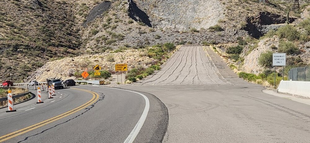

After we got more than halfway down, I felt the upgrade HD brakes on our Dodge Ram start to fail. I have felt this before, so I knew what it was, from driving the heavy old cars of the 50s that would overheat and fade. The speed limit was marked at 30 MPH with many curve warnings at 20 MPH. I never exceeded 25 MPH regardless my brakes overheated. I have an infrared heat measurement gun. Parts of the discs were at 360F and the caliper holder on the right side was the hottest just over 400F. I was thinking why? We sat there for 30 minutes until all temp reading were down to 160F. (See 3rd pic for side view where we stopped.)
I realized the truck was breaking for the trailer that the trailer brakes were not engaging hard enough for the extremely steep grade. The gain was fine for driving around town but should be increased for highway speeds and what I've learned now is that it should be increased more for declining steep grades.

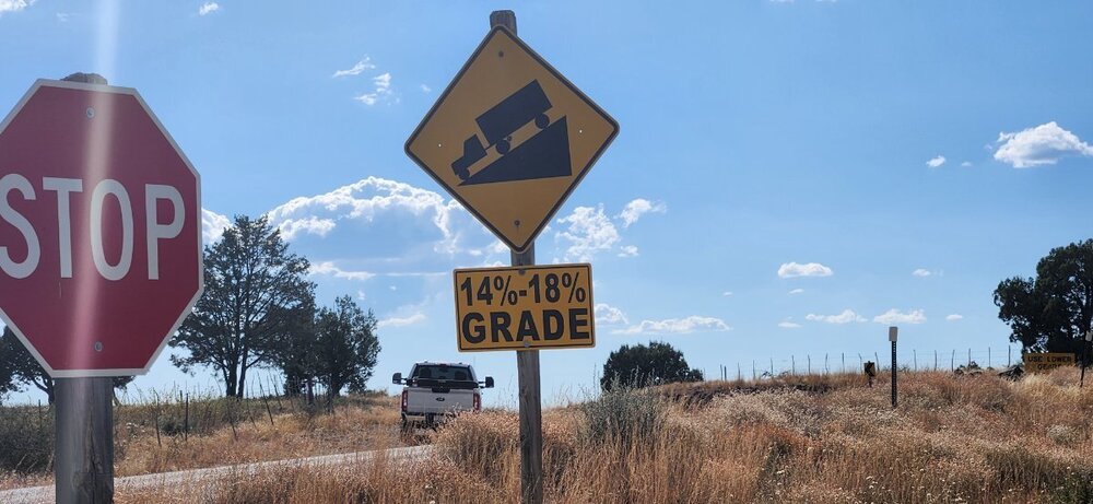

Check out the sign in my first picture. Ever see a grade warning this steep? Twice we have wanted to visit Tonto Natural Bridge near Payson AZ. Both times I was towing. We did not realize the road to this park was so steep. This sign was at the exit of a turn-around area they had for us towing travel trailers! We passed on this visit not having time to disconnect and honestly, I did not want to attempt this descent even without the Oliver!
Interstates and US highways have 6-8% grade max when speeds are >55 MPH. They did not have grade signs on AZ HWY 78 though I'm certain it was at least 10% in some stretches. Maybe Tonto Natural Bridge another time. It's only 2 hours from home.

On 11/3/2024 at 10:02 AM, jd1923 said:
Final pic is the truck runaway just prior to a tunnel through the mountain.
I drove an 18-wheeler for six months helping a friend with his transport business, some of which while hauling grain up through Palo Duro Canyon in north Texas and into Oklahoma. Saw many a truck runaway ramp and quickly appreciated their purpose. These ‘big-rigs’ have air brakes which can fail if applied too often on extensive down hill slopes; a situation wherein air demand exceeds the capability of the onboard compressed air supply or even a malfunction to the air system (compressor, air tank, air lines) itself. These off ramp structures are comprised of a deep bed of sand or gravel, an effective method of safely slowing heavy vehicles like trucks and even buses to a stop. The sign displayed in @jd1923’s pic reads ‘RUNAWAY VEHICLES ONLY’, guess that includes an Oliver TV, as well. Safe travels!
