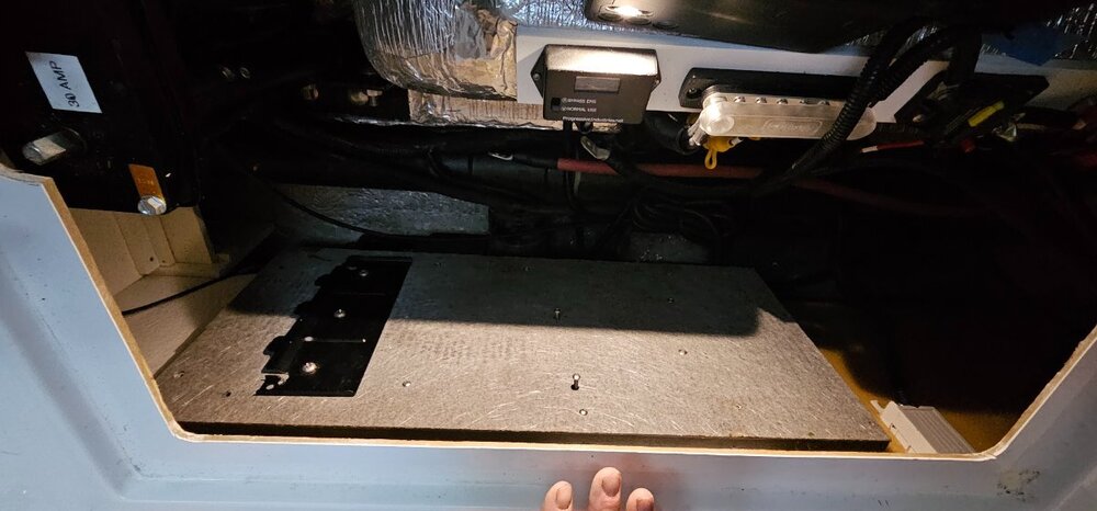

Ray Kimsey Posted November 8, 2024 Posted November 8, 2024 I updated my batteries with assistance of a friend who does solar installs for a living. This is a bit different than most of the installs I have seen here in that we used two 400 AH EG4 rackmount batteries. After removing the rackmount handles from the batteries and the battery tray from the Oliver they fit perfectly. There was a bolt in the bottom of the battery cabinet that was an issue. We put in 1 inch square aluminum rods on the floor of the cabinet to raise the batteries above the bolt head. We also replaced the Xamp solar charger with a Victron solar charger 100/30, added Victron lynx shunt, Victron distributor, and Victron cerbo with a touch screen (7" model). This fit perfectly in the hole left by the removal of the Xamp solar charger. To get the cables from the cerbo to the touch screen I ordered an extra HDMI extension cable and USB cable (approx. 15'). I ran the cables to the back of the camper in the tray behind the cabinet and then down the wall in the back, under the basement, and back up under the street side bed. Trying to pu the wire down next to the pantry would not work. It was too tight. I believe Victron is planning on replacing the HDMI cable with the small USB connections this spring. Didn't help me, but maybe it would help you. In addition we added a solar disconnect which you can see below. In the pictures below. These batteries can be powered off and the breaker thrown to disconnect. They also come with automatic fire suppressants, two per battery. Cost was $1200 per battery (400 AH, each). This was the first stage of the upgrade. At some point I may replace the Xantrex 2000 inverter, but for now it works well for us. Unfortunately the Xantrex and Victron do not talk to each other. That is why you don't see information on the touch screen about the AC loads and AC input. We have taken it on a couple of trips now and we do not come close to making a dent in the batteries. I added an extra battery in case we need to replace our 3-way fridge in the near future. So far it is doing well. I replaced a power board on it a while back, but since then no issues. Parts are harder to come by now though. 11 2 2019 Ram 1500 5.7L V8, 3.92 axle ratio - 2020 LEll - Hull676

rideadeuce Posted November 24, 2024 Posted November 24, 2024 On 11/8/2024 at 2:18 PM, Ray Kimsey said: There was a bolt in the bottom of the battery cabinet that was an issue. We put in 1 inch square aluminum rods on the floor of the cabinet to raise the batteries above the bolt head. Nice install. I built up the floor with a 1/4 inch rubber mat to get ride of the bolt problem. 2 - Mike Brentwood, TN - 2018 Elite II - Spirit of Adventure Hull #308 - 2016 Toyota Tundra Limited 5.7L Class IV hitch with 12k lb coupler, Weigh safe adjustable trailer hitch, Dobinsons HD 2in Leaf springs, Timbren bump stops, Dobinsons 3in coilovers and UCAs, Mechman 370 amp HO alternator. Oliver upgrades: Starlink, Cradlepoint cellular modem, Victron Multiplus II 12V 3000W, Ekrano display, Orion XS 50amp DC/DC charger with Anderson connections, Toshiba 6-in-1 Microwave oven - air fryer combo, Atmos 4.4 15k AC/12K Heat pump, Nova Kool 5810 fridge, Epoch 460aH x2, 520 watts solar on top, Custom aluminum bicycle rack, Alcan Springs, Bulldog shocks, Falken H/T02 tires, Seabiscuit Metal Designs front storage box and moose rack.

johnwen Posted January 13 Posted January 13 On 11/24/2024 at 3:31 PM, rideadeuce said: Nice install. I built up the floor with a 1/4 inch rubber mat to get ride of the bolt problem. You were able to fit 2 460a Epochs in the battery cave with the battery tray removed? My tray bearings are shot anyway. Can you take a picture of your install? Are you by chance coming to Quartzsite? Thanks, John 2022 Oliver II #996 "Bessie", 2019 Silverado LTZ 5.3, Veterans https://wenandjohnsadventure.com/
jd1923 Posted January 13 Posted January 13 8 hours ago, johnwen said: You were able to fit 2 460a Epochs in the battery cave with the battery tray removed? My tray bearings are shot anyway. Can you take a picture of your install? Mike has several pictures in a mod post. BTW, two (2) of the more expensive Epoch 460AH battery with "Victron Comms" will just fit! Two of the less expensive Epoch Essentials 460AH will not fit. They are about a 1/2" too wide. Chris & John in Prescott, AZ | 2016 EII #113 | '01 Ram 2500 Cummins!
johnwen Posted January 13 Posted January 13 8 minutes ago, jd1923 said: Mike has several pictures in a mod post. BTW, two (2) of the more expensive Epoch 460AH battery with "Victron Comms" will just fit! Two of the less expensive Epoch Essentials 460AH will not fit. They are about a 1/2" too wide. Thanks, JD ::) 1 2022 Oliver II #996 "Bessie", 2019 Silverado LTZ 5.3, Veterans https://wenandjohnsadventure.com/
