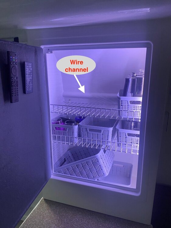

I’m not allowed to make any visible holes or have exposed wiring, so I fished the wires from the rear street-side overhead cabinet - behind the pantry - and into the space behind the radio.  There are wire channels in the overhead cabinets under the mats and Oliver conveniently moulded a wire channel in the back of the pantry to join them together.  It’s easy to snake a fish-rod through the channel to pull a new hot and ground wire through.  I’ve found that a $12 Amazon fiberglass sectional fish rod works great for fishing wires in the Oliver because you can add sections as you push it through.  It’s a good idea to pull a string through with the wires incase there’s a need to add more wires in the future.

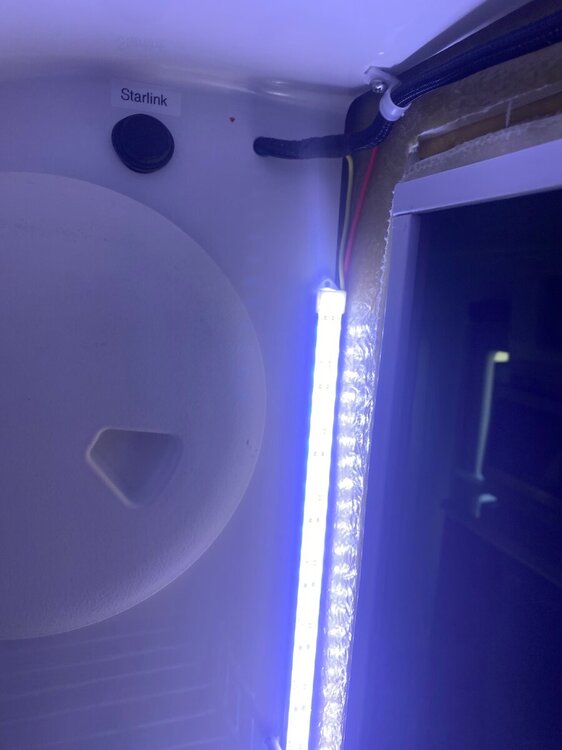

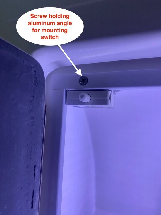

1/2 sheet metal screws work well to attach the LED light bars, or use good double stick tape.  There is an air gap between the inside and outside walls of the pantry, and screw holes can be drilled through the inside wall in the same way as Oliver did for the shelf mounts.  Just be careful not to drill all the way through the outside layer.  I put two LED bars end-to-end on the right side of the pantry where they can’t be seen.  A piece of 1” aluminum angle was screwed to the upper left corner to mount the cabinet light switch, and the wires were sheathed and secured with cable clamps behind the door frame.

IMG_3883.thumb.jpeg.b06f1a1c3f14f607625ca86277b25de8.jpegIMG_3886.thumb.jpeg.8abf4d2300210aba9739098abaab5a36.jpegIMG_3885.thumb.jpeg.05fb7d91b1d2b05b9e3e741a6b66af0f.jpegIMG_3887.thumb.jpeg.ad22ac0f614f590d08f6aefbfa17ce32.jpeg

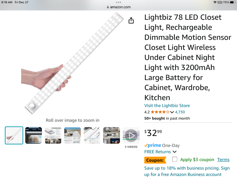

I went the easy route and installed LED closet lights; rechargeable, dimmable, motion sensor and wireless. Larger ones in the pantry and under the curbside bed, smaller in the battery bay and dinette seat hatches. Easy mount with a magnetic strip and long battery life.

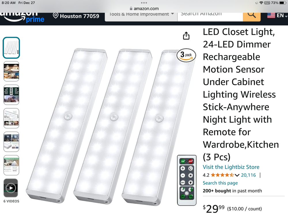

Nice job! I was lazy and found some battery operated stick on LED lights that are motion sensitive. The seem to work great and you just stick them on for us lazy folks. We put one in the pantry, the closet and the basement next to the access between the beds. I also stuck one that you touch to turn on above the main switch panel. I always hated at night I cant see the black witches without a flash light.  Now I just touch the light and it comes on so I can see the switches. So far it's been 2 seasons without needing new batteries. An inexpensive solution that takes no time to or skill to install, just peal and stick.

@Bill and Nancy Where did you get the battery operated stick on LED lights that are motion sensitive?

This should be the link for the motion sensitive strip lights. Im not sure where I got the puck light but they have them on amazon but they come in packages of 3 or more. I think I may have got  it at Lowes or Home depot.  I think I attached the link and the photo file correctly I wanted to put titles on them but I cant seem to do it. The motion lights have a metal strip that sticks with sticky tape to the trailer. Then the light stick with magnets to the strip with rare earth magnets. So it makes it easy to take them down to put in batteries.
Hope this helps

By the way, for a person who goes by the nickname Snackchaser, your cabinets are curiously devoid of snacks....

Yes, the snacks are missing!!!  Wifey has been notified and I can neither confirm or deny any involvement in their disappearance!
