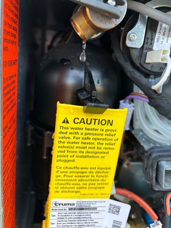

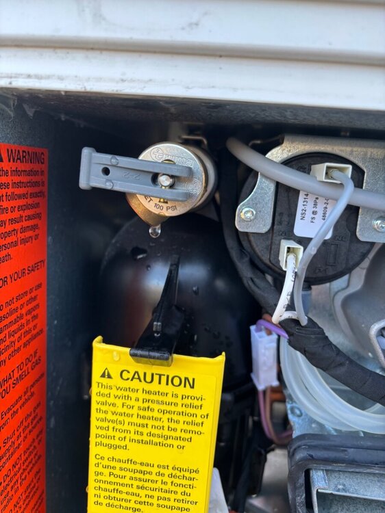

Woke up this morning and found water below Truma compartment. Opened the cover and noticed dripping, then streaming from the pressure relief valve. Any suggestions what problem was and how to correct? Much appreciate any help. IMG_1969.thumb.jpeg.4e95b4b1e31ccf3d1687e6cf77d35308.jpeg

Yes, we are hooked up to city water. We do not have a regulator. It was not leaking at our previous stop.
I just googled and it says to keep pressure below 40psi and use a regulator- which I don’t have yet. I toggled back the city water spigot and it seems to have stopped.
is it imperative to have a regulator?
thanks for your quick help. Needless to say  was panicked at first being only out second trip out.

Yes, it is important to have a pressure regulator. Many campgrounds (and towns) have pressures in the 60 psi range (and more in low lying areas) and can have pressure surges as well. This would be my guess on why your PRV is leaking.

Many camping spots have water that is delivered to the spigot at pressures that are higher than you should - safely - use in your Oliver - as @dewdev mentions above.
Another thing you could try would be to "open" that pressure regulator - simply lift the grey tab on the top of the regulator.  This relives the pressure in the "tank and water lines" inside your Oliver.  It also can serve to clear any deposit or debris that may have caused the leak.  Then close the grey back to its original position - note that this relief valve tab is most likely "spring loaded".  Therefore, it should simply "snap" back into place.
Thanks to both for the information. I will go out and get a regulator today. Appreciate the help! Greetings from LeFleur Bluffs State park!

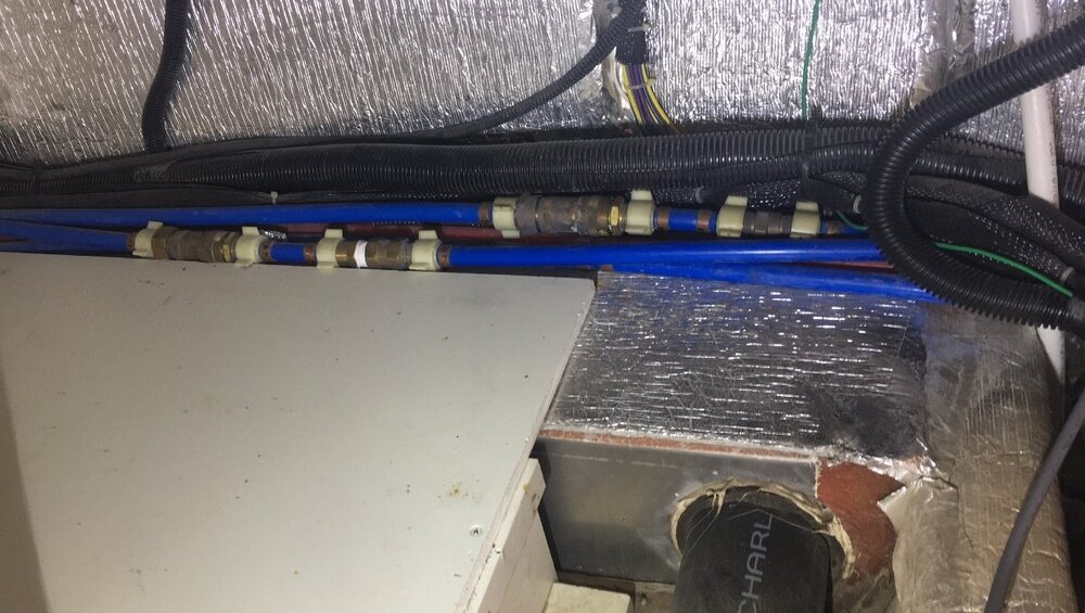

Our older hull has OEM built-in pressure regulators and backflow preventers on both City and Fresh Tank lines (see pic), not sure if they still do that on your new hull. They do not show the pressure regulators on the plumbing schematics, just the backflow devices.
Because our City Water line is overly restricted, we never use it since the pressure is too low. I do need to get back there, clean the backflows and remove the restrictors to use a true post-mounted pressure regulator instead. We fill the fresh tank regularly and run the water pump for our water. You could try this to see if the drip stops.
However, many have pointed at this reason. I doubt it! Your relief vale is rated at 100 PSI which I can see in the picture. It is made for major steam build-up in the system. I doubt campground water pressure is >100 PSI. You likely need a new valve.
Do not do the above scale clearing technique with the water being hot.
Per the picture, the hot water will blast out and likely cause you and possibly others extreme burns.
I strongly recommend you contact OTT as this is a code violation and should be fixed immediately.
Our older Hull # 050 does not have the pressure regulators. It does have the back flow preventers in exactly the same places you show in your picture. For the earliest Hulls (say below 300) an owner would need to examine their unit to verify whether they have both or maybe nothing in that section of the rear basement. At that point in construction they were just kind of making it up as they went and there's not a whole lot of consistency. I would expect the latest models have only the back flow preventers but I can't guarantee you where they would be.

It appears many of us use water from the FWT vs. the City Water inlet. Some of the hulls, ours included, have back flow preventers (check valves) AND restrictors on BOTH incoming water lines (see pic). The restrictor on the FWT fill line takes more time when filling the tank. When using water from the FWT you are past the restrictor.
When using City Water you GPM is being slowed down by the restrictor during use. Once last year, I tried using the City Water inlet. Immediately, Chris cried out, “What’s wrong with the water?”

If I could figure out how to my big butt in there (shoulders actually), I would clean the check valves and remove the restrictors. My son Adam is smaller and thinner, so I will get his help this spring!
If using the City Water, a true pressure regulator outside the Oliver is the way to go. Not needed to fill the FWT since pressure cannot be created in an open line. And the tank will fill fast!
