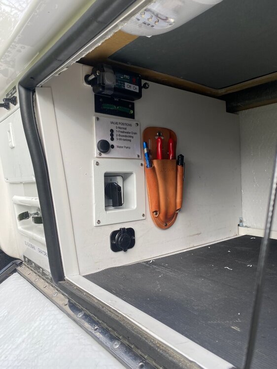

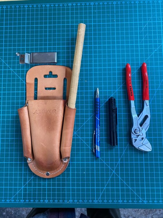

When doing hook-ups or departures from camp, I regularly find myself in need of water pump pliers to tighten and loosen water lines. . . which means digging out the tool box to find them.  So I decided to mount a dedicated pair in the outdoor garage where they will be close at hand when needed.  After looking at various options for storing the pliers, I settled on a small leather tool pouch from Amazon.  It was low profile, could be easily mounted on the wall, and it didn’t take up precious garage floor space.  The pouch also had pockets for a small flashlight and pen, which also can also be elusive items when signing in after dark.
The tool pouch had a belt clip that was removed, and I stretched one of the pockets to fit my LED penlight.  The leather is easily stretched by soaking it in water for about 60 seconds and using a dowel or other cylindrical object to expand the pocket.  The leather is quickly dried in an oven at 130 degrees to hold the new shape.
I chose a 7” Knipex Plier Wrench for my kit because of its high quality.  They aren’t cheap, but the Oliver is deserving, and they are a pleasure to use.  There are many excellent choices available for pliers, flashlights and pens.  I just used what I already had on hand.

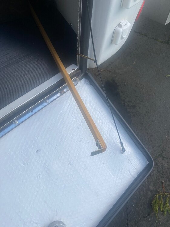

Some folks might also be interested in my handy tool for stashing and retrieving things from the unreachable depths of the garage.  This is simply a sanded length of 1/2” x 3/4” moulding with an aluminum angle screwed onto one end as a hook to pull things out.  Oh, and notice the spring to pull the garage door suspension cable out of the way so it doesn’t get pinched in the seal like mine does.
Hope you find this useful!  Cheers!  Geoff
You mean that you simply can't craw in there to get what you want?😁

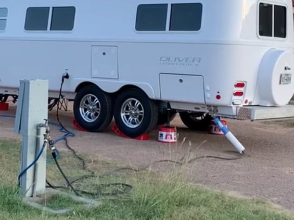

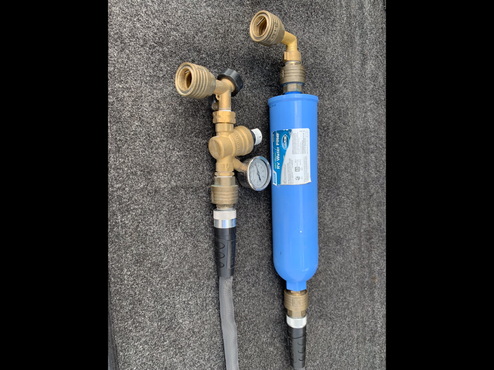

51 minutes ago, Snackchaser said:
Nice!  I think I'd need several sets!
I use a Y valve on the CG shore fresh water source for my extra hose “camp hose”. The rear bumper makes a nice shelf to support my water hose.
My Andersen levelers came in handy as the slab had a slight fall to the street side to allow water to run off.
This was at Teton Valley Resort in Victor, Idaho last fall, we love the Tetons. And this was a really nice base camp.
Same here, the Y valve with Eleys for an extra ‘camp hose’ is a very handy addition with many uses. There are times when I prefer not to use the rear bumper as a support for the blue water filter, so I carry a short section of PVC pipe as a ground standoff, works great. Also, the bumper protrusion on either side can be used to hang coiled excess water hose and even propane hose at the rear port, if equipped. Some pics for you and others:

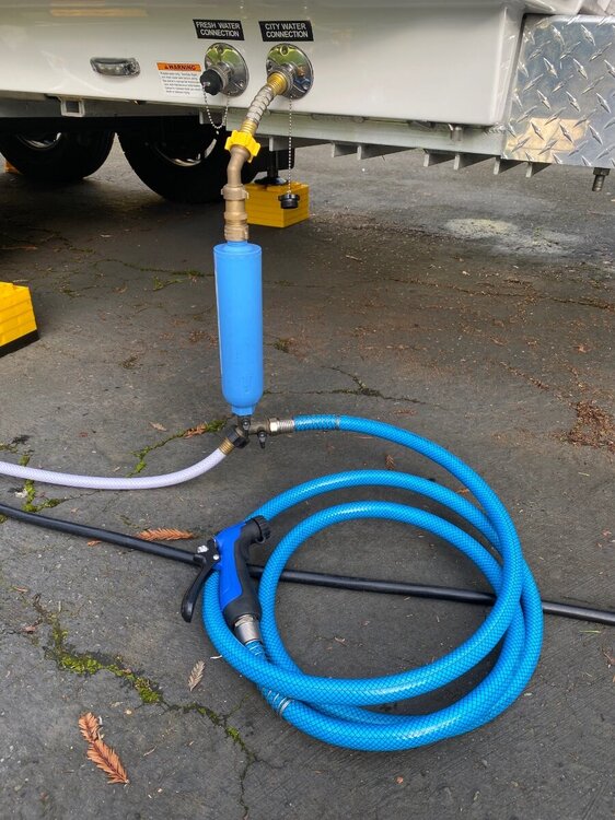

I really like the idea of having the hose connection "T" before the filter idea.  I often need a hose sprayer, but generally have little control over flow when using one of the camp ground taps directly.  I have a spare connector in my basement as shown below.  Having both the lines out with their own valve would allow use of the hand hose without putting pressure or flow into Ollie.
Thanks for waking up the idea!
Conversely, I like my Y at the spigot for max pressure to the auxiliary hose, not on the pressure regulated side.

@Snackchaser
Nice install Geoff:
Can you tell us what the devices are next to your leather plyer holder? Did you install them there or are they new locations in your 2022 Ollie?
 Also, I see two toggle witches in the upper left of your pictures. What are they for and did OTT install them?
Thanks
Maine
1 hour ago, dewdev said:
Nice install Geoff:
Thanks!  And I see how that poor quality photo could raise questions from observant folks.  Only the spirit level was installed by Oliver.
The bottom item is a 12vDC outlet for a macerator pump.
Next is a rotary switch for electric valves that are used for freshwater tank drain, boondocking and winterizing line-ups.  It’s described in the post “Electric valve control… with a twist.”
Then there is a third water-pump switch for the outdoor shower, or when filling the freshwater tank from the boondocking port.  This is described in the post “4-way pump switch for the outdoor shower.”
Above that, are labeled LED indicators for the aforementioned pump and valves.
Lastly a Levelmate with lengthened thumb screws for easy battery changing.  They do look like toggle switches!
Then my trusty pliers. . . they actually replaced quick disconnects that I found were too bulky and inflexible for my needs.
Cheers!  Geoff
