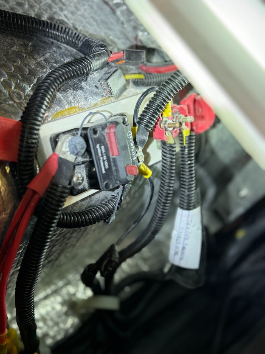

I have a 2020 and here is where it is located. It is the wire on the right (labeled in picture with notebook paper and tape). It is on the driver side. Picture is looking forward through the hatch underneath bed next to cabinet.  I disconnected and taped over the end. In the first picture the charge wire is attached in the second, I have disconnected, covered/sealed and stored next to solar shutoff.

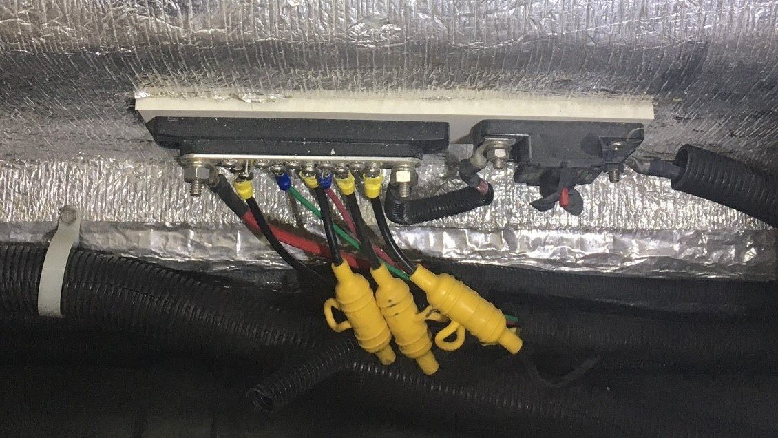

Some have reported seeing the cable split under the bathroom vanity, so perhaps you can see where the black wire branches from there. I got lucky to find mine at the +bus under the streetside bed. Notice in the picture, the black wire at the left side of the bus where I have the screw loosened.
I removed all the wiring to this bus, shortened the 3 fused + connections to the stabilizer jacks, added a more substantial + bus under the rear dinette seat for easy access. I was able to sort out all the wiring, no extra cables to the batteries, etc. In doing this, I've learned what almost every wire is for in the basement areas of Hull #113! 🤣

This is a copy of my buss, which is different than yours.

Actually they look a lot alike except yours only has the 3 stabilizer jack wires.
Did you test for power at the 7-blade adapter? You got to get a yes/no answer to this before doing anything else.
You have a fuse all the way to the right in your picture. It looks just like the one @Ray Kimsey pointed to as his Black Charge Wire. It could be yours too. You can see how your system a 2018 is somewhere between mine a 2016 and Ray's 2020. Our Oliver has none of those two-post fuses at all.

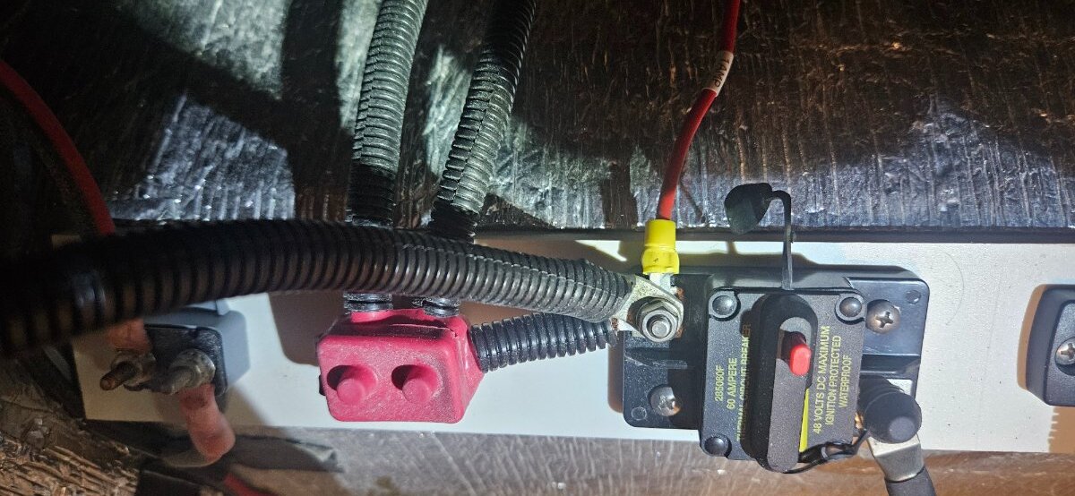

For our 2019 here's where it connects under the street side bed (hatch nearer the pantry)

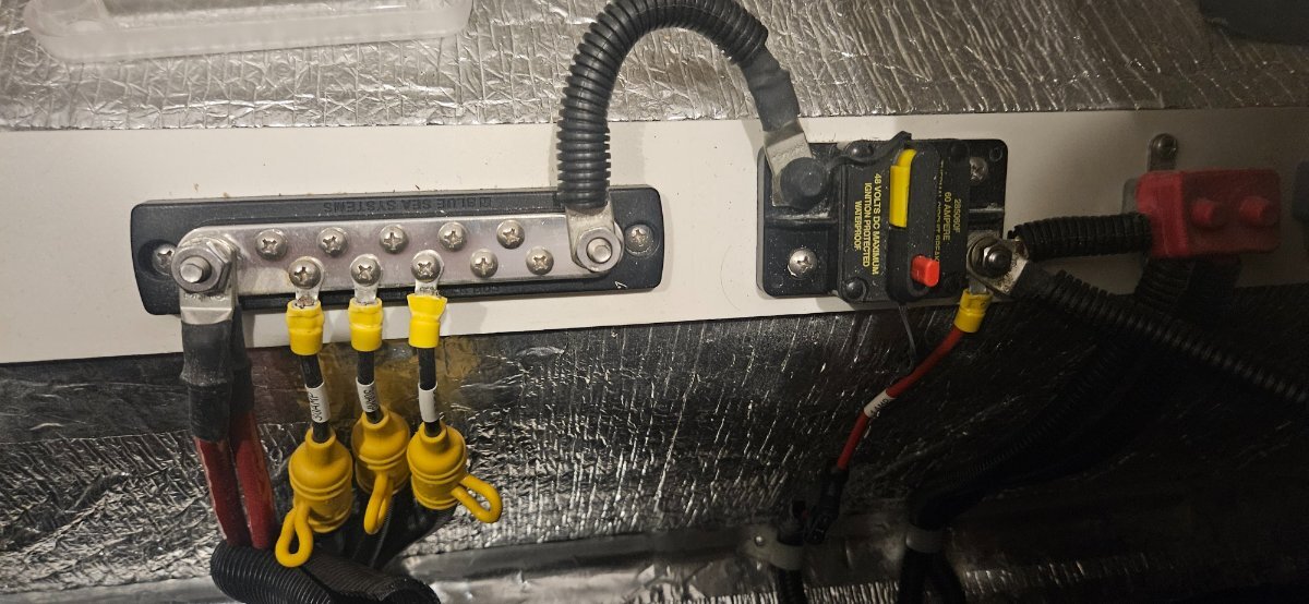

My 2018 Ollie is slightly different than yours.
In the picture below the red wire has a 1 amp fuse in line. Wht is that for?
Sorry the picture come in upside down when coping to the foruml

@dewdev that is the 1AMP fuse for the propane/leak detector in our case located under the dinette.
I think (based on a old Jason Essary email) that the black line going to the 2 button red auto reset breaker has the 7 pin charge wire. I think that is what @Galway Girl and their picture was referring to.

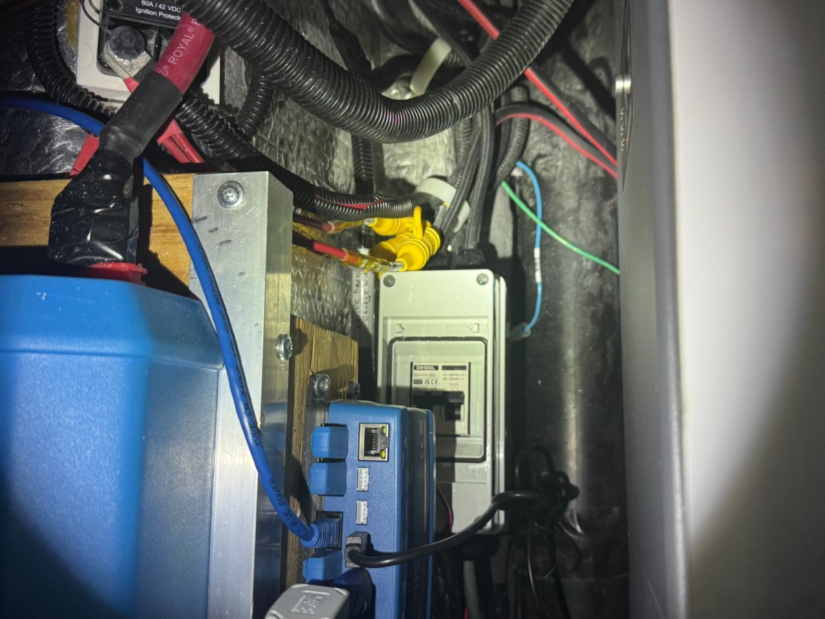

Know I have one more question. Does anyone know what these wires go to in the attached photo?
Thanks to all.
Maine
I think that is a picture of an automatic resetting breaker in the B+ path from the solar charge controller.  Both the red/black and the solid black should run up the the wall to the Solar CC.  The red/black wire eventually goes to the battery positive/B+ and the black wire ends up at the battery negative/B-.  They are zip cord wires just like a lamp cord, so you can verify my thoughts by determining if the insulation is in fact joined together as it heads up the wall under the SS bed.  I’m pretty sure they will be 8AWG wire.

Thanks @mossemi. I did confirm that they are the solar wires. I did not know that the connector was a automatic resetting breaker.
@Galway Girl. I was told by OTT that the red wire with the 1 amp fuse goes to my composting toilet fan. I believe that the propane/leak detector wire (which is likely in the corrugated wire guard) is connected to the red device with the two buttoms. I will be verifying this later today. Thanks

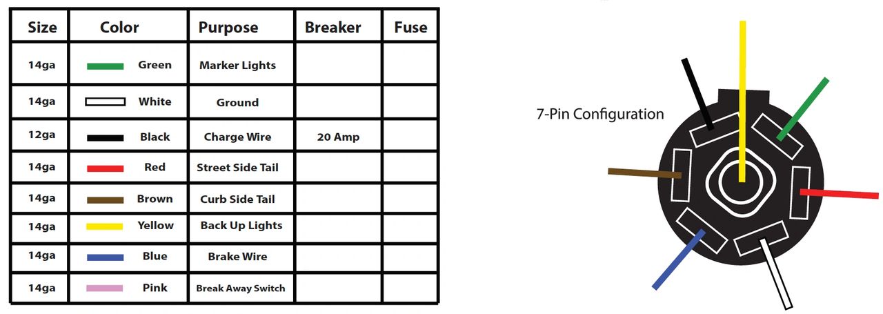

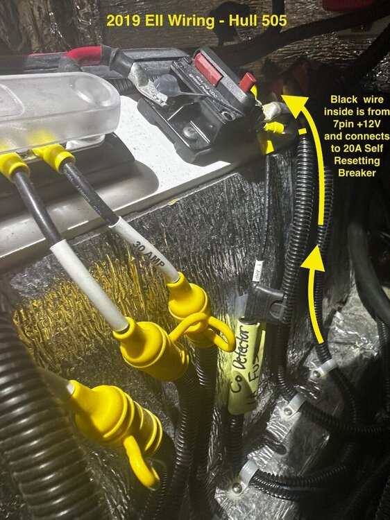

See section 7 of the article on the upgrade ...in our 2019 EII manual it shows it as a Black Charge wire as shown  in the wiring diagram and in the PICTURE below.
The reason we disconnected the wire inside the 7 pin cable was to protect the alternator.  Lithium Batteries they can "draw" charge current much faster than older AGM or other Lead Acid Batteries...so ultimately they would try to draw way more power than the truck wiring would provide.  (To install the DC/DC converter you'll run dedicated lines back to the DC/DC charger.)
Full battery upgrade is here...including the section 7 about disabling the charge wire.
https://4-ever-hitched.com/blog-articles/f/lithium-battery-upgrade
Step 7;
Disable the 7 Pin Charge Line:
We will be installing a new DC/DC charger into our Oliver EII.  But before we do that install  we need to disable the current charging wire that runs from the 7 pin cable on the tongue of the Oliver.  That 7 pin connector is the one that plugs into the back of the truck for lights, brake lights, emergency brake power.
Inside the 7 pin cable there is a BLACK wire that provides 12V (B+ )  from the truck battery/alternator B+ all the way back through the trailer, through a 20A breaker and back to the batteries via the 12V Bus bar in the trailer.
We will not be using that (Black) charge line for the trailer an longer.
We disabled that line on the 7 pin connector by putting heat shrink coating over the screw terminal on the black B+ wire conductor and also taping up the screw lead the body.  We reassembled the conductor and tested that no 12V was present on the wires inside the trailer.
Wiring Digram for Oliver EII 7 Pin
To disable the Charge Wire (BLACK) from the 7 pin, remove the cover and disconnect the wire from the connector by taping up the wire and putting it back inside the cover.  Don't cut the wire in case you need to use it in the future.
