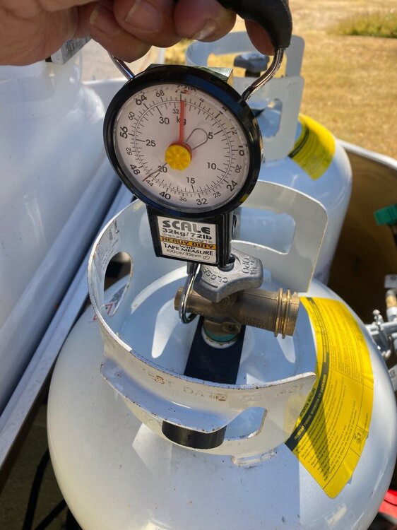

Although there are several ways to check propane tank levels, I’ve found the easiest way for me is a luggage scale. They have large hooks that balance nicely when hooked on to the fill valve, and they remember the weight so you don’t have to contort yourself to see the scale.  Mine has an analog dial with a memory needle, and thankfully no batteries.  I’d recommend these over ones with batteries that always seem to be dead when you need them.  Flame King sells a more expensive scale made for this purpose.  It conveniently reads in percentage, but it’s battery operated too.
A 30 pound tank weighs around 55 lbs when full, and about 25 lbs when empty.  A 20 pound tank is around 37 lbs full and 17 lbs. empty.  I’ve labeled my tanks with their weights and I can determine exactly how many pounds are left with the scale.  The tanks can be weighed in place with the spin-off clamp loosened, and it helps to put a stick or bar through the scale handle to lift with both hands.
I know some people swear by the Mopeka ultrasonic level detectors, and I heard the newer ones work pretty good.  But I’m still not over the problems and uncertainty of my old ones, so I’ll stick with my trusty scale for now.
Cheers!  Geoff

Great idea. Do you have a link to the luggage scale?

Like @Snackchaser, I use a luggage scale to get an accurate read on the propane level in the tanks.   I purchased a pair of Mopeka sensors and found them to be unreliable and not very accurate.  I had a couple replaced under warranty.  They also seemed to have need frequent battery replacement.  I would NOT recommend them.
Amazon has a large selection of luggage scales for about $10, that are compact and accurate.  With tare weight labelled on both tanks there is no mystery to the amount of propane when the total weight is known.
Such as: https://www.amazon.com/Etekcity-Portable-Handheld-Suitcase-Temperature/dp/B082LYC2TN/ref=sr_1_7?crid=2PAZR2PQNSA24&dib=eyJ2IjoiMSJ9.lrxtiYiAaOxFumPFwJLLfi-V2pD7fJpKxfsl6UyzsKbSFL3YNBR0L1a7Px8SBzHhhW25VLBh912CrUyahxdkUjT1pqB3pRe933JDFfDr7ZaTgoTCb1mXdfINMMhl5OU0FibEUB2mMbq_9R89XeAeSb5MhrkSnnQ5YT6uUSpTQctrjSJqa-90Rcwkt-jGQLzD4jSFjCSRtp-YFlVIJhme_3etEGEES17uG605HrMmwLGyk2YZsL2lLr-nGzZUe7jC60bztrvKDpr9oVktN97bzUFLTJ8jfQEvF9T4OU-tq1A.NFHYzomQyFXtHPcZxq8NaPUGd5FyqkWMxZL0L2YMZgw&dib_tag=se&keywords=digital%2Bluggage%2Bscale&qid=1754537940&sprefix=digital%2Blugga%2Caps%2C138&sr=8-7&th=1

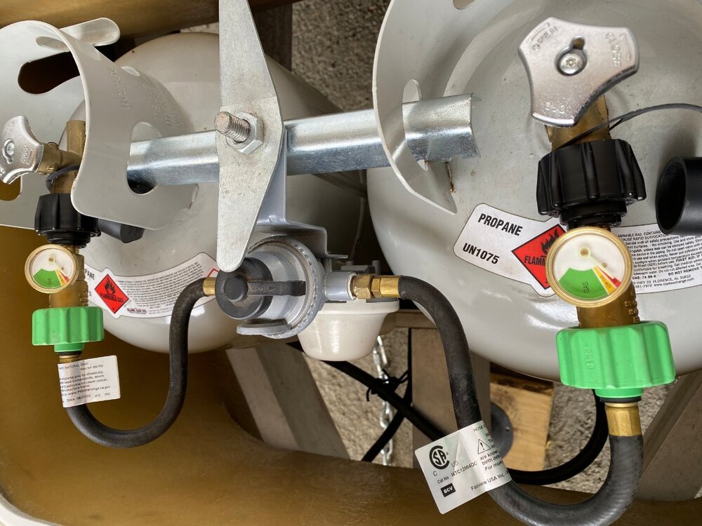

I came up with an equally inexpensive yet much simpler approach that also avoids the use of batteries.  I thought about buying the tanks with integrated gauge from Costco that @routlaw mentioned but I didn't like the thought of getting rid of two perfectly good LP tanks.  Then I saw these gauges at my local Wal-Mart for about $15.  They simply screw right onto the tank.  Just open the porthole access and peek inside to see if your tank is empty.
IMG_9583.thumb.jpeg.0aa692e943bcf31e417145be696db8fd.jpegIMG_9574.thumb.jpeg.3f22e301979e7822d72e7288cd7471cb.jpeg

I wish I could depend on that.  On my previous rig, the indicator got stuck and no longer worked.  Although it was replaced under warranty, after several months same problem.  Same thing happened on my Oliver.  Seems to be a quality issue.

Oh, the changeover regulator works fine, it's just the indicator that stops working. In essence, I just added a couple of new indicators for $30. instead of replacing the whole regulator for $75 and then have the problem happen again.

Problem solved!
