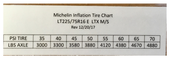

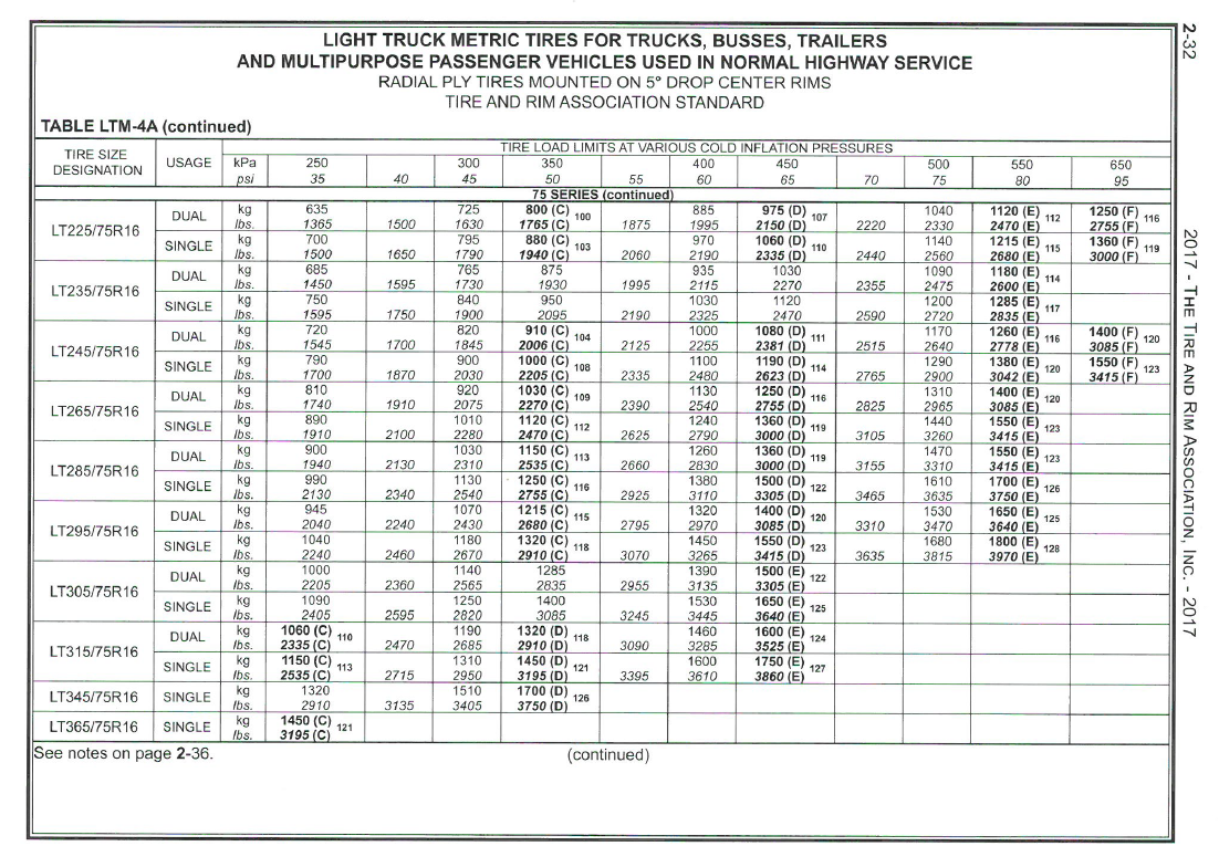

 As Ronbrink mentioned above, your shocks will wear in a bit and may help some.   With the upgrades you have your rig is set up for great off road service.  There is only one thing I can think of to amelerate your situtation.
You may want to check YOUR tire MFG Pressure/Load chart for recommended tire pressure at your actual axle loading.  If you don't know that number, please hit the scales.  At 55 PSI, I would wager that you are well over your tire MFG recommended pressure.  I recommend 40 to 45 tops for 95% of our OE2 owners weights.
GJ
GJ
We plan to replace our Dexter 5 leaf spring packs with Alcan springs during 2026, installed new shocks last year. Our LE2 is light, even after adding to Ollie's ready to camp weight during 2025, should be around 5100 pounds with empty tanks.
Been running 40PSI in Ollie's tires during 2025 and not having issues with trailer contents shifting.
This air pressure chart came from a previous thread here.
4DBF1AF1-D8F9-42F4-97BB-24DE77E01E52.png.f6ab8c859ee3c6b6ac4d84007028c2ea.thumb.png.3e528082d0d02da1e466f47eab9f4c46.png
Edited by rideandfly
Dexter 5 leaf?  Typo?  Good that you are planning to change your springs before their roadside failure.
The above generic chart provides general industry standard info.   The Michelin provided chart for these tires also require at least 35 PSI.   If an owner can not find a chart for their manufacturer, use of the above could be pretty good guidline.  But with the internet the actual data for your tires is better.  Here is the chart for mine OE2 tires:
For talking purposes, a typical 6,000 pound OE2 will have a tongue weight of about 580 pounds.  That calculates to about 2720 pounds for each axle.  From the chart we are off the chart.  One could mathamatically postulate that at the example axle weight we should use about 27/28 PSI.  Not the case.  The pressure shown on the left side is the minimum pressure to be used.
But for the purpose of lowering running drag, and to give us more safe warning time when a tire is failing, most of us add some pressure.  Likewise, I also run my OE2 with 40 to 45 PSI when on highway.  If serious off roading I lower it further to 35 as per the charts.  But if conditions dictate, for short duration I would not hesitate to go below the 35 PSI.  And have twice with our Ollie.
SUGGESTION:  I like many other owners, believe that having a 20/18 volt air compressor (And a good plug kit) are musts when traveling far or traveling off road.
GJ

Secure the items that bounced around and set correct tire pressure! 55 PSI is only correct if you are carrying about 8,000 LBS GTW! We run at 45 PSI.😎
