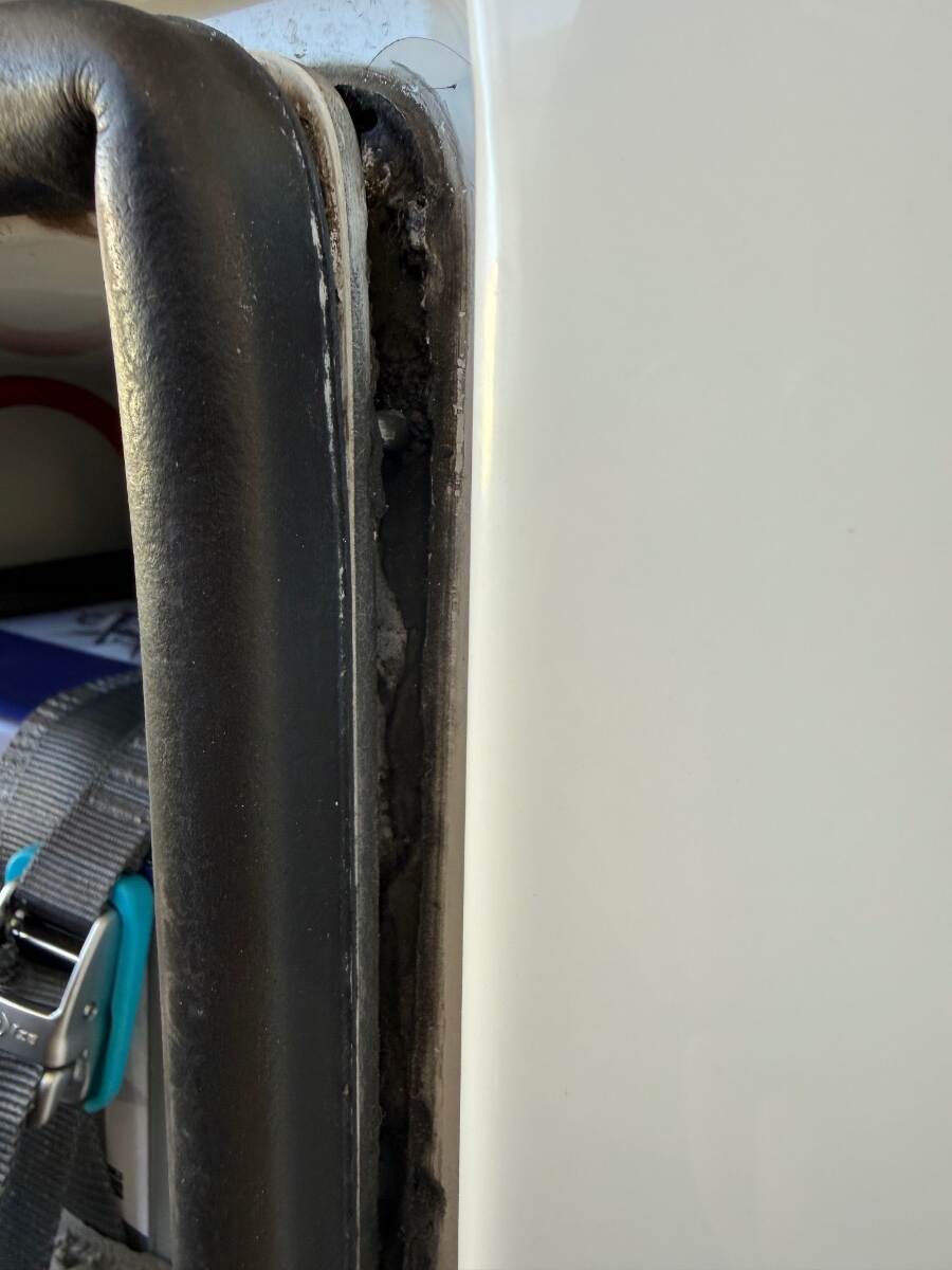

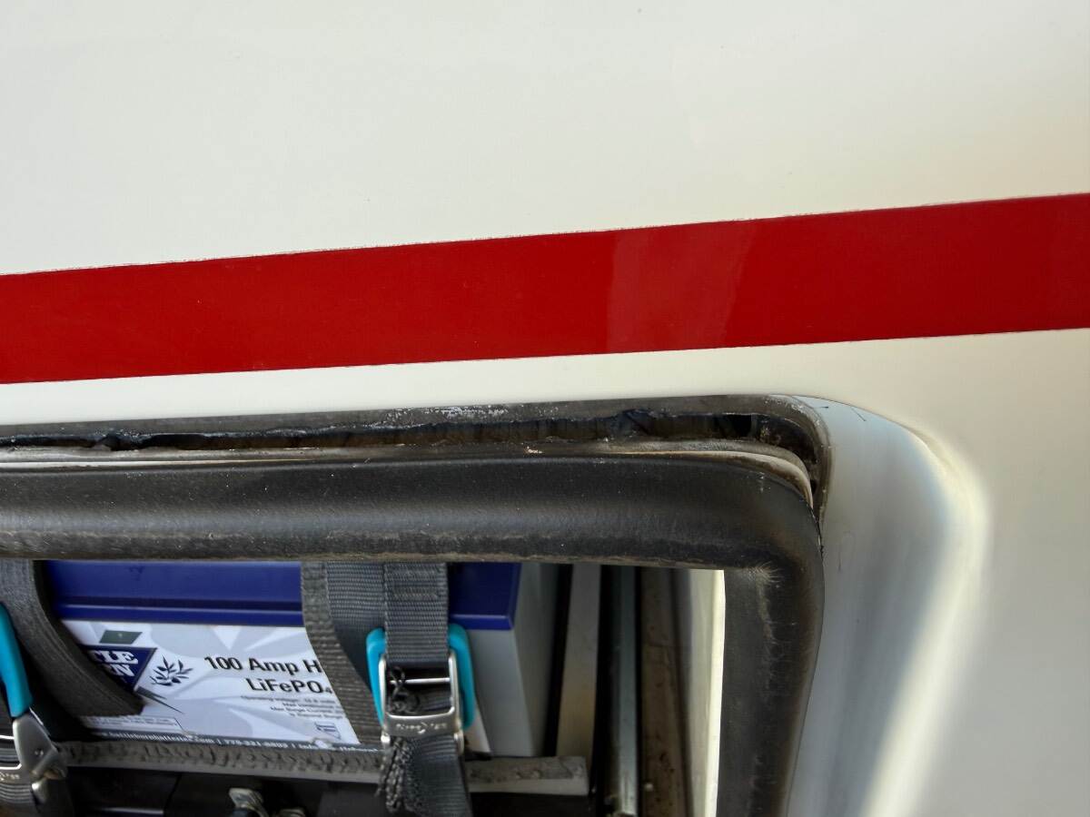

This is an issue I have not seen before.  While checking my trailer this morning I noticed that my battery box is separating from the hull.  I don’t know when this started.  When we replaced my AGM batteries in Dec ‘20 I did not notice this.  Once the four AGM’s were out I did a lot of cleaning and work on the tray and I feel that I would have noticed it then if it was happening.  I will submit a trouble ticket with Oliver to see what they think.  Not sure how this would be repaired.
If you have an older trailer that carried those heavy AGM batteries I would check for cracks or separation.  Here are some pictures, what does everyone think?

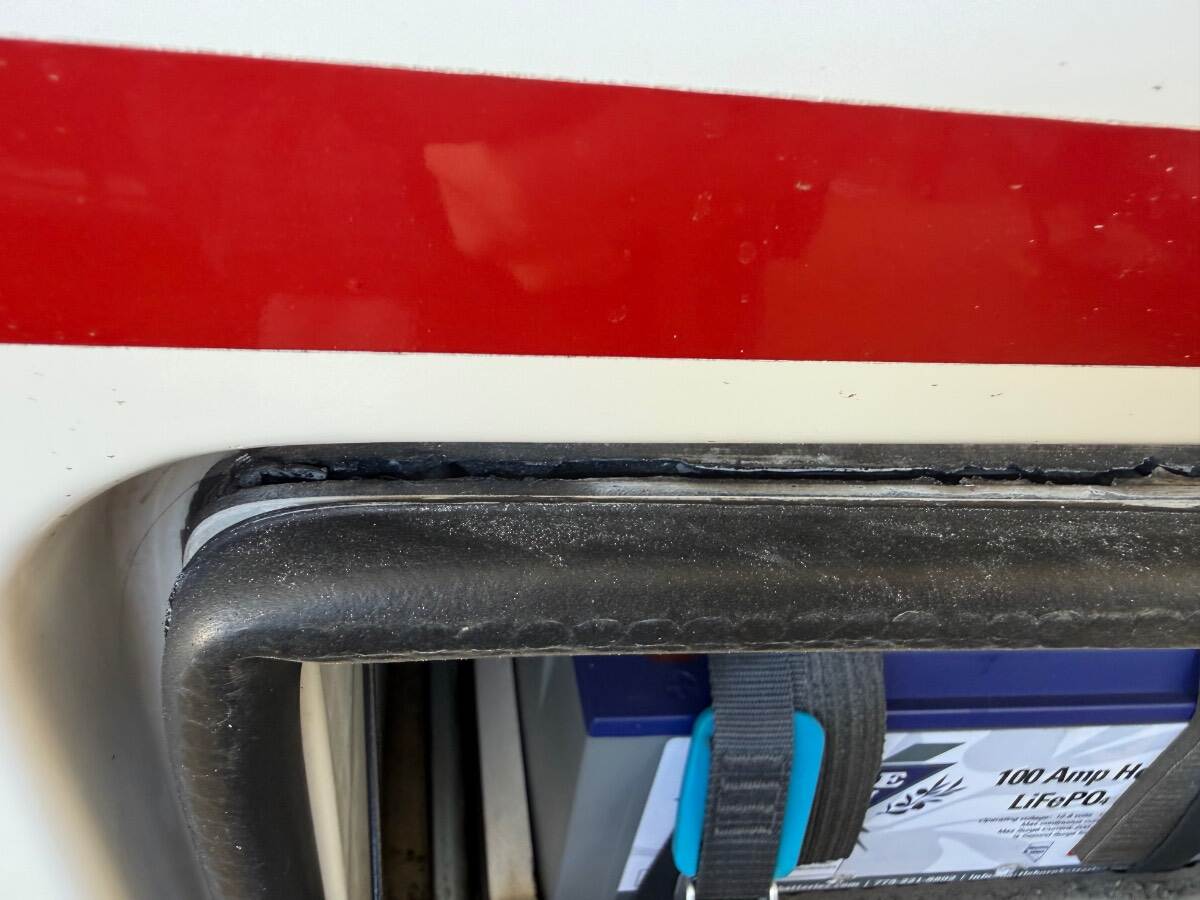

Here is the right side:
Here are a couple of the top:
Left side top:

A thread on "cracks" at and/or near the battery box was posted a number of years ago.  But, as I recall, these cracks were generally in the exterior hull right at the corners of the battery box.
Have you looked at the "support post" that is between the hulls directly under the battery box (approximately in the bottom center of the box)?

Wow - good research!
I forgot about that thread - it appears to be exactly the same problem.
Maybe Galway Girl would be willing to do the repair for you?😉
Mike,
Please turn a ticket in to Oliver Support as category of structural failure/battery box.
My repair has held since 2022 when I turned in the ticket.
I followed specific Oliver instructions on my repair as I was too far from the Factory for a repair.
I've also had Oliver inspect each time I go back for service...and so far it's held in place.
Craig

Craig, yes I turned in a ticket this morning.  Reading through what you did I might be marginally able repair it.  I’ll see what Oliver service says when they come in to work.  I would like to talk with you when you have time.  I saw your PM.  Thanks.  Mike

And, I remembered that Craig @Galway Girl wrote about this same issue and making the repair. From his post above, "My repair has held since 2022" (TG) which is two years prior to when our friend Lance installed Alcan Springs on his Oliver, the first.
Keep an eye on your battery door and I will do the same. The question is, what causes the failure? Is the battery base secure?

Yes, I do have a recent install of ALCAN springs.  Looking at the separation it appears to me that this is not new.  I have also learned of other instances of this (Galway Girl being one of them) that predate any ALCAN spring installations.  You gave good advice to Crazy Horse 🤪.

This reminded me of an older thread (see link) that addressed battery box support bracket and bolts.   Recommended reading for those that have not already addressed, it might help avoid a loose battery box.   In my case, both nuts & bolts of the support were very loose when I checked them, and the holes were drilled poorly by the factory.   I drilled a new “clean” hole and installed 3 stainless bolts, washers and nylon nuts.   A quick and easy task.
   https://olivertraveltrailers.com/forums/topic/6112-battery-box-support-bolts-missing
 I recommend caution when sliding out the battery tray, be gentle and avoid leaning on the tray.   It puts an excessive force on the rivets and support bracket, especially if you have AGM batteries.

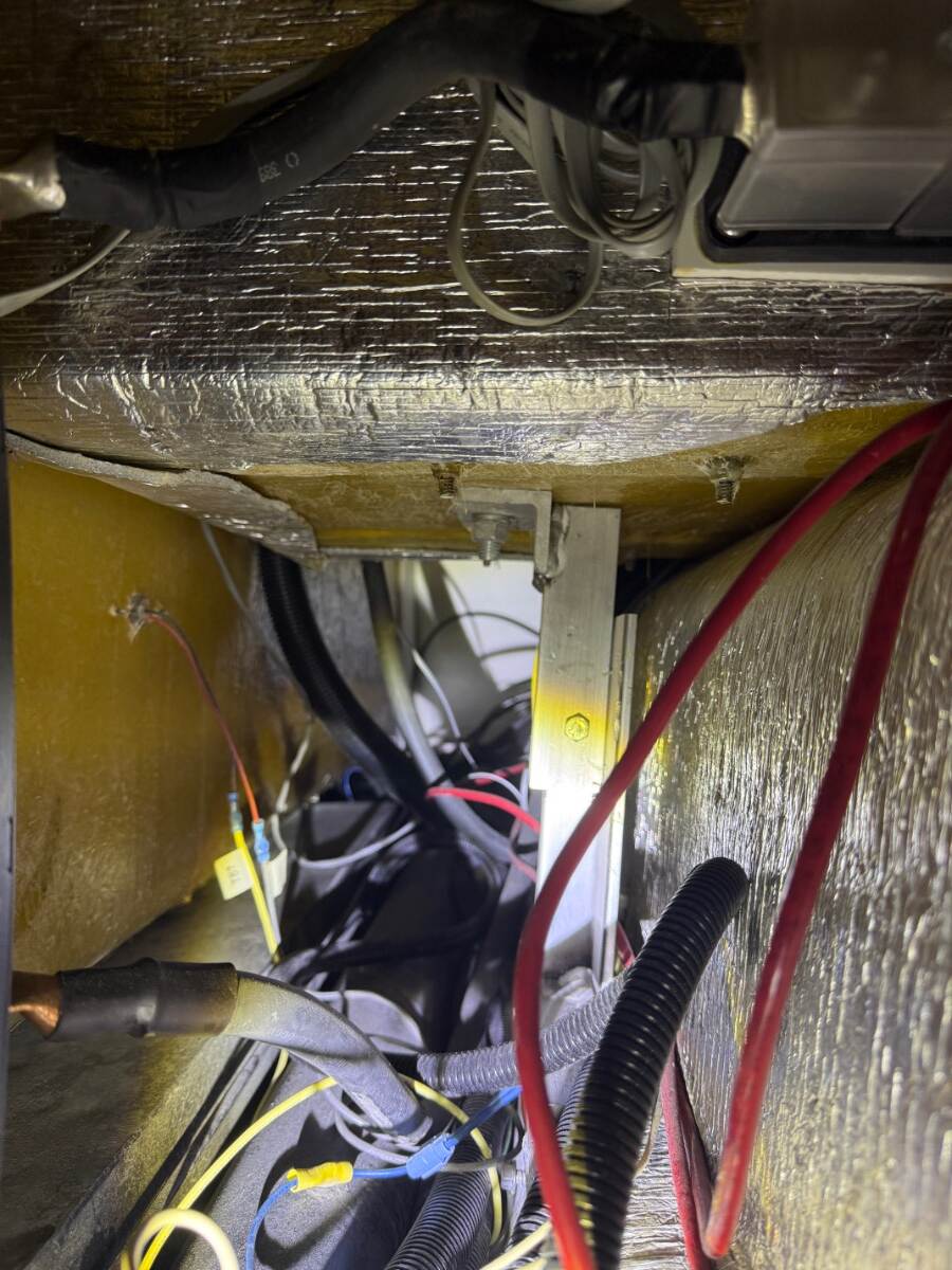

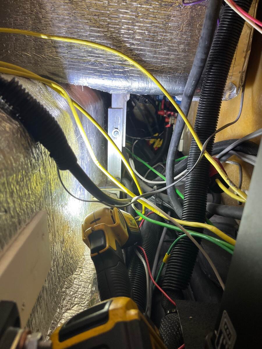

The Oliver response to my trouble ticket was to check and send pictures of the brace inside the trailer.  I did and the response was that I could probably use a good adhesive to repair it since the brace holding up the box looked good.  I didn’t like that answer so I asked to be sent over to service for some advice.  Mike S in service said they use rivets to repair and also inspect the support bracket.  I’m debating whether to try this myself or just make a trip to TN.
Unlike Galway Girl, my bracket only has one bolt and it is in an adjustable slot.
Other side:
It’s interesting that the box is leaning out from the trailer and the bolt is at the bottom of the slot.  When I pull the battery tray out, the box moves out more but every so slightly, less than 1/16”.  I would think that the sag would be the other way around, leaning into the trailer since the weight is over the support more than 99% of the time.
Edited by Mike and Carol
I SUSPECT that the lean out is to facilitate water drainage should a seal fail.  I support your thought that the advantagee of a slight lean in would out-weigh potential negatives of a seal failure.
The amount of the lean out could for sure facilitate the failure of the rivets.  The support member as you have:
with just one bolt (as pictured) could easily allow the top of the "stiff leg" to move out there by increasing lean and failure.  Suggest adding a second bolt above the shown one to better fix (Lock in)  the angle of tilt once properly adjusted.

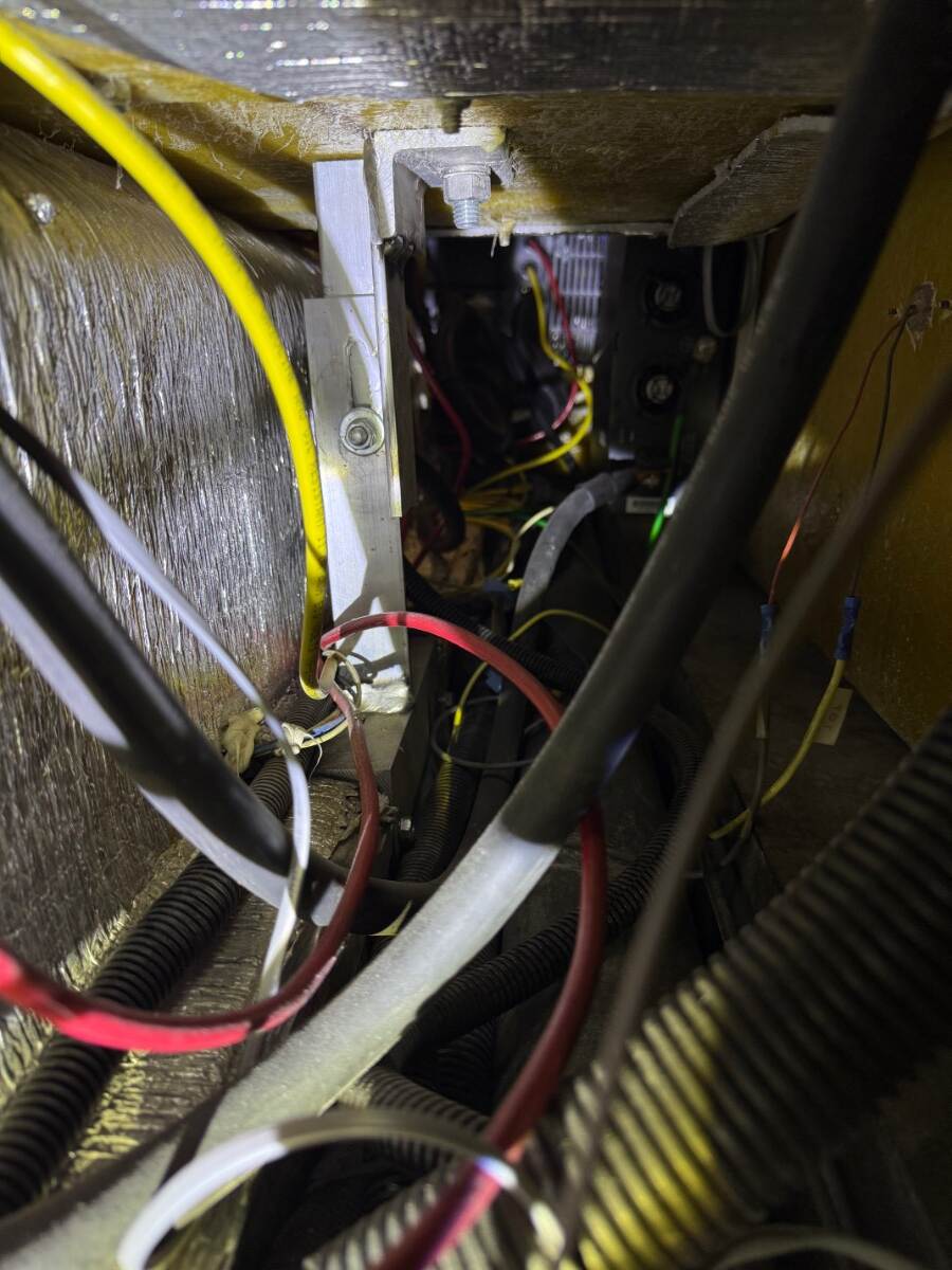

Wish I had looked further into this last month when I added a 3rd battery! I can be so dumb, took this pic at that time. The bolt and nut where fine but question is, did the mount sag, should the bolt be tightened higher up in the slot? The main bolt, coming down from the bay was tight which I removed and replaced with a 1/2” eye bolt to hold battery straps and cable lock. It felt firm as I yanked on the battery straps several times.

CAUTION: You should determine cause for your separation. Check your support beam below the box. View it from both sides, streetside bed (see my picture above) AND look from under the rear dinette seat.
OTT forgot a weld on one of my jack brackets. They also forgot to finish this support beam install! Hard to believe, but true. I've compared ours with some of Oliver friends. The others have two bolts which is mandatory! I have to get in there again, drill and add a second bolt!
With batteries out, most of the weight off the battery tray, from underneath see if there is movement of the support beam. I plan to remove my batteries AGAIN. Then get a bottle jack under there to see if the support can be raised just a little. The fact that this single bolt is at the bottom of the groove shows it's at the lowest setting. Likely the beam/tray should be raised some for proper support. Then I'll tighten the single bolt installed, drill a second hole through the top of the slot to add a 2nd bolt, then torque down both.
Thank goodness we have no door separation, but those who have should investigate the support beams below. Some have reported missing nuts, or nuts falling off the bolts. (How does a Nylok nut fall off a bolt? It doesn't. It was likely laid there never threaded on. Go figure.)
