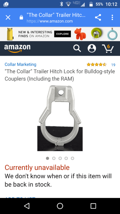

Moderators SeaDawg Posted April 5, 2017 Moderators Share Posted April 5, 2017 We've used both a collar lock, and a lock that fits into the place where the hutch ball would be towing. It's dark now. I could take a few photos tomorrow. Check etrailer and Amazon for bulldog hitch locks. The collar lock circles the opening prongs on the hitch, traveling, or at rest. This prevents the hitch from being opened at a rest stop. The other lock is used when camped. Sherry 2008 Ram 1500 4 × 4 2008 Oliver Elite, Hull #12 Florida and Western North Carolina, or wherever the truck goes.... 400 watts solar. DC compressor fridge. No inverter. 2 x 105 ah agm batteries . Life is good. Link to comment Share on other sites More sharing options...

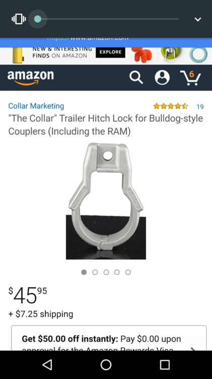

Moderators SeaDawg Posted April 5, 2017 Moderators Share Posted April 5, 2017 The collar like is like this one 2008 Ram 1500 4 × 4 2008 Oliver Elite, Hull #12 Florida and Western North Carolina, or wherever the truck goes.... 400 watts solar. DC compressor fridge. No inverter. 2 x 105 ah agm batteries . Life is good. Link to comment Share on other sites More sharing options...

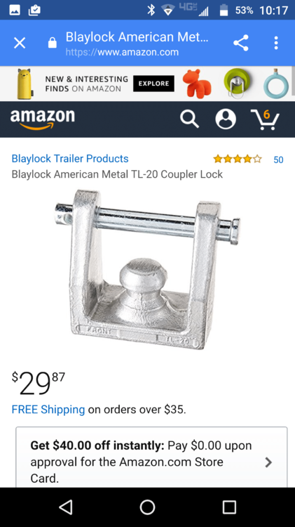

Moderators SeaDawg Posted April 5, 2017 Moderators Share Posted April 5, 2017 Hitch lock, when camped is something like this... 2008 Ram 1500 4 × 4 2008 Oliver Elite, Hull #12 Florida and Western North Carolina, or wherever the truck goes.... 400 watts solar. DC compressor fridge. No inverter. 2 x 105 ah agm batteries . Life is good. Link to comment Share on other sites More sharing options...

Moderators SeaDawg Posted April 8, 2017 Moderators Share Posted April 8, 2017 I found the collar lock we use , both while towing and camped, on Amazon. When camped, we add the hitch lock above. https://www.amazon.com/Collar-Trailer-Bulldog-style-Couplers-Including/dp/B00HL2NM0K 2008 Ram 1500 4 × 4 2008 Oliver Elite, Hull #12 Florida and Western North Carolina, or wherever the truck goes.... 400 watts solar. DC compressor fridge. No inverter. 2 x 105 ah agm batteries . Life is good. Link to comment Share on other sites More sharing options...
John E Davies Posted April 8, 2017 Share Posted April 8, 2017 Hitch lock, when camped is something like this… That's a Blaylock and it gets good reviews, but the body is forged aluminum and even easier to saw through than mild steel. Do you worry about that? I know any lock can be defeated, but using aluminum for the main part seems dubious, at best. https://www.amazon.com/Blaylock-American-Metal-TL-20-Coupler/dp/B000CEFWO8 As an aside, all the Blaylock stuff seems to be made by blind rednecks with angle grinders and 40 grid sanding pads. They exhibit no signs of quality at all, in terms of the finish and appearance. This is kind of at odds with the beautiful appearance of an Ollie, tho that shouldn't matter for a lock. Thanks. John Davies Spokane WA SOLD 07/23 "Mouse": 2017 Legacy Elite II Two Beds, Hull Number 218, See my HOW TO threads: Tow Vehicle: 2013 Land Cruiser 200, 32” LT tires, airbags, Safari snorkel, Maggiolina Grand Tour 360 Carbon RTT. Link to comment Share on other sites More sharing options...
Raspy Posted April 8, 2017 Share Posted April 8, 2017 I'm still debating if it might be better to pull the cross bolt in the telescoping tongue and just pull out the bulldog coupler and put it away. That would leave an open hole where there used to be a coupler. I'll check tomorrow, but I wonder if a 1 7/8" ball would slip up into the closed bulldog hitch. If so, "The Collar" could be easily defeated. Also, a hidden switch on the front jack power wire, to disable it, would make it much harder to hook up. Another idea is to tie a string to the emergency breakaway switch and tie the other end to one of the wheels, or a big nail in the ground. After moving about a foot, the brakes would lock. Of course, the trailer would already be hooked up, but it wouldn't be going anywhere and there would be a big commotion. The coupler lock is the first line of defense and is right out there for the bad guys to see. A good deterrent. John "I only exaggerate enough to compensate for being taken with a grain of salt." LE2 #92 (sold), Black Series HQ19 Link to comment Share on other sites More sharing options...
Moderators SeaDawg Posted April 8, 2017 Moderators Share Posted April 8, 2017 John Davies, I totally agree. The casting on the photo I posted of the hitch lock is terrible. Our ten year old lock, of undetermined manufacturer, looks better, but is probably aluminum as well. In conjunction with the collar lock (stainless, not hardened), it's been ok for nine plus years, but that's like lightning rod theory. It works, til it doesn't. Raspy, I don't know if a smaller ball would fit, if the hitch lock were cut off. Maybe. I do like the simplicity of the Gus Hill bull lock that Buzzy originally posted, and John Davies referenced. It's a hardened aluminum, but still aluminum. And I love puck locks. Here's a working link https://gushill.com/product/the-bull-bulldog-hitch-lock/ It's certainly more attractive, but I'd still want the collar lock for transit. I know all locks can be broken, with time. Most of us just want to make our trailer time consuming to steal, and send the guy further down the road... At home, highly visible cameras add an extra deterrent. We recently bought a gen 3 spot, not just for theft tracking, but for peace of mind when traveling. Our daughter followed our boat on the last long trip on a rental transponder, and it gave her some confidence. Gen 3 spot can also transmit an sos in areas where you don't have cell service, as I understand it. We haven't tried that yet. Hope we never have to. Sherry 2008 Ram 1500 4 × 4 2008 Oliver Elite, Hull #12 Florida and Western North Carolina, or wherever the truck goes.... 400 watts solar. DC compressor fridge. No inverter. 2 x 105 ah agm batteries . Life is good. Link to comment Share on other sites More sharing options...

John E Davies Posted April 11, 2017 Share Posted April 11, 2017 I’ll check tomorrow, but I wonder if a 1 7/8″ ball would slip up into the closed bulldog hitch. If so, “The Collar” could be easily defeated. Buy a 2 inch steel ball here: ... https://www.amazon.com/Inch-Chrome-Steel-Bearing-Ball/dp/B0074VCP8S/ref=pd_sbs_328_2?_encoding=UTF8&pd_rd_i=B0074VCP8S&pd_rd_r=3M8VRMDXW2QG0GNP4A8A&pd_rd_w=86Cm8&pd_rd_wg=vvVu4&psc=1&refRID=3M8VRMDXW2QG0GNP4A8A Insert the ball into your coupler, then close and lock it. Ta DA! Talk about layers of protection. Nobody would see that coming.... BTW I love your idea about anchoring the break-away lanyard to a fixed object. I would love to see the expression on a thief's face when the trailer brakes lock up hard. I'll take your "switch in the front jack wire" idea to the next level. Install a hidden unlabeled toggle switch in the main power wire coming off the fuse for the entire jack circuit, inside the cabin. Run all the jacks down and flip the switch. Or just remove the fuse. All three jacks will be disabled in the extended position. I am adding all this cool MacGyver stuff to my Oliver Honey Do List. John Davies Spokane WA 1 SOLD 07/23 "Mouse": 2017 Legacy Elite II Two Beds, Hull Number 218, See my HOW TO threads: Tow Vehicle: 2013 Land Cruiser 200, 32” LT tires, airbags, Safari snorkel, Maggiolina Grand Tour 360 Carbon RTT. Link to comment Share on other sites More sharing options...
