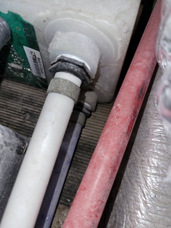

GarryandKristi Posted November 16, 2021 Posted November 16, 2021 I can confirm that our Elite 2 has the “new” configuration of pump suction. We have hull no. 372 with a pickup date of August 2018. There is a fitting on the top of the tank about 1 foot from the aft end with apparently a suction tube extending into the tank. This is in addition to the 2 tubes on the side at aft end for fill and drain functions. The line at the top routes to the suction side of the pump so is obviously the suction tube. On a recent dry camping trip, we experienced cavitation at about 10% indicated on the level meter. I think 13% was the last good reading and at at about 8% could not draw anything (from memory and don’t exactly remember resolution increments of level meter). When draining (and raising front end) it seemed like a substantial amount of water drained, but I did not measure. Probably no more than 5 gallons. 3 Garry and Kristi Apex, NC 2018 Oliver Elite II Hull 372 TV 2015 Ram 1500 3.0 L EcoDiesel

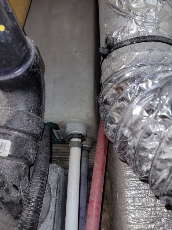

Alberta and Randy Posted March 3, 2022 Posted March 3, 2022 We recently purchased a 2015 LE2 and I don't believe, best I Can see, that this fresh water tank mod has been performed yet. Before I reach out to Oliver Service per Matt's invitation, can someone look at the photos I'm going to attach, and confirm? I've watched the videos and read the descriptions... I'm almost certain we need this done. There is no access on the top of the tank that I can see. Thanks! Alberta Alberta & Randy 2015 LE II / 2016 Chevy 2500 WT
Moderators SeaDawg Posted March 3, 2022 Moderators Posted March 3, 2022 @Alberta and Randy, Oliver will perform the update for you at no charge if you take the trailer to Hohenwald. Open a service ticket, with hull and vin #. They will know if the update has been done, or not, at their facility. 4 2008 Ram 1500 4 × 4 2008 Oliver Elite, Hull #12 Florida and Western North Carolina, or wherever the truck goes.... 400 watts solar. DC compressor fridge. No inverter. 2 x 105 ah agm batteries . Life is good.
John E Davies Posted March 3, 2022 Author Posted March 3, 2022 29 minutes ago, Alberta and Randy said: We recently purchased a 2015 LE2 and I don't believe, best I Can see, that this fresh water tank mod has been performed yet. Before I reach out to Oliver Service per Matt's invitation, can someone look at the photos I'm going to attach, and confirm? I've watched the videos and read the descriptions... I'm almost certain we need this done. There is no access on the top of the tank that I can see. Thanks! Alberta That tank has not been updated, I annotated your last pic so you can see where the new plumbing parts will be installed, roughly. John Davies Spokane WA 1 1 SOLD 07/23 "Mouse": 2017 Legacy Elite II Two Beds, Hull Number 218, See my HOW TO threads: Tow Vehicle: 2013 Land Cruiser 200, 32” LT tires, airbags, Safari snorkel, Maggiolina Grand Tour 360 Carbon RTT.
Alberta and Randy Posted March 3, 2022 Posted March 3, 2022 Thank you John for the confirmation, much appreciated! 2 Alberta & Randy 2015 LE II / 2016 Chevy 2500 WT
Moderators topgun2 Posted March 3, 2022 Moderators Posted March 3, 2022 Alberta and Randy - Both SeaDawg and JD are correct. Your tank should look something like the picture below when it is done. Note that there is no issue with using your tank as it is presently configured with the exception that you can not use ALL of the contents of that tank. 2 2 2023 Ford F150 Lariat 3.5EB FX4 Max Towing, Max Payload, 2016 Oliver Elite II - Hull #117 "Twist" Near Asheville, NC
