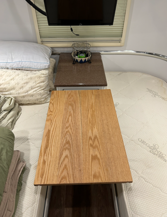

Overland Posted January 28, 2020 Author Posted January 28, 2020 I'd love to see photos once you've got your table top. Sounds like it will be pretty nice.
Moderators SeaDawg Posted January 28, 2020 Moderators Posted January 28, 2020 (edited) I'm looking forward to seeing the photos, too. Have to say, I'm always a bit jealous when I see another Lagun table install. 🤫 This year's budget and time is devoted to solar upgrades and maintenance projects on the boat and the trailer. But, I would so love a 24 inch table that folds out to 48 in the small dinette, that I could elevate and use as a counterheight work station when prepping or working on projects. Plus, I would love to add a wood tabletop, vs the original black fiberglass top. One of these days, maybe Santa will figure it out. 🎅 Sherry Edited January 28, 2020 by SeaDawg 1 2008 Ram 1500 4 × 4 2008 Oliver Elite, Hull #12 Florida and Western North Carolina, or wherever the truck goes.... 400 watts solar. DC compressor fridge. No inverter. 2 x 105 ah agm batteries . Life is good.

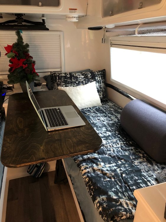

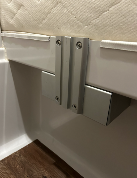

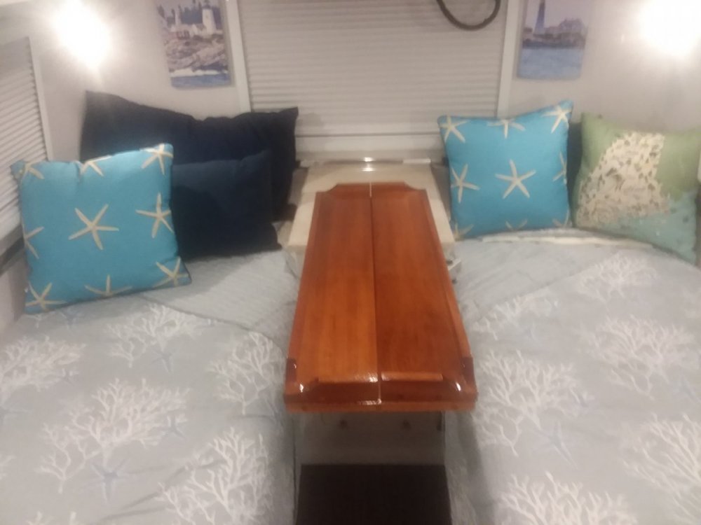

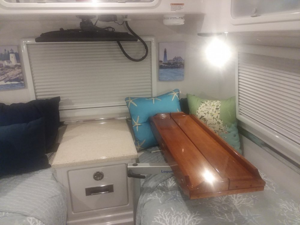

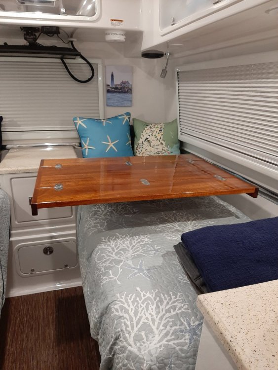

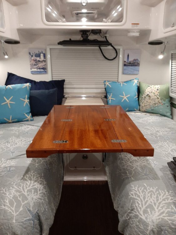

Mattnan Posted February 10, 2020 Posted February 10, 2020 Here are some photos. When we travel we fold up the top and lower it on top of the bed and tighten up the adjustments. I surround the top with bed pillows incase vibration loosens the adjusters. That has not happened. We have the table set up all of the time. Overland did a great job with this. Thanks for sharing. Our custom table is a little bit narrower than Overland's. We mocked up the size we wanted using cardboard. 2 4 3
Moderators SeaDawg Posted February 10, 2020 Moderators Posted February 10, 2020 Mattnan, your table is beautiful ! Great installation, and your local craftsman is just that--a true craftsman. The bookmatched grain is so lovely. What finish did he/you use on the tabletop? Does he usually work on boats? Thanks for the photos. I think I'll go sit in the trailer to finish my coffee, and try to figure out how we could do this in the small dinette area, someday. (Sigh) Sherry 2008 Ram 1500 4 × 4 2008 Oliver Elite, Hull #12 Florida and Western North Carolina, or wherever the truck goes.... 400 watts solar. DC compressor fridge. No inverter. 2 x 105 ah agm batteries . Life is good.
Overland Posted February 10, 2020 Author Posted February 10, 2020 Man that looks nice. I might have to go back over mine with a high gloss finish. Is that spar varnish?
Mattnan Posted February 11, 2020 Posted February 11, 2020 Hi, Thanks for the nice comments. As I am responding,we are camping at James Island campground 4 miles to Charleston, SC. This is a terrific place with very friendly folks. This is our first stop on a 4 month trip that will lead us to the Keys, Florida gulf coast, New Orleans, Natchez, Nashville, the Oliver Rally then back to our home in mid-coast Maine a summer on the ocean and boating. This is our first trip. So far it is a blast. Our local craftsman obtained the mahogany from a local wooden lobster boat and lobster yacht builder, Peter Cass the owner of John's Bay Boats. They are located near our home. Our craftsman has a relationship and has done a number of projects for Pete Cass. Our craftsman did a terrific job on our home update and new barn. He is truly a craftsman. Great guy. He did use marine varnish. It takes a while to cure and harden. We are very pleased with the results.

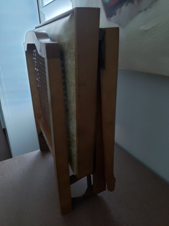

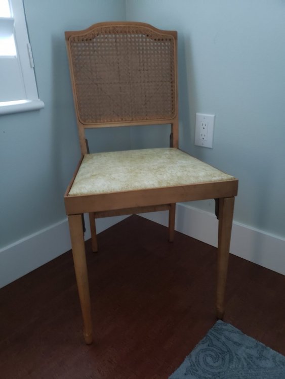

Moderators SeaDawg Posted March 29, 2020 Moderators Posted March 29, 2020 (edited) 7 hours ago, Overland said: We haven’t tried it, but I don’t see why you couldn’t use a camp chair in the aisle for someone, so long as the chair is tall enough. Back in the day, Airstream sold some pretty cool wooden "Legomatic" folding chairs for their trailers. I still see them once in awhile on ebay, etsy, and some mid century resale sites. They would probably fit in that aisle, as they have a fairly narrow seat and footprint. They fold flat to something like 18 x 6 x 16. I use mine as extra chairs when we have a big group for dinner at home. Never tried it in the trailer. Mine are still rocking that 60s gold marble look vinyl seat upholstery. 😄 Edited March 29, 2020 by SeaDawg 1 2008 Ram 1500 4 × 4 2008 Oliver Elite, Hull #12 Florida and Western North Carolina, or wherever the truck goes.... 400 watts solar. DC compressor fridge. No inverter. 2 x 105 ah agm batteries . Life is good.

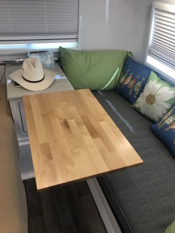

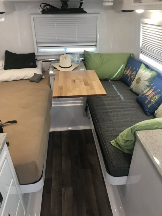

chuckstovall Posted March 30, 2020 Posted March 30, 2020 I got so busy finishing my project before trying to see some spring training baseball early in the month that I neglected to post my pics. Thanks Overland and ALL for the suggestions. I initially fabricated a bigger table top but it was bigger than I needed and the finish didn't come out as hoped, so ended up buying a workbench top from Home Depot. I was able to use it on my 13 day trip from home in Colorado to Mesa, AZ and back. Very happy with the results. Since it is just me in the trailer, the size works. If there were 2, perhaps a bit to small. PS - saw spring training game Tuesday. Wednesday rained out. Thursday rained out and minutes later got word that MLB had cancelled the rest of the spring training season due to the COVID-19. 😞 There's always next year! Go Rockies! E6677BB9-5C8C-41B6-AD36-75D63147A3CE.heic 6D37C146-D66F-4FDE-B970-4CDEF60C6D96.heic 3
beaker Posted March 31, 2020 Posted March 31, 2020 (edited) Chuck, The table looks great. I hope you don't mind, I re-posted the pictures in a format that more people will be able to view online without having to download them. Edited March 31, 2020 by beaker typo 3
Moderators mossemi Posted March 31, 2020 Moderators Posted March 31, 2020 Thanks beaker and Chuck. The table looks very nice. Mossey 1 Mike and Krunch Lutz, FL 2017 LEII #193 “the dog house”
