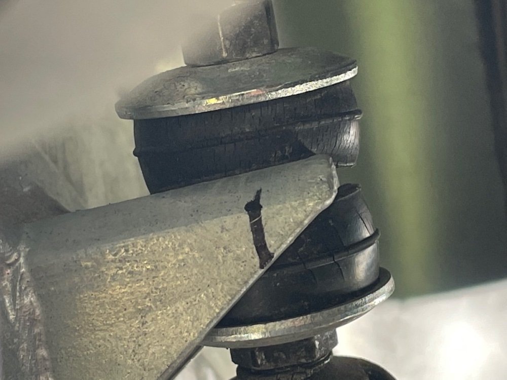

GarryandKristi Posted June 28, 2020 Posted June 28, 2020 (edited) Our OEII is less than 2 years old and all shock bushings are pretty severely cracked - probably have been that way for some time. Trailer has about 6,500 miles on it. Nothing off road or weird. Edited June 28, 2020 by GarryandKristi Garry and Kristi Apex, NC 2018 Oliver Elite II Hull 372 TV 2015 Ram 1500 3.0 L EcoDiesel

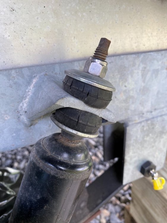

John E Davies Posted June 28, 2020 Author Posted June 28, 2020 (edited) 12 hours ago, GarryandKristi said: Our OEII is less than 2 years old and all shock bushings are pretty severely cracked - probably have been that way for some time. Trailer has about 6,500 miles on it. Nothing off road or weird. Maybe the nuts were overtightened? Compare them to the second picture in this thread. They should be squeezed to eliminate any gaps, plus a little bit more, but not super tight. John Davies Spokane WA Edited June 28, 2020 by John E Davies SOLD 07/23 "Mouse": 2017 Legacy Elite II Two Beds, Hull Number 218, See my HOW TO threads: Tow Vehicle: 2013 Land Cruiser 200, 32” LT tires, airbags, Safari snorkel, Maggiolina Grand Tour 360 Carbon RTT.
GarryandKristi Posted July 6, 2020 Posted July 6, 2020 On 6/28/2020 at 9:15 AM, John E Davies said: Maybe the nuts were overtightened? Compare them to the second picture in this thread. They should be squeezed to eliminate any gaps, plus a little bit more, but not super tight. John Davies Spokane WA Likely overtightened. Looked pretty “squeezed” when I last looked. 1 Garry and Kristi Apex, NC 2018 Oliver Elite II Hull 372 TV 2015 Ram 1500 3.0 L EcoDiesel

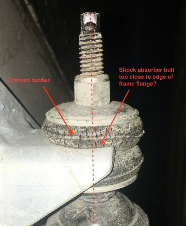

Frank C Posted October 15, 2021 Posted October 15, 2021 Doing some underside inspection on our Ollie Elite II (2019 Hull #461) and I noticed the rubber shock bushings on the original shocks are showing signs of cracking. We are done with our travels for this year so I’ll probably be replacing the shocks in the spring. Anyone have recommendation for a good aftermarket shock? Found some on Amazon from Lippert but I’d prefer something a bit higher quality.
Fritz Posted October 15, 2021 Posted October 15, 2021 17 hours ago, FrankC said: Doing some underside inspection on our Ollie Elite II (2019 Hull #461) and I noticed the rubber shock bushings on the original shocks are showing signs of cracking. On 6/28/2020 at 7:15 AM, John E Davies said: Maybe the nuts were overtightened? While winterizing a few days ago I noticed that the rubber on these shocks are cracking (trailer is 6 months old), and also the shock absorber bolt seems pretty close to the edge of the frame flange. Do these things seems normal to you? 2021 Oliver LE2 Ram 2500 diesel

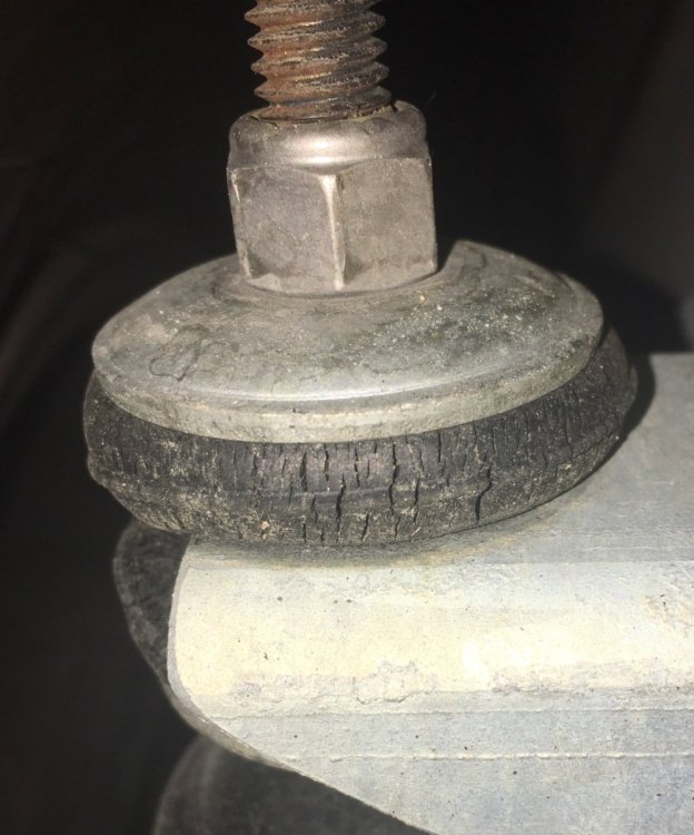

LongStride Posted October 17, 2021 Posted October 17, 2021 Went out and checked my shock bushings today. My Elite is just over five months old with less than 2K miles on it. My bushings appear to be over-torqued and are starting to crack. They also appear to be fastened very close to the edge of the bracket on the frame like the photo provided by Fritz. It looks as if there is a calamity of errors here. Improper installation and poor engineering. When bushings of this type are compressed to the point that there is no flex left in them, they no longer serve the intent of their design. The rubber bushings were also designed to have 360 deg. contact on their faces. They were not designed to hang over the edge of a bracket causing them to deform. Bracket and bushings are mismatched. I don't know if the responsibility for this issue lies with Dexter, Oliver, or shared between the two. At any rate I am going to open a service ticket on this while still under warranty. Mike and Yasuko 2021 Legacy Elite Hull #820
Frank C Posted October 17, 2021 Posted October 17, 2021 46 minutes ago, LongStride said: My bushings appear to be over-torqued and are starting to crack. On mine, the bushings do NOT appear over-torqued/excessively squeezed, but they are still cracked. Looks like the bushings that come with these standard shocks are just a really crappy low quality material that degrades quickly.
LongStride Posted October 17, 2021 Posted October 17, 2021 I agree Frank that your bushings don't appear to be over torqued. You may be spot on about crappy materials though. The compression of yours and those in the first photo of the thread look to be about right. The ones in the photos sent by Fritz are definitely over torqued. In all cases, the bushings are not meant to hang over the edge and deform. Mike and Yasuko 2021 Legacy Elite Hull #820

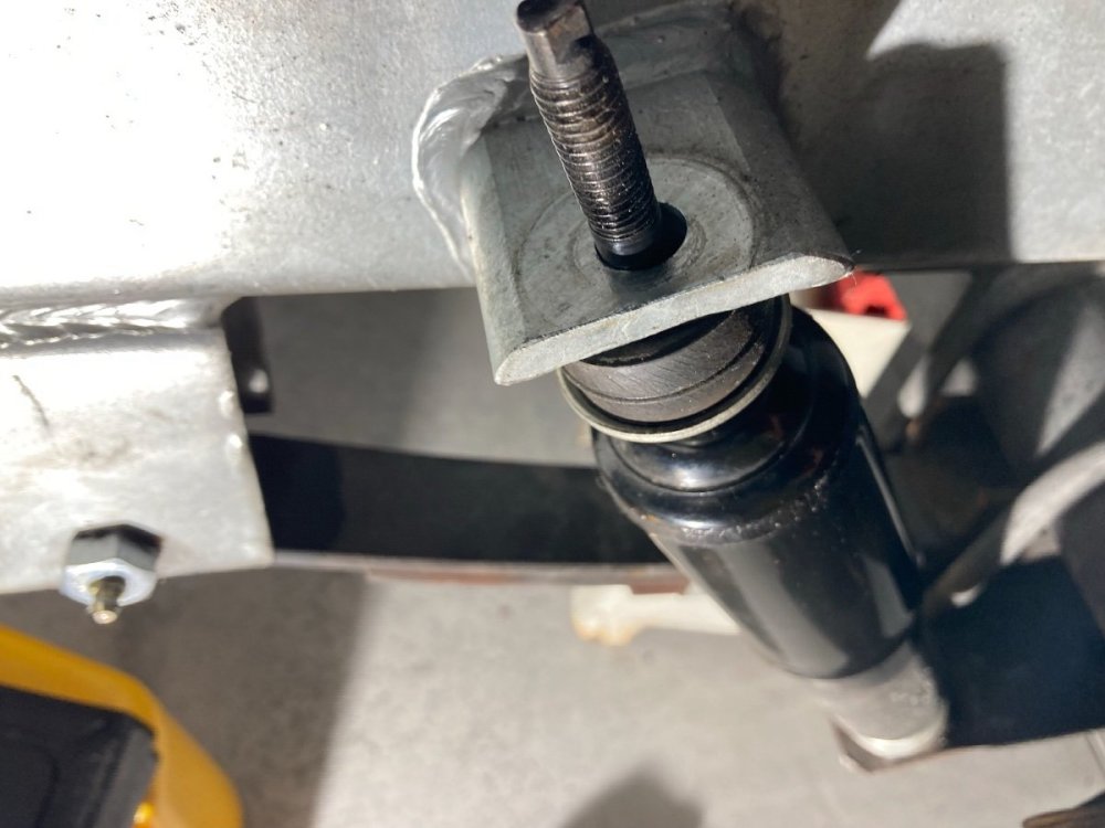

LongStride Posted October 18, 2021 Posted October 18, 2021 Update... I went out this morning hoping to find that the bracket was indeed a slot and that the shock could be loosened and pushed inboard a bit. No such luck. It is a hole, and its centerline is only 1/2" from the end of the bracket. There is no logical reason for this. The hole could easily have been another 3/8" inboard which would have allowed the rubber bushing to have 360 deg. contact with the bracket. It would only make sense that the hole was punched in the bracket prior to it being welded onto the subframe assembly. That being said, this is either a manufacturing defect or a poor design. Now that I have taken a closer look at the bushings I don't believe that they are over torqued. It doesn't help that they are deformed because they hang over the edge of the bracket, but the cracking is likely due to poor quality rubber than anything else. 1 1 Mike and Yasuko 2021 Legacy Elite Hull #820

Hokieman Posted October 23, 2021 Posted October 23, 2021 On 10/18/2021 at 4:48 PM, LongStride said: It is a hole, and its centerline is only 1/2" from the end of the bracket. There is no logical reason for this. The hole could easily have been another 3/8" inboard which would have allowed the rubber bushing to have 360 deg. contact with the bracket. It would only make sense that the hole was punched in the bracket prior to it being welded onto the subframe assembly. That being said, this is either a manufacturing defect or a poor design. Now that I have taken a closer look at the bushings I don't believe that they are over torqued. It doesn't help that they are deformed because they hang over the edge of the bracket, but the cracking is likely due to poor quality rubber than anything else. Same situation with my 2021 model. I was greasing the chassis this week and took one of the nuts off. Only the top of the shock has this problem, the lower end is fine. No serious cracks in the rubber yet. Perhaps some heavy duty fender washers between the rubber and the brackets would improve the rubber life. 3 1 “Ramble” - 2021 Legacy Elite II #797; 2020 Ford F-250. Former owner of 2019 Oliver Legacy Elite #431. Blairsville, GA
LongStride Posted October 24, 2021 Posted October 24, 2021 I agree that adding fender washers is a great idea. Any other means would require modifying the bracket which would be a royal PITA. In looking at various photos in this thread it would appear that this issue has been around for a few years. That being said, I can only imagine that Dexter is aware of the problem and just won't lift a finger to correct it. That's unconscionable. It is just a simple bracket and and a design change would cost them very little. Mike and Yasuko 2021 Legacy Elite Hull #820
John E Davies Posted October 24, 2021 Author Posted October 24, 2021 Yep, fender washers, they are available in a really thick version, about 0.1” - I would get some of these. A local nut and bolt supplier will sell them individually. Fastenal shows these: 1/2" x 1.375" OD Thru-Hardened Yellow Zinc Finish Steel USS General Purpose Flat Washer I am guessing about the hole size….. please verify first! But if you don’t replace the bushings at the same time, the old ones will probably fail immediately. 😤 Have you opened a service ticket? John Davies Spokane WA 1 SOLD 07/23 "Mouse": 2017 Legacy Elite II Two Beds, Hull Number 218, See my HOW TO threads: Tow Vehicle: 2013 Land Cruiser 200, 32” LT tires, airbags, Safari snorkel, Maggiolina Grand Tour 360 Carbon RTT.
Moderators mossemi Posted October 24, 2021 Moderators Posted October 24, 2021 1 hour ago, John E Davies said: I am guessing about the hole size….. please verify first! But if you don’t replace the bushings at the same time, the old ones will probably fail immediately. The stud size is 3/8” according to the spec sheet for a Monroe 565025 Gas-Magnum 65 Shock Absorber which was original equipment on my 2017 LE2. I think saving the original bushing washers would be a better option than a fender washer. So maybe I’ll save my old ones when I replace the shocks. There is a link to the complete product page at the bottom. Mossey Specifications SHOCK ABSORBER Compressed Bumper Stop No Compressed Length 8.625 Dust Shield Yes Dust Shield Material Metal Extended Bumper Stop Yes Extended Hydraulic Lockout No Extended Length 13.5 Lower Mounting Code S4 Lower Mounting Type Stem Mount - 2.3/8" Stem Length X 3/8"-16 Thread Pitch Parts Pack P01134 Travel Length 4.875 Upper Mounting Code S4 Upper Mounting Type Stem Mount - 2.3/8" Stem Length X 3/8"-16 Thread Pitch https://drivcat.com/overlays/part-detail.aspx?brandId=MS&pNum=555025&partType=Shock Absorb 1 Mike and Krunch Lutz, FL 2017 LEII #193 “the dog house”
