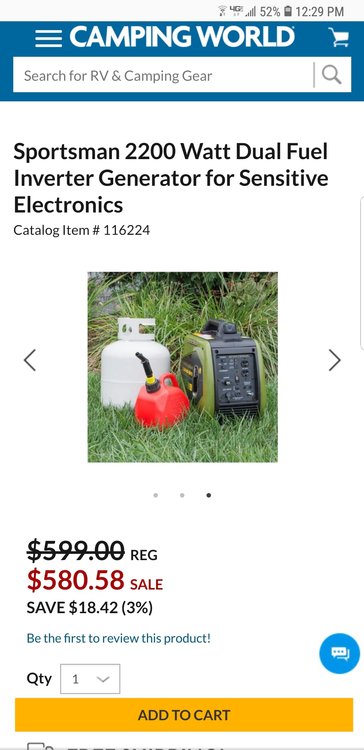

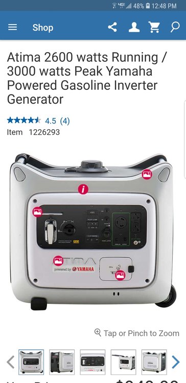

Curious to know if anyone has tried either of these:
the Sportsman 2200i dual fuel generator. Lighter weight, gas or lp, claims 1800 watts running... that's on gasoline, less on lp. Photo is from campingworld, but available online from Walmart for under $520, including shipping.
Or, the Atima 3000i Yamaha powered gasoline generator from Costco? Weighs in at 94 pounds dry, so still quite heavy to haul around, but great reviews on Costco and Amazon. Less than $1000 at Costco,  shipping included.
