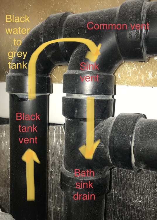

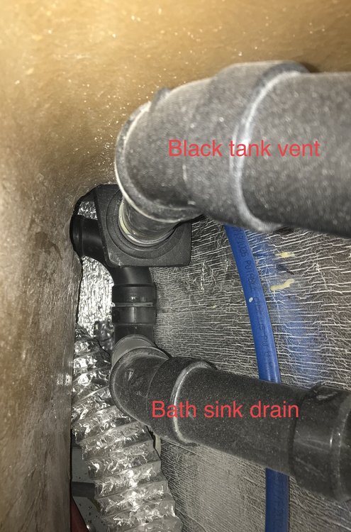

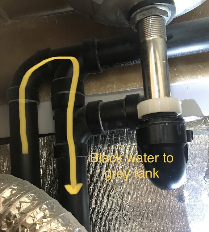

Sequence of events:
Flushing water fills the black tank. It can’t escape up through the toilet bowl because of the flushing valve mechanism.
Water begins to travel up the black tank vent pipe toward the roof. This is the black pipe you see transversing the inside of the common wall between the bathroom and closet.
Water would exit the roof in a geyser of excrement (just like in the movie RV) except it encounters a tee in the vent system that leads back to the gray tank and the bathroom drains.
Taking the path of least resistance, the water flows back downhill into the drain system finding the lowest point - the shower pan.
From here, two things can happen both with the same ultimate end.
If the back-flow preventer valve on the shower drain system is open the water will eventually fill the gray tank, exit from the shower drain, fill the bathroom to the level of the door, overflow into the coach, run out the door and covers the earth with your poop.
If the back-flow preventer valve on the shower drain system is closed the same thing will happen, only quicker since it doesn’t have to fill the gray tank first.

Took some pictures while I was in there to show Steve’s explanation of the black water to grey tank to shower drain path.
