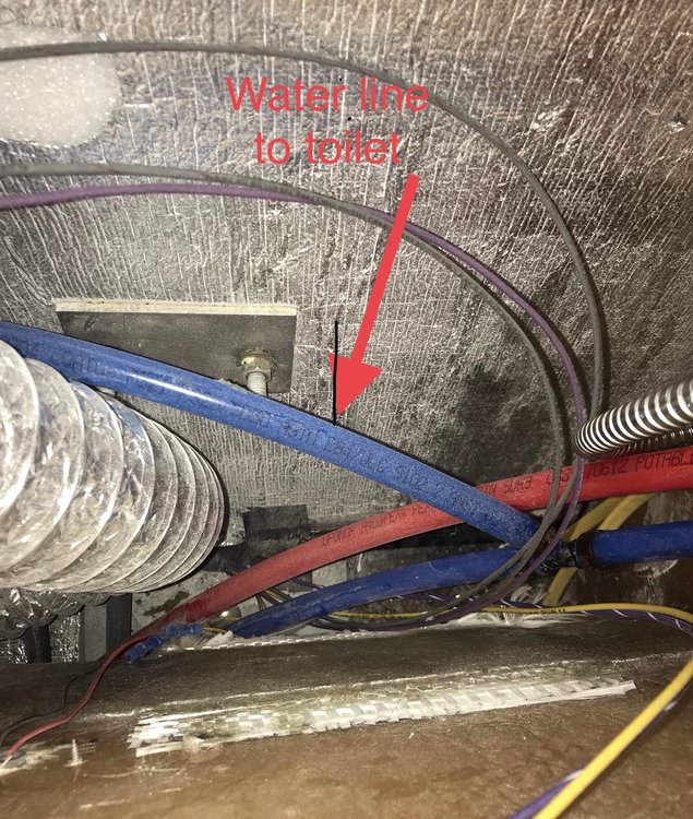

Townesw Posted October 19, 2019 Share Posted October 19, 2019 ...find the unused water line that goes to the small ball valve on the floor behind the toilet. Cut and plug the supply line under the sink close to where it tees off the faucet cold water line. John, here’s the water line you mention 1 Bill and Martha 2018 LEII Hull 313 Original owners 3/14/2018 2019 Chevrolet 2500HD Duramax Link to comment Share on other sites More sharing options...

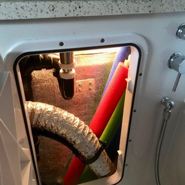

John E Davies Posted October 20, 2019 Share Posted October 20, 2019 Just a suggestion ... whenever any owner opens up a hidden compartment like this, be sure to use nylon wire ties to secure dangling wires and hoses. The factory still has not learned this, it appears. This “rats nest” is very disappointing to me.... Loose wires and lines flop around, chafe, loosen or break electrical connections, start water leaks and just look untidy. Five minutes with ties makes things secure and you won’t worry so much about failures down the road. Adding split loom would be even better, but more time consuming and not absolutely needed. John Davies Spokane WA 2 SOLD 07/23 "Mouse": 2017 Legacy Elite II Two Beds, Hull Number 218, See my HOW TO threads: Tow Vehicle: 2013 Land Cruiser 200, 32” LT tires, airbags, Safari snorkel, Maggiolina Grand Tour 360 Carbon RTT. Link to comment Share on other sites More sharing options...
JRK Posted March 26, 2021 Share Posted March 26, 2021 Thanks Bill, for the reference to this post. This will be helpful to untwist the hose. If I knew which way to turn it, or if it would be able to be untwisted without removing the front panel, I would do that. Maybe I should remove the front panel anyway to fix other issues, or to verify other issues are not there (or are). Not securing wiring or plumbing is a surprise. That is rather important for any use, but when in a moving vehicle subject to vibrations and bouncing, it is imperative. At delivery, I was told that the refrigerator plug is now secured with a tie wrap. It would fall out due to vibration and weight of the cord. I don't like using a tie wrap. A "space saver" plug would have helped a lot. But it should be better than it was, for a while. John 3 2022 Ford F150 4x4 2021 Elite I #758 Link to comment Share on other sites More sharing options...
SNY SD UP Posted March 27, 2021 Share Posted March 27, 2021 JD, I am assuming that this is a view from the top into the bathroom vanity. Within the black circle, are bolts like this covered on the protruding end, so they do not rub/abrade the water lines or wiring, or is the distance enough, so no problemo... Finally, is that (yellow) romex in that area. i have not seen any yet, in the few areas i have been looking into, but maybe i am just looking enough, or need to pay attention. Maggie & Bryan | Arnegard, ND | 2020 LE II "Twins" Hull #665 | 2021 RAM 2500 6.4L HEMI Gasser 4dr 6.5' bed Link to comment Share on other sites More sharing options...
Moderators mossemi Posted June 26, 2022 Moderators Share Posted June 26, 2022 That’s just an area that could use a pool noodle! Mossey 4 Mike and Krunch Lutz, FL 2017 LEII #193 “the dog house” Link to comment Share on other sites More sharing options...

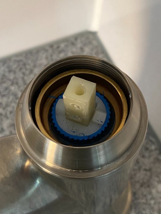

Geronimo John Posted April 4 Share Posted April 4 I momentarily thought I saw a model number for this faucet. Have reread the thread, but apparently my eyes are fooling me again. I would appreciate knowing the faucet model number. And golden bonus info would be the repair cartridge you used. thank you GJ TV: 2019 F-150 SuperCrew Lariat, 3.5L EcoBoost, 10 Speed Trany, Max Tow, FX-4, Rear Locker OLLIE: 2018 OE2 Hull 342, Twin Bed. OLLIE DIY’s: Timken Bearings, BB LiFePO4's, Victron 712 Smart, 350 Amp Master Switch, Houghton 3400, Victron Orion DC - DC, 3000-Watt Renogy Inverter, P.D. 60-amp Converter, Frig Dual Exhaust Fans, Kitchen Drawer Straps. Front Wardrobe Shelves, Snuggle Shelf. TV DIY’s: 2 5/16" Anderson System, Nitto recon’s, Firestone Rear Air Bags, Bilstein 5100’s, Mud Flaps & Weather Tech all, installed Ham Radio (WH6JPR). Link to comment Share on other sites More sharing options...
Townesw Posted April 4 Share Posted April 4 (edited) 2 hours ago, Geronimo John said: I momentarily thought I saw a model number for this faucet. Have reread the thread, but apparently my eyes are fooling me again. I would appreciate knowing the faucet model number. And golden bonus info would be the repair cartridge you used. thank you GJ Here is the response I received from Jason in July 2019 regarding faucet model number used in Hull 313. Here’s the cartridge I used. Get a couple of spares. I ordered one from Amazon and Dura sent me one under warranty. I need to replace mine again. https://www.amazon.com/Dura-Faucet-DF-RK601-Cartridge-Replacement/dp/B072BVH7KB Don’t forget the socket wrench. Mine came from a set that I bought at a Menards in Marquette MI. It’ll make the job real easy. You may have to clock the faucet base if it has been twisted out of position. See my write up in this thread. Edited April 4 by Townesw 2 2 Bill and Martha 2018 LEII Hull 313 Original owners 3/14/2018 2019 Chevrolet 2500HD Duramax Link to comment Share on other sites More sharing options...
Geronimo John Posted April 4 Share Posted April 4 (edited) Perfect! 15 years ago I needed one of those wrenches so bought the set. They have been hanging on the wall since then untouched. So, YEA I can use one of them again. thanks for the model number and cartridge info. Very good info to have in my KEEPER file. GJ Edited April 4 by Geronimo John typo 1 TV: 2019 F-150 SuperCrew Lariat, 3.5L EcoBoost, 10 Speed Trany, Max Tow, FX-4, Rear Locker OLLIE: 2018 OE2 Hull 342, Twin Bed. OLLIE DIY’s: Timken Bearings, BB LiFePO4's, Victron 712 Smart, 350 Amp Master Switch, Houghton 3400, Victron Orion DC - DC, 3000-Watt Renogy Inverter, P.D. 60-amp Converter, Frig Dual Exhaust Fans, Kitchen Drawer Straps. Front Wardrobe Shelves, Snuggle Shelf. TV DIY’s: 2 5/16" Anderson System, Nitto recon’s, Firestone Rear Air Bags, Bilstein 5100’s, Mud Flaps & Weather Tech all, installed Ham Radio (WH6JPR). Link to comment Share on other sites More sharing options...
