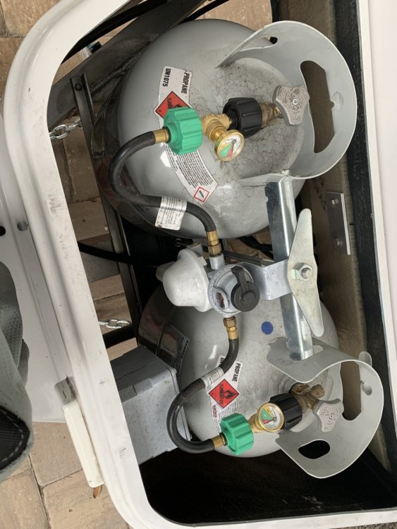

possibly a propane shutoff safety valve reduces concerns about running propane while in transit?  Check out this interesting TechnoRV propane safety valve
Attached is a picture of the GasStop Propane Shutoff Valves I recently installed on Hull #4441195112753_TechnoRVvalves.thumb.jpg.dabe6d58437a6e36fe1559f0731aae82.jpg
Edited by KWRJRPE
KWR
