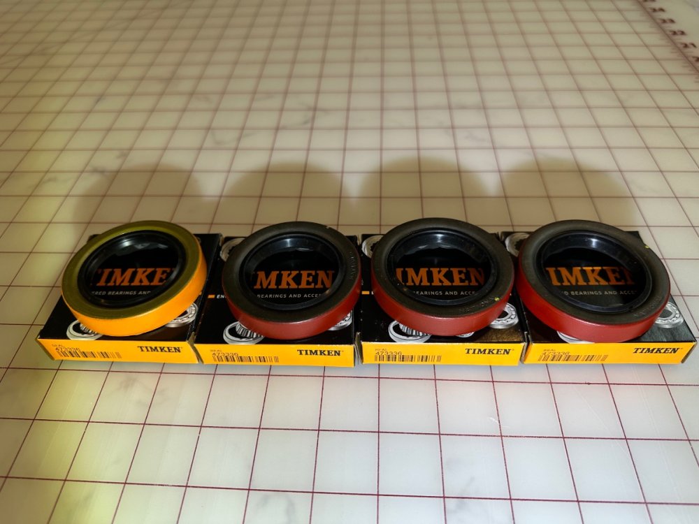

Just for grins I ordered 4 "Timken" 477336 seals that are shipped directly from Amazon.
That I received was  this....one orange marked TIMKEN on the rubber but no stamps on metal (Box said Made in Taiwan) ...and 3 red stamped NATIONAL 477336. (Box Said Made in Mexico).
(All are going back to Amazon with a return note about counterfeit items they are shipping.)
I've also ordered from my local shop the same seals and I'll see what turns up.

It's a confusing world these days with mergers, buy-outs and contract manufacturing. I'll muddy the water a little more with my first hand knowledge. My wife used to work for Federal Mogul as a buyer. Federal Mogul used to be National Seal. Even though Federal Mogul manufactures seals today, they can have several names on the packaging. They may be labeled National Seal, or Timken. Federal Mogul was acquired by Tenneco a few years ago and I believe changed the name of the Federal Mogul division to DRiV. For that reason their seals may also have this new name on them. To add to the confusion, Timken also contracts with other manufacturers to produce their products. The point of this is that you likely do have in your possession actual Timken parts. The problem is that it's well documented that Amazon is very unreliable in their sourcing and for that reason everyone has learned to be very cautious when there are discrepancies in packaging. If in doubt you can easily return. The problem is, unlike OEM manufacturers and OEM suppliers, Amazon has zero quality assurance process or supplier verification. Their buyers simply shop price and supply.

They are likely Chinese knock-off's

Too bad Amazon played the "Bait and Switch" game - that sucks.  I found TIMKEN's at our local auto supply last week - they had two sets in stock and ordered the other 2 which came the next day.
