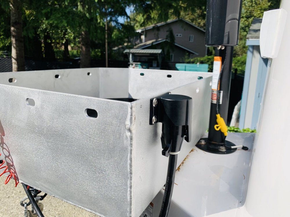

My thoughts: For future reference, activating the breakaway switch will not turn on the brake lights. Also, it's good practice to routinely pull and re-insert the switch pin to verify operation. The first time you do this will give you an idea of the actual force required. In the seven-way plug,  the right turn/stop and tail/marker light contacts are adjacent to the 12V aux. This explains the two anomalies you experienced. My solution for keeping water out,
7 Pin Waterproof Holder Mod - Did this for our unit as we had that exact problem...water in the 7 pin after heavy rains.
Now we are good...

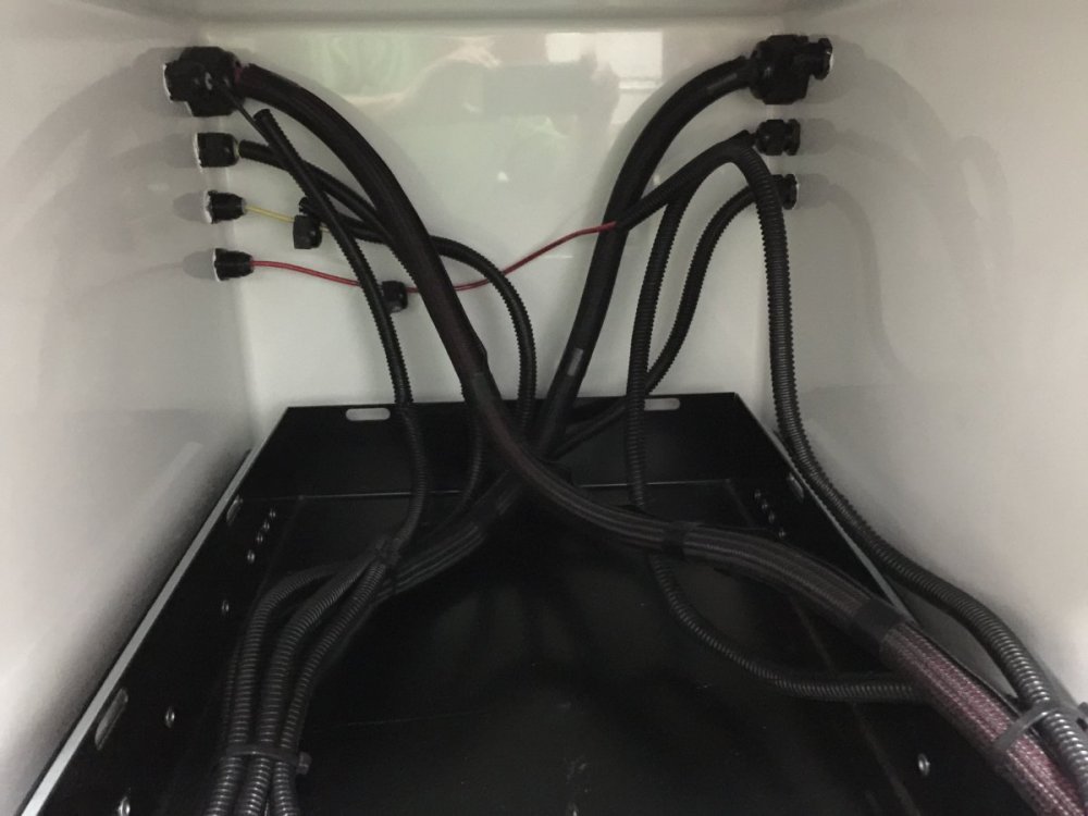

The stiffer black one, which might actually be yellow, that's attached to the post adapter on the inside front battery.
2 hours ago, thompsonkd said:
Do you mean the stiff cable that connects the 2 front batteries?
No. It is one of the cables that comes in though the front of the battery box.
Here's a picture of my 2018 I found. Third one up from the bottom on the left. Stiff refers to insulation not cable size.
Edited by bhncb
Thanks for the responses re negative terminal on battery-the picture was helpful as well.
David
