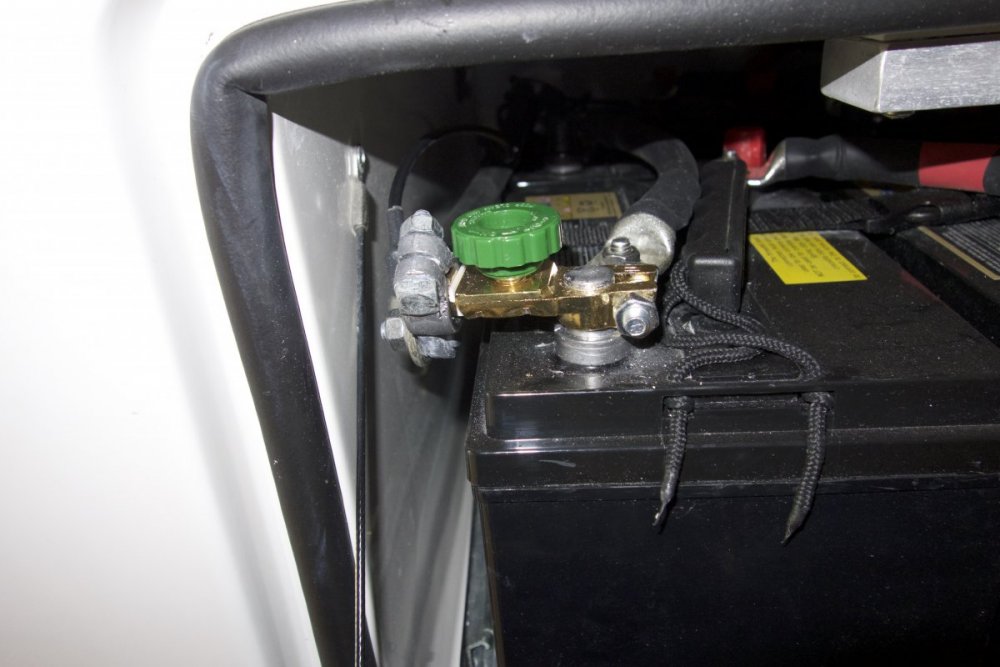

DavidS Posted July 17, 2020 Posted July 17, 2020 It is cheap and easy to install a battery disconnect switch on the battery. I can access the switch by opening the door to the battery compartment. 1 David Stillman, Salt Lake City, Utah 2016 Oliver Elite II Hull 164 | 2017 Audi Q7 tow vehicle. Travel and Photography Blog: http://davidstravels.net

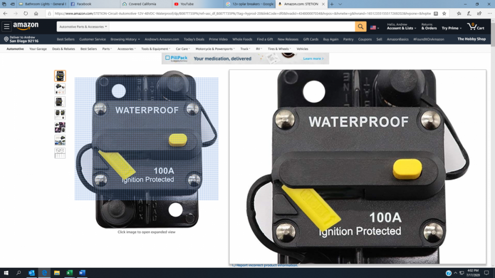

AndrewK Posted July 17, 2020 Posted July 17, 2020 Our 2019 has a breaker under the driver's side bed, to the left of the positive bus. Push the yellow or red button in to turn off. Close the yellow or red gate switch to turn on. Breaker is similar to below. Andrew Andrew 2019 Legacy Elite II 2018 BMW x5 35d
Overland Posted July 17, 2020 Posted July 17, 2020 That breaker will disconnect most of the electrical but not all. 1
AndrewK Posted July 17, 2020 Posted July 17, 2020 (edited) On 7/17/2020 at 4:12 PM, Overland said: That breaker will disconnect most of the electrical but not all. Overland, My battery monitor shows no current across the shunt, when the breaker is open. Meaning less than 0.01 amps/hour. Andrew Edited July 20, 2020 by AndrewK Andrew 2019 Legacy Elite II 2018 BMW x5 35d

John E Davies Posted July 19, 2020 Posted July 19, 2020 (edited) A warning about post type disconnects. Check the amp rating. DavidS’ is rated at 125 amps continuous for use on the Negative terminal only. He has it connected to the small ground wire coming out of the hull, so that is fine. Do NOT connect it to the huge 4/0 inverter ground cable, if you have one. The inverter draws that much or more and can quickly fry this device. Also make sure the cable is fully supported by clamps or heavy nylon ties so it can’t torque the attach bolts loose. There is a lot of weight and leverage involved, especially on bumpy roads. If you have an inverter and want to disconnect all the possible electrical draws you need a high amp marine type Positive disconnect rotary switch rated at 300+ amps. Blue Seas makes excellent ones, some are even key lockable. This should be located inside the hull as close to the battery as practical and will require cable fabrication. Be safe, research well, and do not ever install a low quality part. Oliver uses some very high quality electrical components, in the main circuits, bravo for them. The other stuff like the POS fuse panel could sure use an improvement.... John Davies Spokane WA Edited July 19, 2020 by John E Davies 1 SOLD 07/23 "Mouse": 2017 Legacy Elite II Two Beds, Hull Number 218, See my HOW TO threads: Tow Vehicle: 2013 Land Cruiser 200, 32” LT tires, airbags, Safari snorkel, Maggiolina Grand Tour 360 Carbon RTT.
Moderators mossemi Posted July 19, 2020 Moderators Posted July 19, 2020 4 hours ago, John E Davies said: A warning about post type disconnects. Check the amp rating. DavidS’ is rated at 125 amps continuous for use on the Negative terminal only. He has it connected to the small ground wire coming out of the hull, so that is fine. Do NOT connect it to the huge 4/0 inverter ground cable, if you have one. The inverter draws that much or more and can quickly fry this device. John Davies Spokane WA JD, I am confused by your small ground wire comment. The only ground wires smaller than the main 4/0 I remember having were a yellow jacketed 6 AGM, a black 10 AWG from the Furrion solar port I added, the black 6 AWG and the temp sensor for the Zamp controller. It looks to me that the disconnect is on the left main 4/0 to the cabin/inverter and the right 4/0 is the jumper to the battery behind the battery with the disconnect. What else could the disconnect be controlling? I think the disconnect is in just the condition you are warning about. Maybe DavidS will chime in with a clarification. Mossey Mike and Krunch Lutz, FL 2017 LEII #193 “the dog house”
John E Davies Posted July 19, 2020 Posted July 19, 2020 Mossey, maybe I am not seeing his cables correctly DavidS does need to chime in. We don’t want any fires....... john Davies Spokane WA SOLD 07/23 "Mouse": 2017 Legacy Elite II Two Beds, Hull Number 218, See my HOW TO threads: Tow Vehicle: 2013 Land Cruiser 200, 32” LT tires, airbags, Safari snorkel, Maggiolina Grand Tour 360 Carbon RTT.

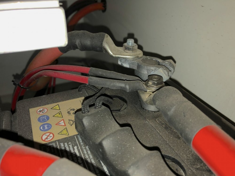

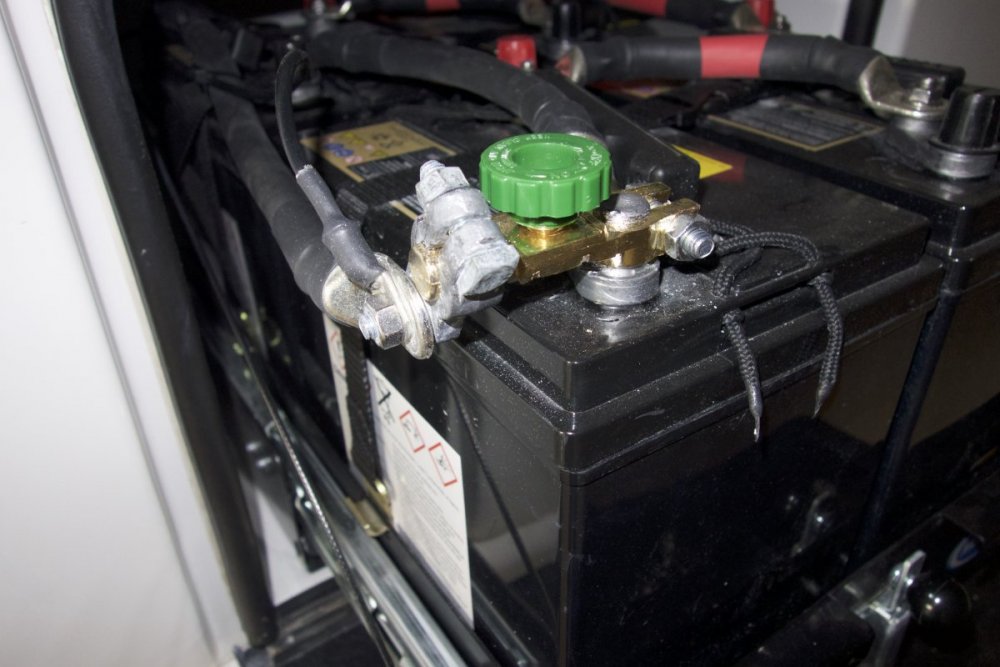

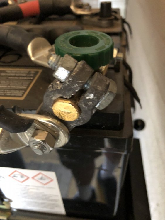

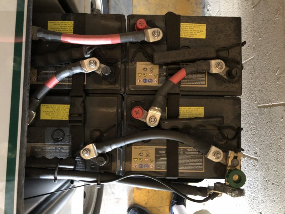

DavidS Posted July 20, 2020 Posted July 20, 2020 John D and Mossey inquired about how my battery disconnect is attached. I am not sure I understand the questions, but I will try to answer. I have four AGM batteries, and this is the battery tray from above. The disconnect is attached at the bottom right, on a negative terminal, and the positive connects to a battery at the top left. Here is a view of the positive terminal connections. One large red wire (the 4/0 wire?) and two smaller diameter red wires. There are two black wires connected to the battery disconnect, one large and one small. Is this set up of concern? David Stillman, Salt Lake City, Utah 2016 Oliver Elite II Hull 164 | 2017 Audi Q7 tow vehicle. Travel and Photography Blog: http://davidstravels.net
John E Davies Posted July 21, 2020 Posted July 21, 2020 (edited) Hi DavidS. The big fat black cable is your inverter ground, and it sometimes carries significantly more current than that disconnect is rated for (125 amps continuous). I suggest that you hook both cables back to the nearby post, without your switch. If you could find a disconnect with a higher rating, you could keep it as is, but your current situation (electrical pun) is a little risky IMHO. In theory you could just have the small cable going through a disconnect, but Oliver joins the inverter ground to the main chassis ground inside the hull (there was a recall about this a year ago) so the small cable ground would just find its way through that added wire to the battery.... Here is what is happening with my inverter running the microwave, while in sunshine, so the solar is contributing a little to offset the massive current draw: If you run the MW for a long time, like 12 minutes for cooking a couple of frozen dinners, or if you added even more load, like a heater or toaster while the microwave was going, it could start overheating your disconnect. Have you ever felt the disconnect while running a heavy load? Was it warm? I am not trying to alarm you, I just want to keep things safe. Those fat wires carry a whole lot of current, which is potentially dangerous. Google “welding with car battery”... John Davies Spokane WA Edited July 21, 2020 by John E Davies 2 SOLD 07/23 "Mouse": 2017 Legacy Elite II Two Beds, Hull Number 218, See my HOW TO threads: Tow Vehicle: 2013 Land Cruiser 200, 32” LT tires, airbags, Safari snorkel, Maggiolina Grand Tour 360 Carbon RTT.
Moderators mossemi Posted July 21, 2020 Moderators Posted July 21, 2020 David, JD presents a very good, real world example of the load we can place on the Oliver battery system and that it could overload your battery cutoff. Here is some additional information to support his suggestion to remove or upgrade your battery cutoff. The Trojan battery manual provides a cable sizing chart which states that a 4/0 cable, 6' long can support 360 amps. Oliver installed a 4/0 cable with an in-line 250 amp fuse between the inverter and batteries in my trailer and I bet yours is the same. This means the fuse should blow before the cable would fail. Your 125 amp rated battery cutoff now becomes the weakest link in the battery system. It will not blow In an overload condition because it does not have that capability, but it might melt or burn and that is our concern. I do not always agree with JD, but I know he always has everyone’s safety in mind. And that’s a good thing for the rest of us. Mossey 2 Mike and Krunch Lutz, FL 2017 LEII #193 “the dog house”

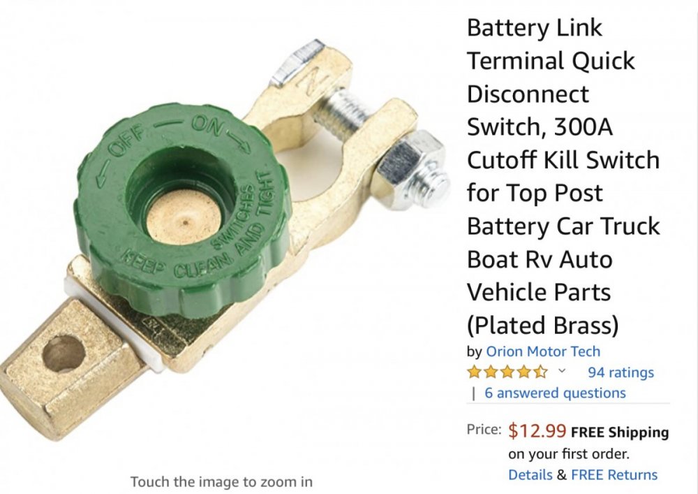

DavidS Posted July 21, 2020 Posted July 21, 2020 Would a disconnect switch rated at 300 amps solve the problem? David Stillman, Salt Lake City, Utah 2016 Oliver Elite II Hull 164 | 2017 Audi Q7 tow vehicle. Travel and Photography Blog: http://davidstravels.net
John E Davies Posted July 21, 2020 Posted July 21, 2020 (edited) David, that looks like the exact same part, maybe you should contact the seller to verify the continuous amp rating. We all know how flaky Amazon descriptions can be..... I don’t see how one can be rated at 150 and the other at 300 when the pictures look identical. Here is one that uses a removable key. It is rated at 200 amps continuous and 500 amps for 5 seconds. You would need another short “jumper” cable, similar to the jumpers on top Of the battery. I have never used one, I am just throwing this out there for your consideration. You would need to figure out either a mount or some other method of stabilizing it. https://www.amazon.com/dp/B071D55VM3/?tag=massdeals-20 It could even be placed on top of the battery bank, I think. Maybe...... Possibly. John Davies Spokane WA Edited July 21, 2020 by John E Davies SOLD 07/23 "Mouse": 2017 Legacy Elite II Two Beds, Hull Number 218, See my HOW TO threads: Tow Vehicle: 2013 Land Cruiser 200, 32” LT tires, airbags, Safari snorkel, Maggiolina Grand Tour 360 Carbon RTT.
