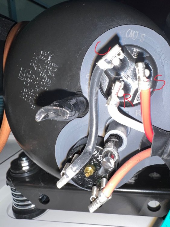

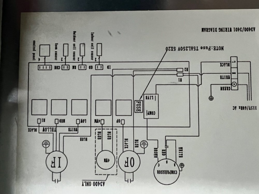

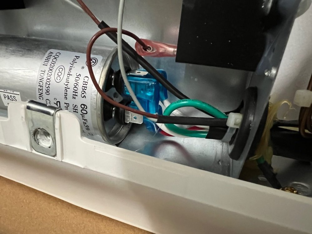

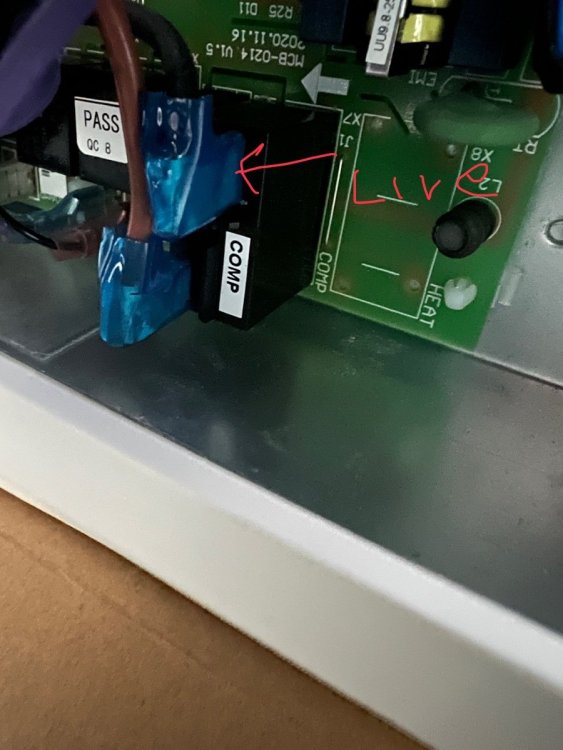

Jps190 Posted April 10, 2022 Posted April 10, 2022 Calling all easy start experts. So I received the Houghton and here is what I have found under the hood. So the red wire comes from the start position on the compressor and goes to the run capacitor. There are no other wires on that terminal so I will connect the orange wire to the same terminal with the red wire. The other terminal has 2 white wires. I will check continuity to determine which wire comes from the Run terminal on the compressor and disconnect that wire from the capacitor. I will then splice the white wire that I just disconnected to the brown wire from the easy start. Since this compressor is under 3 tons I will connect the white wire from the easy start to the same terminal that I removed the white wire that I connected to the brown wire from the easy start. The brown wire from the control board goes to the overload protection device on the compressor and then is jumped to the C terminal on the compressor. So will I need to splice the black wire into the brown wire somewhere before overprotection device. What is the best technique to do that? I was thinking of using a 3 way wago connector. I appreciate all the knowledge here. I don't want to fry my new AC unit. 🤑 John John and Kim 2021 GMC Sierra 2500 AT4 6.6L Duramax 11350 GVWR 3048lb Payload 2021 Oliver Elite II. Hull #887
bhncb Posted April 10, 2022 Posted April 10, 2022 On 4/10/2022 at 3:05 PM, Jps190 said: What is the best technique to do that? I was thinking of using a 3 way wago connector. Expand I used a 2 to 1 flat terminal adapter on the protection device. That way the original wire terminations can be left in tact and it will be easy to backout the easystart installation In the event of a failure. 1 2
Jps190 Posted April 10, 2022 Posted April 10, 2022 On 4/10/2022 at 5:14 PM, bhncb said: I used a 2 to 1 flat terminal adapter on the protection device. That way the original wire terminations can be left in tact and it will be easy to backout the easystart installation In the event of a failure. Expand Brilliant!! I didn't even thick about piggyback connectors. Much happier not having to cut wires just in case. John 1 John and Kim 2021 GMC Sierra 2500 AT4 6.6L Duramax 11350 GVWR 3048lb Payload 2021 Oliver Elite II. Hull #887
Jps190 Posted April 10, 2022 Posted April 10, 2022 On 4/10/2022 at 5:14 PM, bhncb said: I used a 2 to 1 flat terminal adapter on the protection device. That way the original wire terminations can be left in tact and it will be easy to backout the easystart installation In the event of a failure. Expand https://www.amazon.com/dp/B008HQ63IW?psc=1&smid=ATVPDKIKX0DER&ref_=chk_typ_imgToDp I ordered some of these but on further inspection it looks like it might be a tight fit under the cover on the compressor connections. Were you able to make it fit under the cover? John and Kim 2021 GMC Sierra 2500 AT4 6.6L Duramax 11350 GVWR 3048lb Payload 2021 Oliver Elite II. Hull #887
bhncb Posted April 10, 2022 Posted April 10, 2022 I used a different style but this one is similar and should work. https://www.amazon.com/Supco-T1121-Chair-Terminal-Female/dp/B0071NCJ44/ref=pd_bxgy_img_sccl_1/140-1621370-1568045?pd_rd_w=T1dhB&pf_rd_p=6b3eefea-7b16-43e9-bc45-2e332cbf99da&pf_rd_r=E1WBW319HHWRDZ7E8V21&pd_rd_r=556ffc67-d620-4f02-8f4b-3b5a93b01b8f&pd_rd_wg=wGdMb&pd_rd_i=B0071NCJ44&psc=1 Edit: On the other hand the reviews of that particular one make it questionable. The Ancor Marine version is more expensive but you can be assured of getting a quality piece. You might be better off sourcing it locally at a supply house. No need to have to buy 20 of them. 1 3

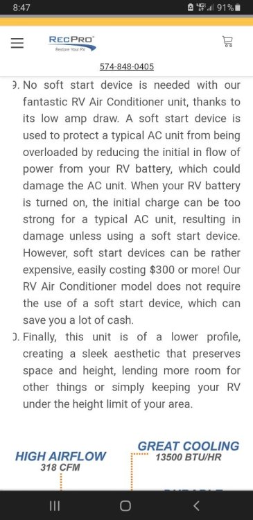

Moderators SeaDawg Posted May 2, 2022 Moderators Posted May 2, 2022 Houghton doesn't recommend an ez start. In fact, they state it is unnecessary: https://www.recpro.com/rv-air-conditioner-low-profile-13-5k-quiet-ac-with-heat-pump-remote-non-ducted/?campaignid=12146829544&adgroupid=117783579318&keyword=&gclid=CjwKCAjwgr6TBhAGEiwA3aVuIcKe6D0oigh3GDSNb4e9P00xo3AdmwiJYtowirJsZ5b0B_Ql9ESIoBoCwFEQAvD_BwE 1 2 2008 Ram 1500 4 × 4 2008 Oliver Elite, Hull #12 Florida and Western North Carolina, or wherever the truck goes.... 400 watts solar. DC compressor fridge. No inverter. 2 x 105 ah agm batteries . Life is good.
Moderators topgun2 Posted May 2, 2022 Moderators Posted May 2, 2022 On 5/2/2022 at 5:23 AM, Geronimo John said: For grins have you talked to the EZ-Start gentleman that has installed a bunch of them at the Rally's? Expand Unfortunately the last I heard, Matteo (sp?) is no longer with the company. Hopefully Micro-air will have another employee attend our Rally in the future and it would certainly be nice if the new employee is as helpful, kind and hard working as Matteo. Bill 4 2023 Ford F150 Lariat 3.5EB FX4 Max Towing, Max Payload, 2016 Oliver Elite II - Hull #117 "Twist" Near Asheville, NC
bhncb Posted May 2, 2022 Posted May 2, 2022 On 5/2/2022 at 12:47 PM, SeaDawg said: Houghton doesn't recommend an ez start. In fact, they state it is unnecessary: Expand It's unnecessary as long as your power source can handle the inrush current, while also providing power for potentially other demands. I saw a Houghton table somewhere that the minimum generator size to reliably operate the 3400 was a 2200 watt class like a Honda or Yamaha. Key word being "reliably". A soft starter can still provide benefit. 1 2
