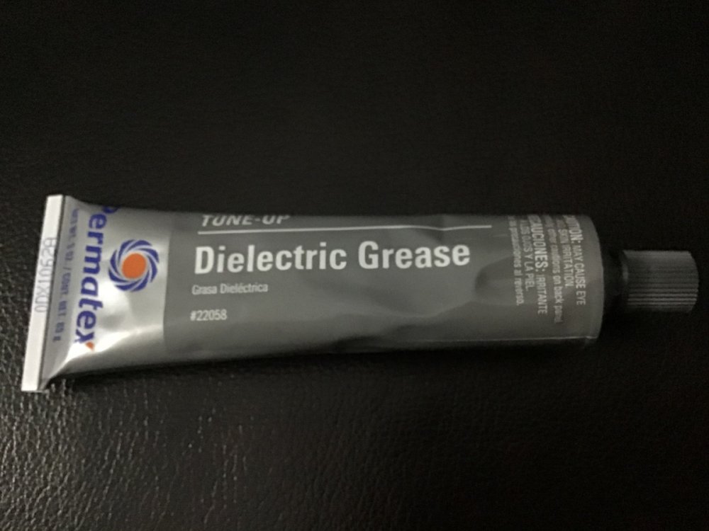

Landrover Posted September 21, 2020 Share Posted September 21, 2020 The 2020 2500 HD Chevys have more tow features. On my 2017 Chevy HD I had some trailer connection problems. The display was showing no brake controller connections, service trailer brakes. Or no connection at all. It was a simple fix. Dielectric Grease on the trailer plug And the problem was solved solved for me, 1 Grant 2022 GMC Denali 2500 HD 2019 Elite 11😎 Link to comment Share on other sites More sharing options...

ThomB87 Posted September 22, 2020 Author Share Posted September 22, 2020 Thanks everyone for the input. The Tow Ready is on order. Seems like a quick cheap fix if it works. I already use the dielectric grease as a brake light short preventive. And thanks for the encouragement I may take another run at GM going around the dealer. Oliver is not the only trailer manufacturer who has gone to LED lights. I can't be the only owner complaining. Bill Thomas 2019 Elite II Hull # 534 2020 Chevrolet Silverado HD 2500 Link to comment Share on other sites More sharing options...
