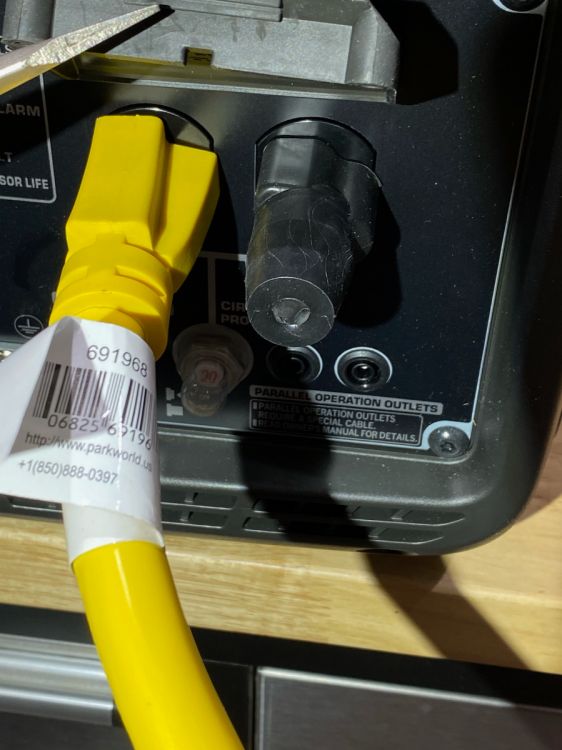

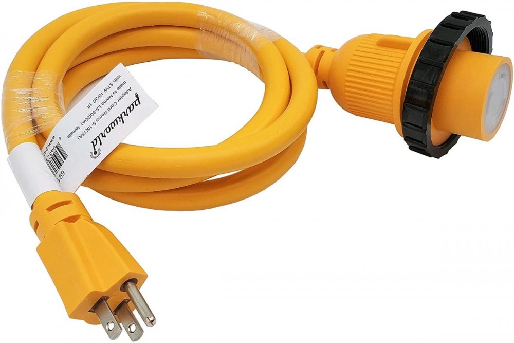

The following pictures show my equipment.  I use a 50' 12 gauge extension cord plugged into an outdoor 15 amp outlet at home to power my trailer 24/7 365.  But I can run the air conditioner with the same extension cord plugged into the Honda 2000i.  And I will mention it again, I do have an Easy Start.  I recently helped a friend install a Soft Start on his 10 year old SOB trailer and he is using a Yamaha 2200i.  Works just fine.
The other equipment in the pictures are the neutral ground plug that came with my trailer.  A test cable I made out of a male and female 15 amp replacement plugs and a scrap of wire.  An AC/DC Amp meter to take load readings from the generator.  A 15 to 30 amp conversion plug.

So, in regards to needing an adapter to use either outlet with the Oliver power cord, the question in my mind still remains: is there room on the plug panel of the standard Honda (with two 20 amp plugs) to accommodate the neutral ground plug (necessary for the onboard surge protector to operate while using generator power) and the adapter for the Oliver power cord to plug in to the second receptacle?
Also, without a 30 amp plug, and connecting the Oliver power cord to the 20 amp plug, will any additional load in combination with running the a/c trip the generator, as it often will when plugged in to a 20 amp home plug?
Yes, but this is also depending on the adaptors that are chosen.  There are larger 15A to 30A diameter adaptors will not fit with a neutral ground plug in place, but even those could be used with a short 15A extension cord. Or you could use the one that I put in my previous post works fine with my Honda 2200i - shown here again.

Is there room for the neutral ground plug on the Honda?
I found there was not with some of the larger plug adapters out there. However, I did also find that once I got it set up with an adapter plug that allowed room (there's a photo of one such adapter above in another post), that I was getting an error on the Surge protector panel in the attic (the description of the error in the SP manual mentioned neutral-ground issue IIRC). So I tried it w/o the neutral ground plug and lo and behold I got E0 - i.e. no error and happy current flowing to outlets and charging the batteries etc. I.e. with just  the  one outlet into which the trailer was plugged). This appears to defy the conventional wisdom I've read in generator threads on this forum but there it  is in any case...
