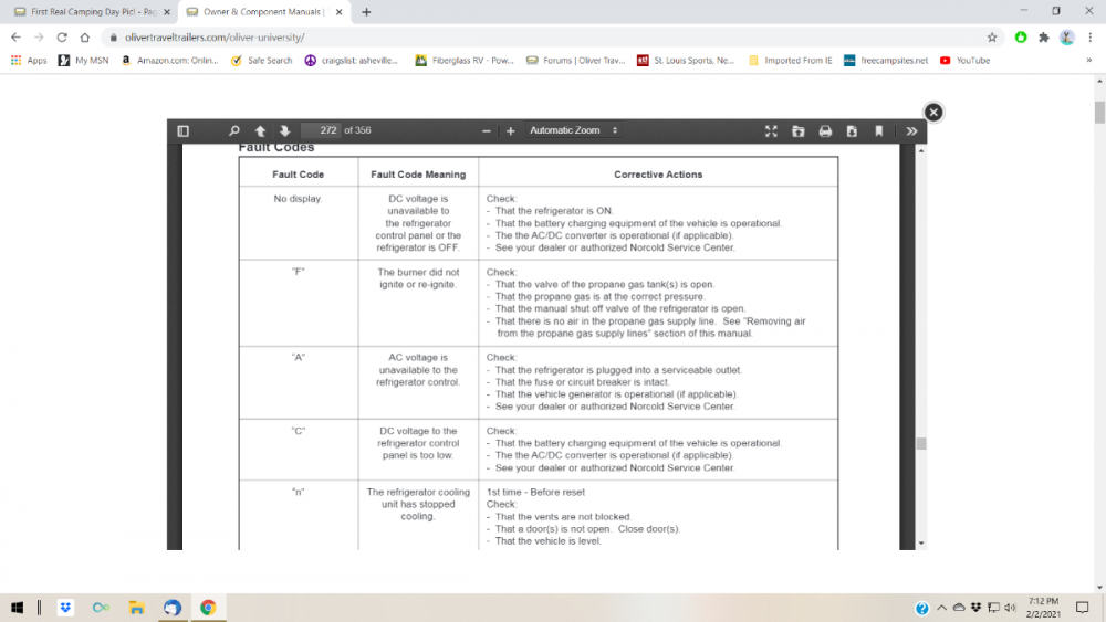

Moderators topgun2 Posted February 3, 2021 Moderators Posted February 3, 2021 (edited) From the 2021 Owner's Manual for the Norcold fridge: If this is the fridge you have then there is NO code 10 listed nor is there any numerical code listed - just alpha codes. Edited February 3, 2021 by topgun2 1 2023 Ford F150 Lariat 3.5EB FX4 Max Towing, Max Payload, 2016 Oliver Elite II - Hull #117 "Twist" Near Asheville, NC
SteveCr Posted February 3, 2021 Posted February 3, 2021 https://norcold.com/wp-content/uploads/2018/07/626800B_SM_N41N500N51.pdf Here is a link to the Norcold N41x service manual...if that is your model. I did not see a "10" error code...unless it is flashing a temp.
Frank C Posted February 3, 2021 Posted February 3, 2021 (edited) It’s only a single character display (at least it is on my Norcold fridge). How can it show a “10”? Edited February 3, 2021 by FrankC

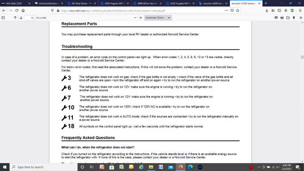

SteveCr Posted February 3, 2021 Posted February 3, 2021 https://norcold.com/wp-content/uploads/2018/06/norcold-n1350-owners-manual.pdf N3000 owner manual link above....Code 10 indicates AC is not available....try DC/Propane or auto.
Moonlight Mile Posted February 3, 2021 Author Posted February 3, 2021 (edited) 5 minutes ago, SteveCr said: https://norcold.com/wp-content/uploads/2018/06/norcold-n1350-owners-manual.pdf N3000 owner manual link above....Code 10 indicates AC is not available....try DC/Propane or auto. Tried everything. On battery. Got cabinets back together and screwed plywood back together. Was told to call tomorrow at next campsite. And wondering why I am having to call them. Shouldn’t they be calling me? Followup? Making it right? Just a thought. Good night all. Thanks. It’s not you. Edited February 3, 2021 by SherMica 2021 Elite 1 -- Hull #731 Ram 1500 Rebel 4x4 Now Sold
Moderators SeaDawg Posted February 3, 2021 Moderators Posted February 3, 2021 (edited) Did you drive all day with the fridge set to electric instead of set to off or propane? That would probably trigger the code. Try turning the fridge off for awhile, then try running it on propane. Are you plugged into 110 now? Is 110 working elsewhere in the trailer? (Like, does your little electric heater work?) Edited February 3, 2021 by SeaDawg Typos 2008 Ram 1500 4 × 4 2008 Oliver Elite, Hull #12 Florida and Western North Carolina, or wherever the truck goes.... 400 watts solar. DC compressor fridge. No inverter. 2 x 105 ah agm batteries . Life is good.
