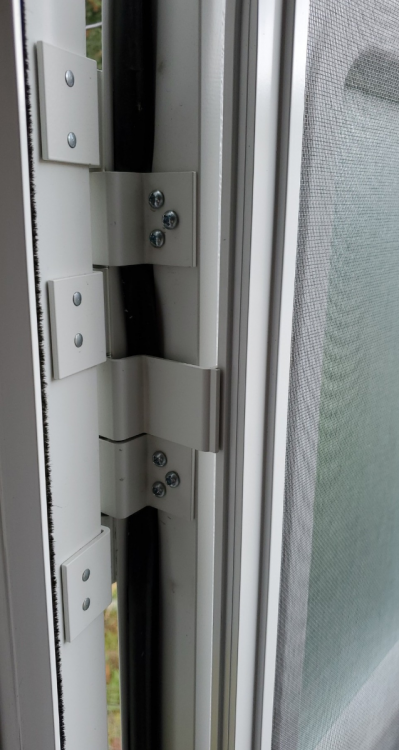

I am curious if the problem might also be at least partly due to the way the hinges of the door were attached over the top of the weatherstripping.  As you can see in the picture some of the weatherstripping is pinched under the hinge which might in theory cause the door to misalign.  Does this assembly of the door hinges with the weatherstripping pinched underneath look abnormal to any of you compared to your Oliver?
Mine are similar.

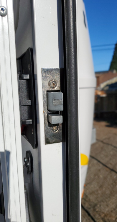

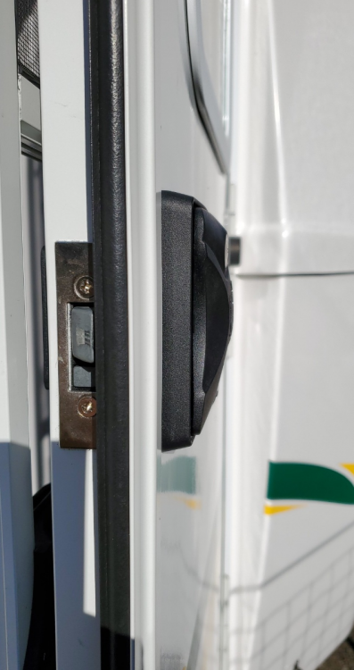

Could you also add a photo of the strike plate, please?
Edited by SeaDawg
Here are a few photos of the strike plate.  I did notice the door hangs slightly lower on the handle side compared to hinge side, but it does not appear to affect the operation of the door in any way and the latch appears to be centered vertically in the strike plate.

Those pics seem to show that, if anything, the latch is hitting slightly high (odd since you said that the door is a bit low on the latch side), and, not surprisingly it is certainly "resting" on the outside most inner surface of the plate.
How about a pic or two of the latch itself?
Interesting!  Looks like the strike plate is reasonably flush with the outside "plane/surface" of the body of the Oliver.  And, it is obvious that the strike plate is adjusted just about as far as it will go towards the outside.  I can see nothing "wrong" with the latch side and the latch is marked right in the center thus showing that it is probably not tweaked or skewed in some manner.
If it were mine and I was still under warranty and I was close enough to the Mothership, I'd take it in and have the Service department deal with it.  Assuming that this is not an acceptable option then I would get the old grinder and remove a SLIGHT bit of material from the latch, and, a SLIGHT bit of material from the inner edge of the strike plate.  OR, I'd take the strike plate off, remove a SLIGHT bit of material from the outside edge, and elongate the screw holes toward the back edge.  OR, remove the strike plate, drill new holes a bit further toward the outside of the Oliver and then after grinding a SLIGHT bit of material off the outside edge (to make sure that it didn't extend beyond the plane of the outside surface of the Oliver) and reinstall the strike plate adjusting it as necessary until I was happy with the way the door operates.
Out of these three I like the second option the best.  I'd be very careful on elongating those new holes but there does appear to be enough material there in order to give you at least 1/8 inch.  If you were to mess up this job then a new strike plate would not be very expensive either.
Good luck!
Looking at the first of the two strike plate pictures, it seems to me as thought the door frame was not properly prepared for the plate.  In the picture, looking through the rectangular plate opening, you can see a portion of the door frame extending from the right until it breaks to the rear. On my 2018, this portion of the frame  is cut out to allow for full extension of the two latch bolts. In this situation, I suspect the two bolts are bottoming out on the door frame before full engagement, which makes the latch bolt susceptible to becoming unlatched due to frame twist when the trailer is in motion.
I'd suggest sending these pictures to OTT service along with my comments and see what they think. I'm not near my trailer but maybe someone else with a later model can provide a comparison to your pictures.

Good point - I saw the two black marks on the inside of the strike plate area but didn't put 2 and 2 together.  Unless someone with a later model can take a look then there is nothing to lose by contacting Oliver before getting out the drill and/or grinder.
However, given the marks left on the strike plate it appears as though the latch does have plenty of "purchase" (as does the dead bolt) in order to make the bottoming out issue a non-event.  And, the reported problem of having no problem with the latch when it "clicks" doesn't square with the bottoming out issue either.
Edited by topgun2
added detail
Granted there is some speculation in my comments but, it's hard to tell the amount of purchase by the latch bolt because the strike plate engagement side of the bolt isn't visible in the second set of latch pictures. If the problem of coming unlatched underway doesn't occur if the door is pushed in until a final latch bolt "click" can be heard, then that is how mine has worked since new. As long as the dead bolt is not dragging on the strike plate or bottoming out on the door frame before full extension, I'd consider this to be a tight sealing door and wouldn't adjust anything.
