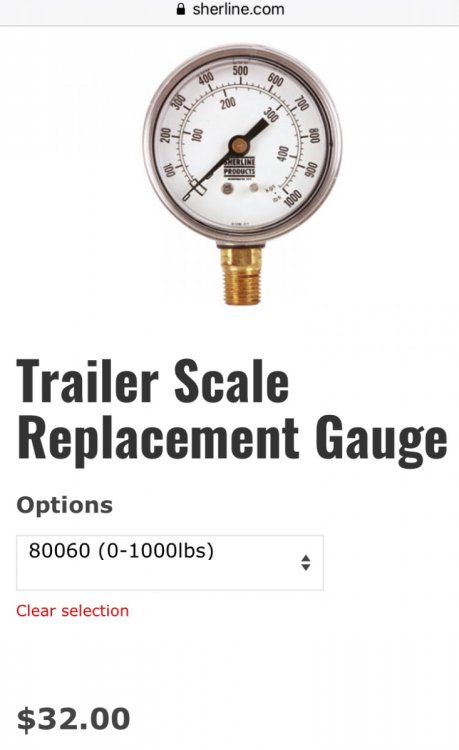

John E Davies Posted February 18, 2021 Posted February 18, 2021 (edited) 8 hours ago, IL_Travelers said: I have been considering the purchase of this hitch with a built-in scale. I have another trailer, and it would be real handy for load balancing my other “toys.” That is a very cool concept, but you need to find out how hard it is to replace (by yourself) that precision mechanical gauge when it fails. They are very fragile devices by their very design, and placing one under a heavy load that bangs and lurches on rough roads is a very questionable engineering choice. However the hitch does have a built in dampener to reduce pressure spikes. Any idea how you would remove that one? (The Sherline has the same oil filled gauge, it can be replaced in a couple of minutes using an open end wrench.) What about the seals in the vertical hydraulic ram? Are they serviceable and can an owner add oil? How long would it take if you had to send it back for service? OTH it is certainly a pretty thing, I will admit that! John Davies Spokane WA Edited February 18, 2021 by John E Davies SOLD 07/23 "Mouse": 2017 Legacy Elite II Two Beds, Hull Number 218, See my HOW TO threads: Tow Vehicle: 2013 Land Cruiser 200, 32” LT tires, airbags, Safari snorkel, Maggiolina Grand Tour 360 Carbon RTT.
IL_Travelers Posted February 18, 2021 Posted February 18, 2021 I agree and thought the same thing. When I researched it through etrailer, I found that the scale portion of the hitch can be replaced for $86 in the event it fails. I may even just buy one as a spare. 2021 Legacy Elite II Twin Beds "R-Villa" ~ Hull #803 2021 GMC Denali HD, 6.6 L Duramax Turbo-Diesel, 10-speed Allison

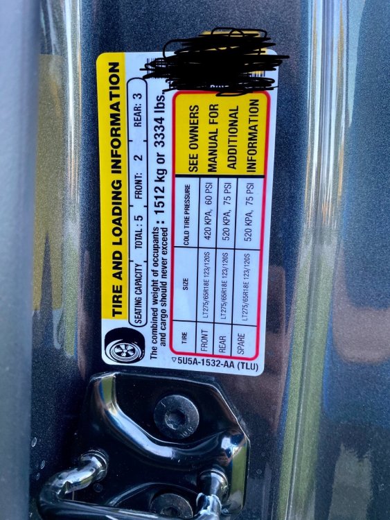

John E Davies Posted February 22, 2021 Posted February 22, 2021 (edited) FYI: https://www.roadandtrack.com/new-cars/road-tests/a10159528/the-mercedes-benz-gls450-is-a-shockingly-capable-tow-vehicle/ I still think the tongue weight will be a worry, but the payload should not, I checked the specs and it appears to be 1745 pounds. Does that match your door sticker? That is pretty impressive. I am actually a little shocked, my 2013 Land Cruiser has a 1295 pound limit, due to the wimpy soft factory suspension. Does your Merc have a stiff ride when it is completely empty? What kind of tires do you have? LTs will make it ride harsher, but will also stabilize it when towing in strenuous conditions. FYI, the tongue weight on my LE2 with the Oliver accessory tray relocated to the back and with 100 pounds of cargo, and full fresh tank and 30 pound propane bottles, is 480 pounds (down from the original 620 pounds). It tows fine.If you can keep your TW light, your Merc should be fine too. https://olivertraveltrailers.com/forums/topic/3263-how-to-move-the-factory-cargo-tray-to-a-rear-rack/ John Davies Spokane WA Edited February 23, 2021 by John E Davies 1 SOLD 07/23 "Mouse": 2017 Legacy Elite II Two Beds, Hull Number 218, See my HOW TO threads: Tow Vehicle: 2013 Land Cruiser 200, 32” LT tires, airbags, Safari snorkel, Maggiolina Grand Tour 360 Carbon RTT.

Pat Maundrell Posted February 23, 2021 Author Posted February 23, 2021 1. The Payload capacity of our GL 450 is 1312 Lbs, minus 600 lbs Tongue Weight, minus 60 lbs Andersen Hitch, Minus 450 lbs occupants = 202 lbs for miscellaneous stuff. I need to go on a Diet. 2. I've always wanted a Tongue Weight Scale so I actually know what the weights are. 3. As a retired Heavy Duty Truck Sales Engineer & Service Manager for 50 years, I can't stress the importance of proper Tongue Weight and Weight Distribution as it relates to the Safe Operation of a Vehicle/Travel Trailer combination!! Your TW should be within 10-15% of the Trailer's Weight! Anything above or below this can induce SWAY or other serious Handling and Mechanical problems! 4. It is my intention to set-up our TV/Trailer Combination by the "Book," while taking accurate measurements along the way to make sure I will be operating within all Specifications and Guidelines of my TV! 5. BTW, I have contacted Andersen Hitch today to ask them about their Weight Distribution Characteristics of their Hitch and they claim as much as 30% weight Transfer to the Front Axle of the Tow Vehicle, that means 180 lbs off the rear of the TV and on the Front Axle of the TV. When I take the actual measurements I hope I find that this is the case. 2
