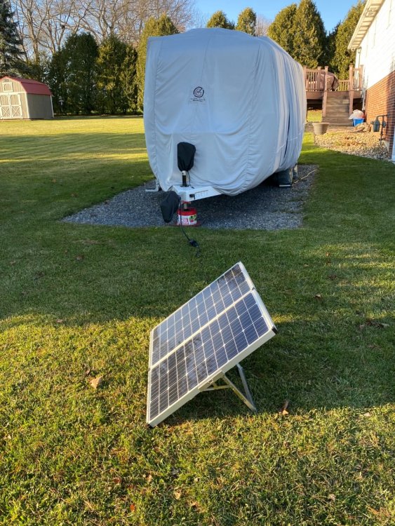

ThomB87 Posted March 5, 2021 Posted March 5, 2021 The propane CO detector and other parasite drains are the issue. You can unhook the batteries but a shut off switch would be better. Still you will be shorting the life of any battery to leave it sitting for long periods. As stated above a small portable solar will keep the batters charged. Unfortunately if solar is not a option in your storage then bring them home. Keep them in the relative warmth of a garage and use trickle chargers. 1 Bill Thomas 2019 Elite II Hull # 534 2020 Chevrolet Silverado HD 2500
