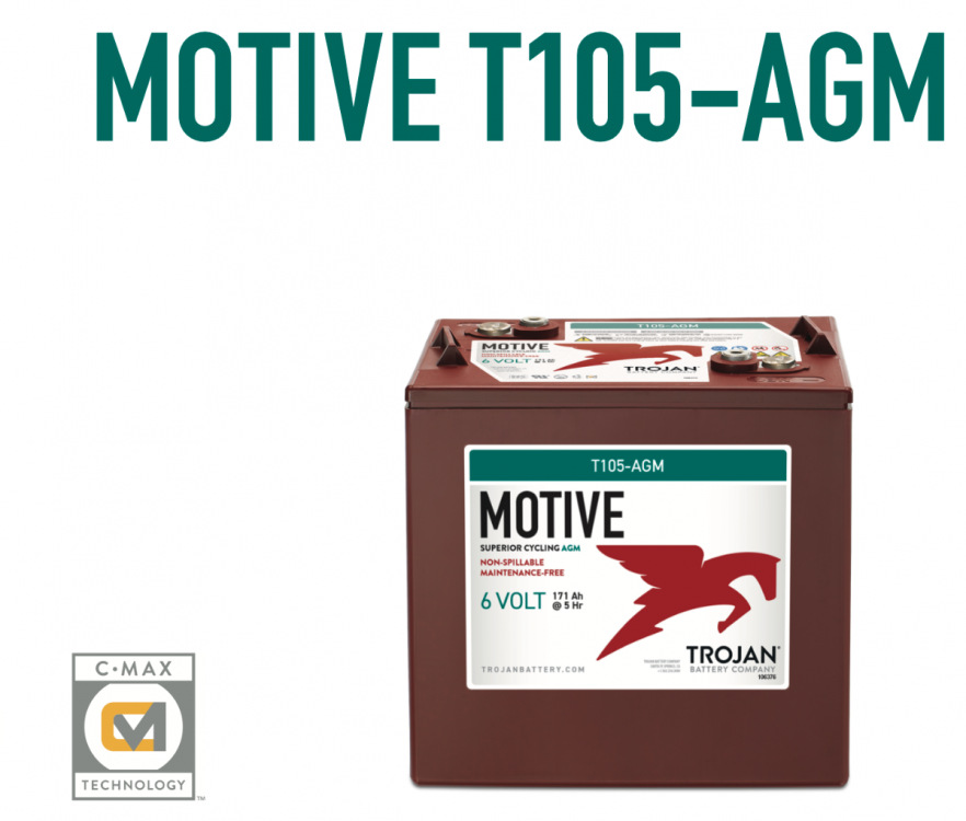

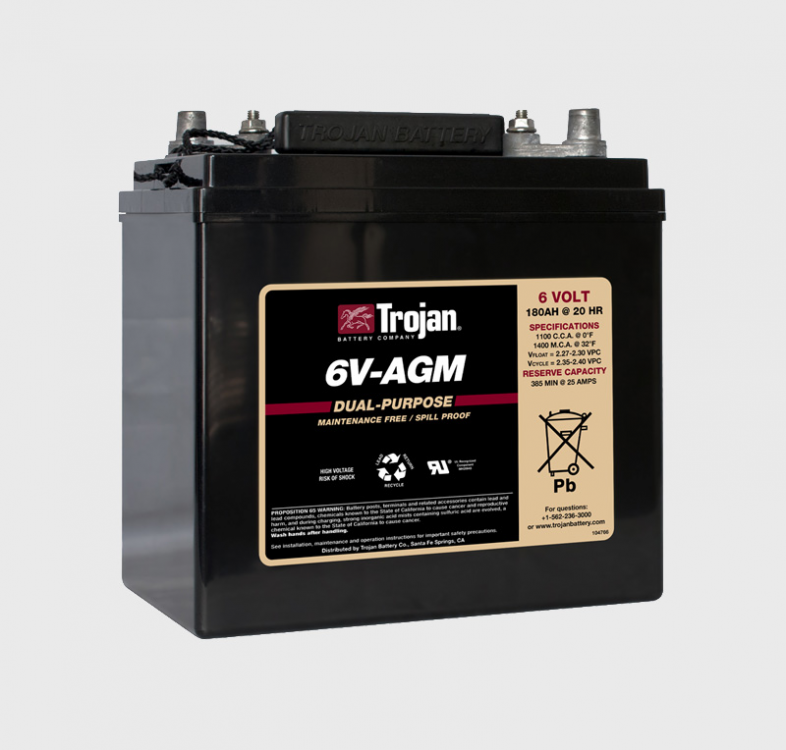

Galway Girl Posted April 5, 2021 Posted April 5, 2021 My 2019 shipped with 4-6v Trojan Black AGMs. They died after only 16 months. I was told on a call to Trojan support that black case AGM Trojans are not true Trojan batteries but an Oem’d brand Trojan Remarkets for cheaper price and only had 1 yr warranty If you want to buy 6v Trojan AGMs, buy the Motive T105-AGM maroon case Trojans which are a longer warranty battery. Craig 2019 Hull 505 2019 Elite II (Hull 505 - Galway Girl - August 7, 2019 Delivery) Tow Vehicle: 2021 F350 King Ranch, FX4, MaxTow Package, 10 Speed, 3.55 Rear Axle Batteries Upgrade: Dual 315GTX Lithionics Lithiums - 630AH Total Inverter/Charger: Xantrex 2000Pro Travel BLOG: https://4-ever-hitched.com Lower 48 + Alaska Achieved in Maine Aug 2024 on way to Nova Scotia.

Galway Girl Posted April 5, 2021 Posted April 5, 2021 Just sharing the specific "Trojan" Battery that shipped with our Oliver and all 4 died within 16 months. They were maintained per the standards set forth for warranty support. Properly charged using the onboard Progressive Dynamics Charger and the Zamp Solar. The Trojan Service contact stated these are made for them by a Chinese Manufacturer as their OEM line. He said they do often have problems with them but as they are only warranted for 12 months...I was not offered any compensation. Finally, the rep told me to buy the "Maroon Case" trojan if I want a good battery as they start with a 2 year warranty. Below is the "preferred" High Quality Motive T105-AGM 6V recommended to me during my support call with Trojan. They have a 2 year warranty but are known for lasting 4+ years when properly maintained. In the end, I bought two of these Napa Branded 12V AGMs to get us buy until we are able to install our Lithium upgrade. My nephew is the West Coast GM and said try East PENN as he's toured many of the battery manufacturer for Napa, and found that East PENN Mfg. (a US Company) has better quality than off shore OEM brands. They came with a 12 month full replacement warranty, and added 3 year prorated. NAPA Commercial AGM Battery BCI No. 31 800 A Glass Mat Part #: BAT 9831DT 105AH (Dual Terminals) Manufacturer : East PENN You can see my progress on the upgrade by following this thread in the Forum: 2019 Elite II (Hull 505 - Galway Girl - August 7, 2019 Delivery) Tow Vehicle: 2021 F350 King Ranch, FX4, MaxTow Package, 10 Speed, 3.55 Rear Axle Batteries Upgrade: Dual 315GTX Lithionics Lithiums - 630AH Total Inverter/Charger: Xantrex 2000Pro Travel BLOG: https://4-ever-hitched.com Lower 48 + Alaska Achieved in Maine Aug 2024 on way to Nova Scotia.

John E Davies Posted April 17, 2021 Posted April 17, 2021 FYI about AGMs vs standard wet (non-sealed) batteries. The only way to know if they are any good is to get them load tested. No other method exists, unlike wet ones with caps, where you can check electrolyte level, condition (clear or cloudy), state of charge and balance. You have to fully charge an AGM, let it sit at least six hours, then check it with a hand hold load tester. Any battery shop should do this free, they hope to sell you more batteries :). My four black Trojans were toast by the beginning of the third season. The guy at Batteries Plus Bulbs that tested them said they normally fail in a couple of years. I personally would never install a maintenance free LA battery in an RV. It is the worst of both worlds IMHO. John Davies Spokane WA 1 SOLD 07/23 "Mouse": 2017 Legacy Elite II Two Beds, Hull Number 218, See my HOW TO threads: Tow Vehicle: 2013 Land Cruiser 200, 32” LT tires, airbags, Safari snorkel, Maggiolina Grand Tour 360 Carbon RTT.
