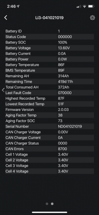

Below is my readout today of battery status at 2:46PM, trailer is in full sun and at our house the outside thermometer is pegged at 100F at the moment.
I note that the Highest Recorded battery TEMP (87) is different from the BMS temperature (89).

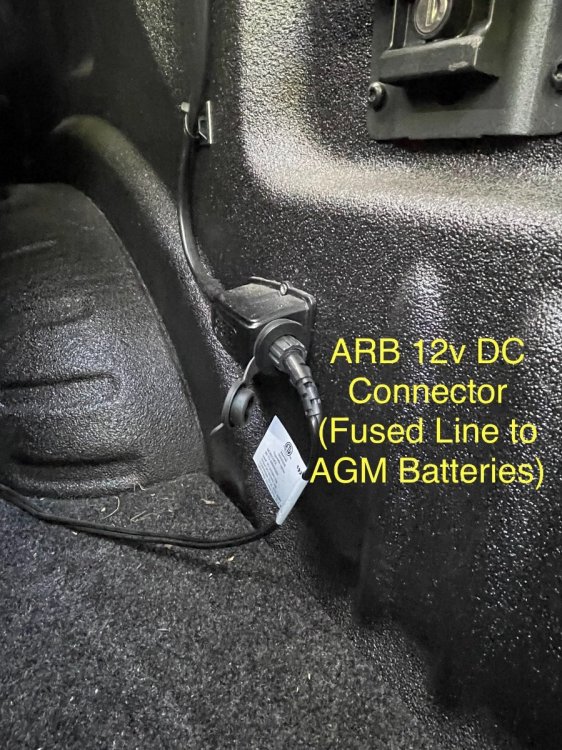

Finally, I when I upgraded to my Lithium batteries I was able to move my dual 12V AGM's into the back of the truck.
I also installed a Redarc DC/DC charger and have found that to be a great addition for running our ARB Fridge which we keep in the truck bed.
