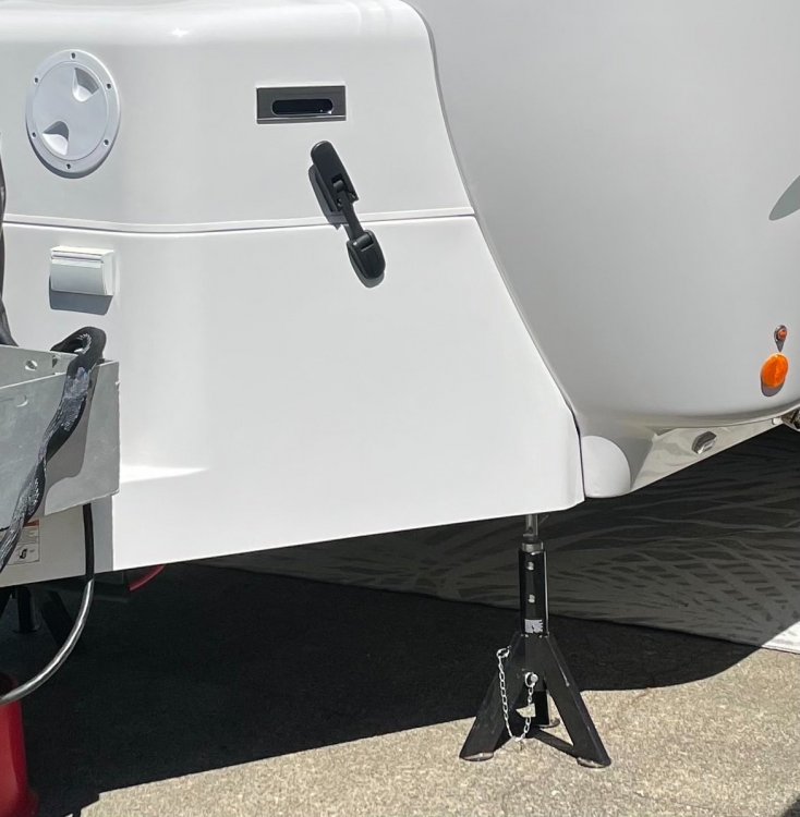

Townesw Posted July 8, 2021 Posted July 8, 2021 I use these if we’re going to be set up for more than a few days. Just snugged up so as to reduce movement not to support the weight of the trailer. 3 Bill and Martha 2018 LEII Hull 313 Original owners 3/14/2018 2019 Chevrolet 2500HD Duramax
Jim_Oker Posted July 8, 2021 Posted July 8, 2021 Good thread - I've been thinking I should try some stabilizers on the front portion of the frame after noticing how much movement up at that end, particularly going up or down the steps, will rock the trailer. So it's helpful to hear from folks who are doing this regularly. Jim and Yanna, Woodinville WA 2004 Ford E250 camper conversion Oliver Elite II hull #709
