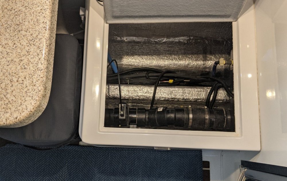

Wayfinder Posted September 29, 2021 Posted September 29, 2021 Has anyone come up with a safe and reasonable solution to use the front-most area under the dinette site, next to bathroom? I'm nervous to put anything in there due to the one inlet line going into the black tank. Also, due to the mild odor in the hull, (not nasty, just different), all I can think of is storing soft, seasonal clothes in two heavy duty outdoor garbage bags, or a vacuum sealed bag. I just don't want anything moving around in there, and should be very soft. I was considering doing a mod of a nice pull-out box or bin of sorts. Maybe a soft cooler, like the one under the table in this picture. Again, I would want to keep that sealed in a heavy plastic bag too. Ideas and threads are welcome. Thanks, Chris Chris 2016 Legacy Elite II o--o Hull #110 o--o Wayfinder o--o Twin Bed o--o 2020 RAM 1500 Limited 5.7L Augusta, Georgia
John E Davies Posted September 29, 2021 Posted September 29, 2021 How lovely for Oliver to just lay wire bundles over the frame right where you need to store items..... This has been working fine for one camping season. You could substitute materials, but the foam board is SUPER light weight, inexpensive, fire retardant, won't absorb water, and is easy to find at any box store. The big problem is what do you do with the unused material...? https://olivertraveltrailers.com/forums/topic/5272-how-to-flat-foam-storage-tray-for-the-front-dinette-seat-compartment/ John Davies Spokane WA 1 SOLD 07/23 "Mouse": 2017 Legacy Elite II Two Beds, Hull Number 218, See my HOW TO threads: Tow Vehicle: 2013 Land Cruiser 200, 32” LT tires, airbags, Safari snorkel, Maggiolina Grand Tour 360 Carbon RTT.

John E Davies Posted September 29, 2021 Posted September 29, 2021 15 minutes ago, Wayfinder said: I may have some fiber board around my GA house. I certainly have plenty of extra Reflectix and 1/8 inch thin plywood. It's free and would make for a nice light-weight platform. Chris Chris, read all of that thread, you need to build up the frame rail at least 2" to clear wires and provide a level platform. That gets it above the height of the big waste water pipe. John Davies Spokane WA 1 SOLD 07/23 "Mouse": 2017 Legacy Elite II Two Beds, Hull Number 218, See my HOW TO threads: Tow Vehicle: 2013 Land Cruiser 200, 32” LT tires, airbags, Safari snorkel, Maggiolina Grand Tour 360 Carbon RTT.

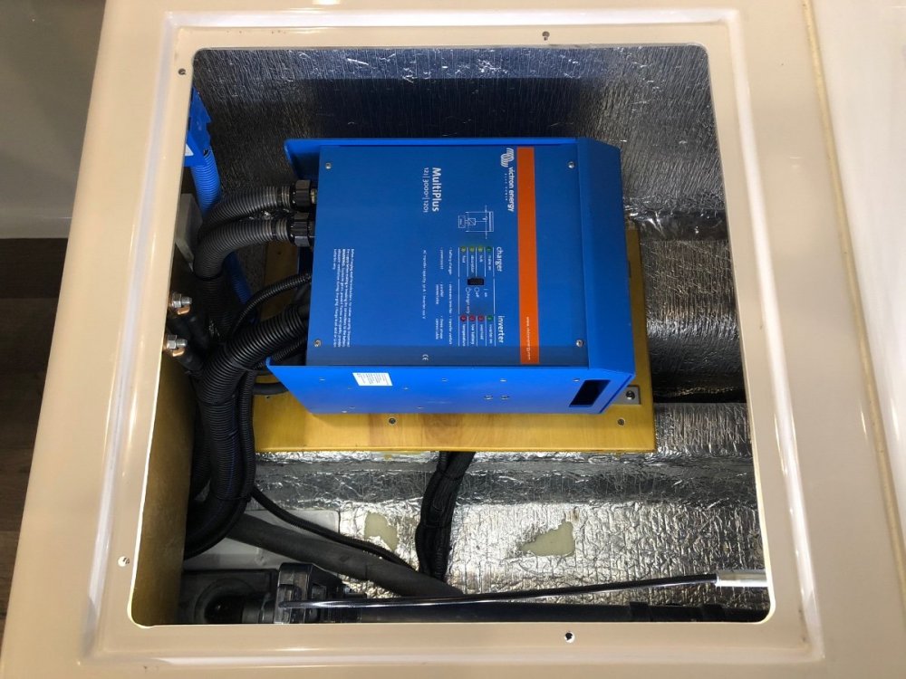

Overland Posted September 29, 2021 Posted September 29, 2021 I keep my inverter in that space, which on its own probably isn't helpful info, but to do so I attached some 1x2 PVC strips crosswise (scraping the insulation away where needed and attaching them to the fiberglass with epoxy), then screwed a removable mounting board onto those strips. The strips provide clearance for the wiring loom(s) that goes over the 'hump' (I'd advise grouping the mess of wires together and wrapping them while you're at it), and with multiple strips you should also get the mounting board over the plumbing (mine was stolen by gypsies so I didn't have to worry about it). That will give you a nice, flat surface for storage, with the plumbing valve being the only thing remaining that could be damaged, but it's pretty tough. Here's what mine looks like, but obviously you could make the board as large as you want - 1

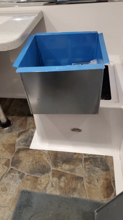

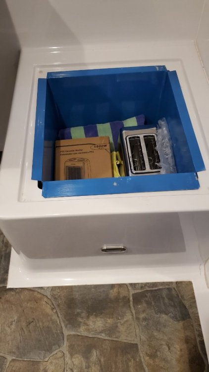

Popular Post 1Lessworker Posted September 29, 2021 Popular Post Posted September 29, 2021 I made a sheet metal box to fit in the space but not hit or rub on any wires or tubing. It is suspended from the flange so it can not drop down. It is easy to remove and reinstall. 17 Sue & Harold Oliver Elite II Twin bed, Hull #508, Ram 2500

1Lessworker Posted October 2, 2021 Posted October 2, 2021 VBristo & Cameron: Most any heating company could make you one. Just have to fit-check it once made to see if it will hit wires or valves & the fiberglass cover will not rock around. Because i worked for a HVACR company and had installed LOTS of furnaces and AC units, I had experience in fabricating sheet metal fittings. Because of the small size 26ga or 24ga metal is fine. 1 1 Sue & Harold Oliver Elite II Twin bed, Hull #508, Ram 2500
