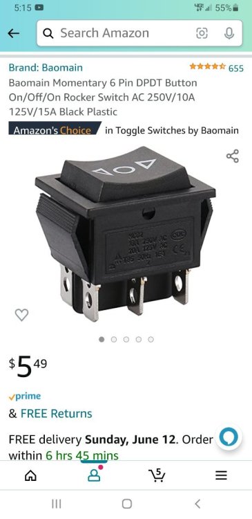

Trainman Posted June 9, 2022 Share Posted June 9, 2022 My 2019 Elite II the switches are on the front of the trailer under the LP cover, my biggest grip is they are upside-down, that is you push the switch on the top to go down and on the bottom to go up. One of these days I'm going to reverse the wires, or the switches, which ever will be the easiest way to do it. I also tighten my jacks till there smug and then bump the switch just a little to give it a stable feeling, no need to jack the wheels off the ground as some think is needed for stability. trainman 2 2019 RAM 1500, 5.7 Hemi, 4X4, Crew Cab, 5'7" bed, Towing Package, 3.92 Gears. Oliver was sold. Link to comment Share on other sites More sharing options...
ScottyGS Posted June 9, 2022 Share Posted June 9, 2022 5 minutes ago, Trainman said: My 2019 Elite II the switches are on the front of the trailer under the LP cover, my biggest grip is they are upside-down, that is you push the switch on the top to go down and on the bottom to go up. One of these days I'm going to reverse the wires, or the switches, which ever will be the easiest way to do it. I also tighten my jacks till there smug and then bump the switch just a little to give it a stable feeling, no need to jack the wheels off the ground as some think is needed for stability. trainman No need to reverse the switches..... Just think differently. When you want the ass end of the trailer to go up.... push the switch UP. When you want the trailer to go down.. push the switch DOWN. Easy peasy. 2 Gregg & Donna Scott and Missy the Westie - The Flying Sea Turtle - Hull # 145 Western NC Link to comment Share on other sites More sharing options...

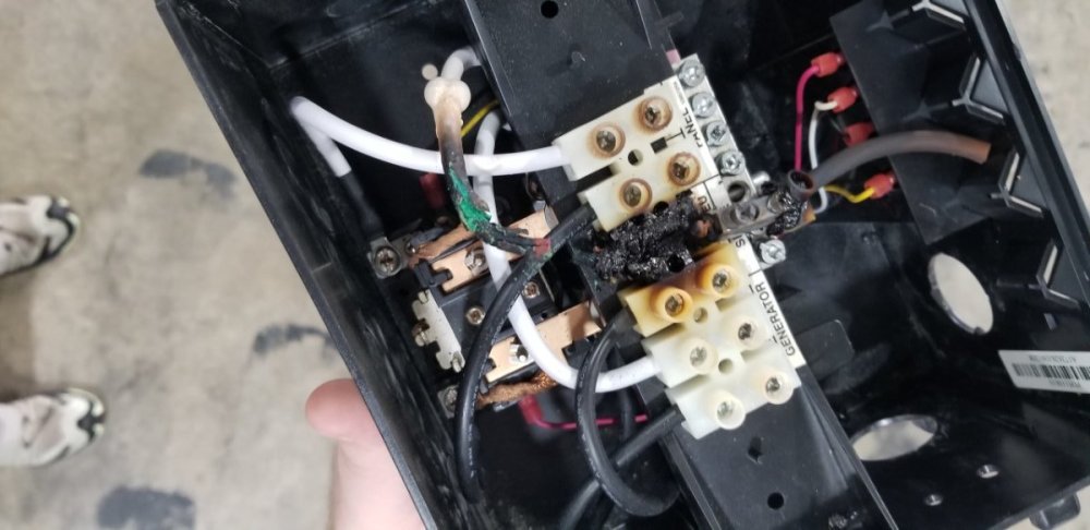

ShallowGal Posted June 16, 2022 Share Posted June 16, 2022 On 6/8/2022 at 10:54 PM, ScubaRx said: There is one item I encourage everyone to check now. IF you trailer has an additional electrical port (for a generator hookup) you will have a transfer switch located underneath the left dinette seat. Unplug the trailer from power, take the top off the transfer switch box and check every screw in the terminal block. If a screw becomes loose, the resistance in that wire goes up and the result will be, at the least, a cooked wire and terminal block. Or it will catch fire a burn the trailer (and possibly any occupants) up. I repaired this problem on a trailer at the rally and it was very nearly at the point of combustion. We concur. 1 3 1 Chris & Duke Chadwell 🐾Maddie & Baxter🐾 Elite II Hull 292 2022 F-250 Lariat 7.3 Godzilla 4x4 Lakeland,FL Link to comment Share on other sites More sharing options...
John E Davies Posted June 16, 2022 Share Posted June 16, 2022 Were there any warning signs like no electrical connection to the gennie, or a nasty burnt plastic smell? That is a scary pic. Does Oliver Service know about this issue? Thanks. John Davies Spokane WA 1 SOLD 07/23 "Mouse": 2017 Legacy Elite II Two Beds, Hull Number 218, See my HOW TO threads: Tow Vehicle: 2013 Land Cruiser 200, 32” LT tires, airbags, Safari snorkel, Maggiolina Grand Tour 360 Carbon RTT. Link to comment Share on other sites More sharing options...
Carl Hansen Posted June 16, 2022 Author Share Posted June 16, 2022 I do have the optional electrical port for a generator. In my 2021 Elite I, I seem to have a different wiring configuration and buss. I do have two boxes under the front dinet, one with the circuit breakers and the other one is for the plugin fuses. I checked all my electrical connections. All of my connections were tight and secure so I think that I am OK. Carl 1 2021 Legacy Elite I | "Lil' Tow" | Hull #924 Tow Vehicle: 2020 Jeep Gladiator Link to comment Share on other sites More sharing options...
