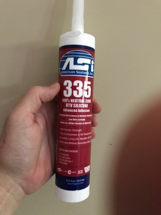

Patriot Posted September 24, 2022 Posted September 24, 2022 I use what Oliver recommends this ASI 335 - and have been happy with it. Do an online search for the best price. I also wax but never use a buffer on decals only a clean Terry cloth. Patriot 🇺🇸 3 2020 OLEII - Hull #634 aka- “XPLOR” TV 2021 F350 6.7 liter Diesel Lariat Ultimate Tremor aka - “Beast of Burden” Retro upgrades - Truma Aventa 13.5 AC, Alcan 5 leaf pack, Alcan HD shackles & HD wet bolts, 5200lb never lube axles. XPEL 10 mil PPF front both front corners, 30 lb LP tanks, Sea Biscuit Front Cargo Storage box. North Carolina

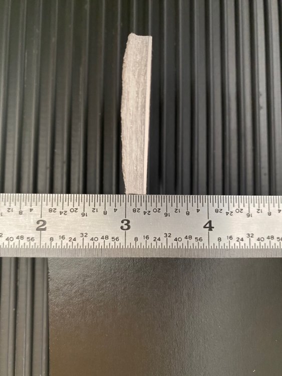

Frank C Posted January 13, 2023 Posted January 13, 2023 Just for reference, here’s the typical Oliver hull fiberglass & gel coat construction. This is from a hole I cut for a modification. The white gel coat layer is about 1/32” thick, MUCH thicker than an automotive clear coat/base coat paint over metal which are typically only a few thousands of an inch thick. So it’s pretty safe to use cutting/buffing compounds and a motorized orbital polisher on the Oliver to buff out any light oxidation without risking going all the way through the gel coat layer. 1 3
