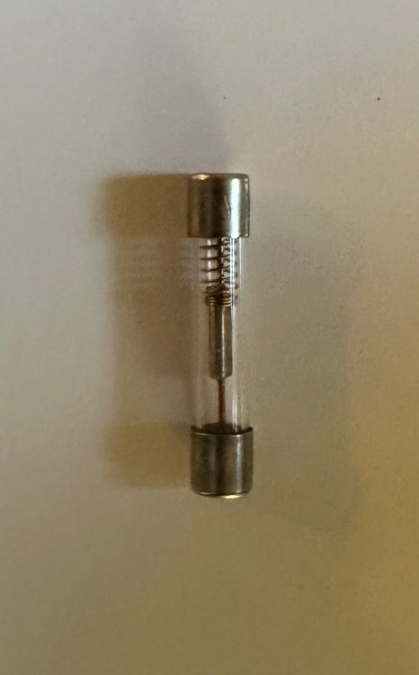

I am a new Oliver owner.  In the replacement fuse box provided at delivery, there is a single AC fuse in the box … all the rest are blade fuses.  I am wanting to get a few extras of this fuse, but am having trouble reading the rating stamped on it.  It looks like 30 amps, 32 volts … so would I be correct in assuming this is a 30 amp/32 volt slow-blow buss fuse?  Thanks in advance for any clarification.

You are correct in that this is a 30 amp slow blow fuse.  It goes into the jack circuits and is common to every Oliver made so far. My advice is to order a few more, you'll eventually need them. These might not look exactly like what you pictured but they are the same and will work just fine. I'd shop around, you'll probably be able to find less expensive ones, possibly at a local auto parts store.
